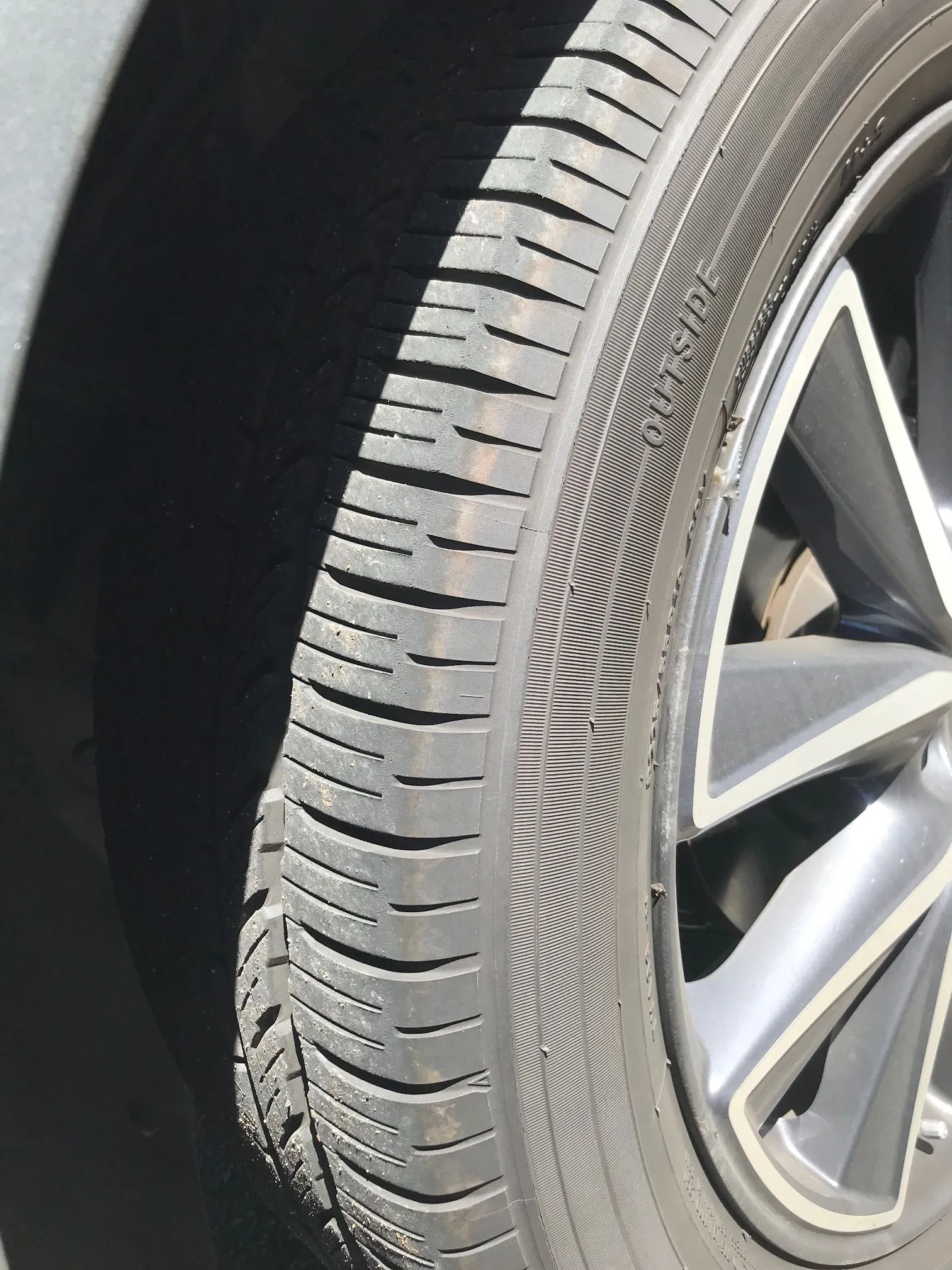

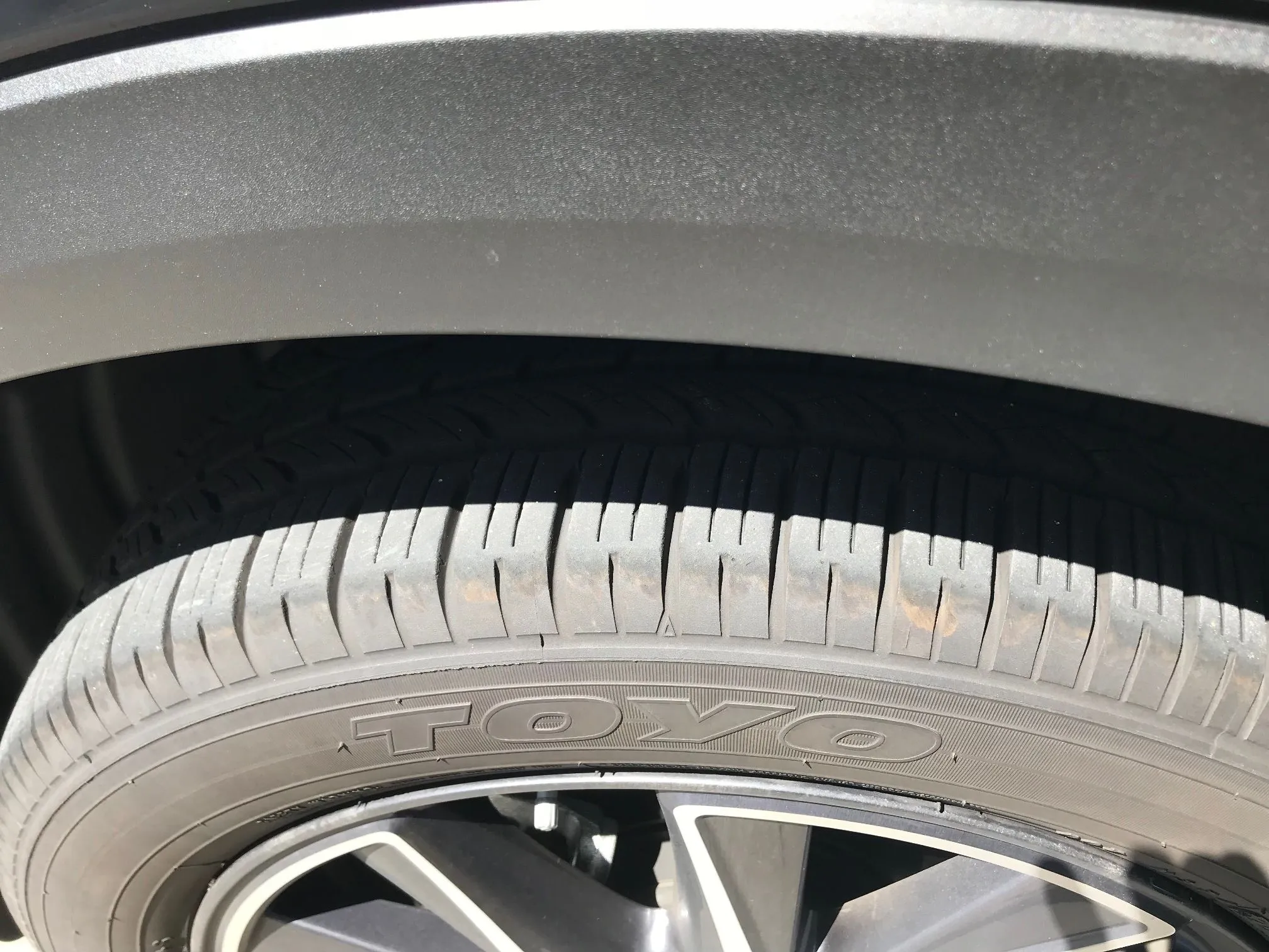

New to this forum. Purchased a brand new 2018 CX-5 back in October 2018. Did a test drive before buying the car, but not on the highway speeds. Started feeling there is something wrong with the car from day two and have been working with Mazda dealerships and Mazda Corporate since then but now it looks like they do not want to take interest. The car shakes side-wise and I have to struggle with the steering wheel to keep it in the lane. There are clear signs of lateral run-out on both front tires but Mazda says that is normal. I do hear the grinding noise coming from the tires at highway speeds, like the car is constantly skidding side to side. My steering wheel started wobbling in May 2019. I have taken to three different Mazda dealerships. First one, who sold me the car, said they re-balanced the tires and alignment was with-in the specs. Second dealership said they are unable to identify the problem. By third dealership visit, the car developed steering wobble. They did a road force balance, that fixed the steering wobble only for a couple of day. It did not address the original vibration and side-to-side shake problem. The steering wobble came back after couple of days. The car feels very unsafe to drive at highway speeds. I proposed Mazda swap all for wheels with a new car, but they have been reluctant in trying things out. They have done nothing other than re-balance and road-force-balance.
Here are the couple of images of front driver-side and passenger-side tires. I am wondering any of you also had the same issue with your front tires.

Can you post a video of the shaking and skidding?

Whoa! That does not look good....I sure wouldn't feel safe driving it at all!
I don't know if it's a distorted pic or an optical illusion, but that pic of the left side looks like the tire is seriously deformed.

There're several threads discussing similar vibration issue on the highway speed from gen-2 CX-5. Yours seems very severe, and I don't know why your Mazda dealer and Mazda North American Operations are not willing to resolve the issue for you. One member claimed his problem is mostly resolved by using only Michelin Premier LTX tires after many tries with different ways. If I were you, I'd escalate the issue with higher management person in MNAO, and file a complaint to BBB and NHTSA for safety concern.

I am in the process of creating a video using three triple suction mounts to record left and right tires/wheels and windshield view (by mounting the suction mount on the moon-roof upside down) all together using three cameras and post on YouTube. I have already tried recording driver side front wheel/tire and I am able to see the run-out. I will post the video/s pretty soon.
I have checked the left tire for radial run-out. I mounted it on spare tire jack and placed a small camera tripod underneath it and used it rotating arm as a pointer so that it just touched the tire. Then I rotated the tire by hand and I saw there was a spot on the tire where there was about 2-3 mm gap between the tire and the pointer. I repeated the process throughout the width of the tire and this gap is more prevalent on the outer width where the wear due to later run-out is visible.
