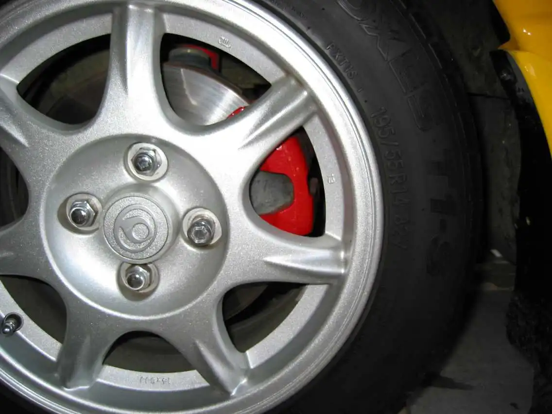

22 post before anyone noticed......... lol I used the same duplicolor pain on my SVO brakes. Lokos good, but it seems to chip easy.

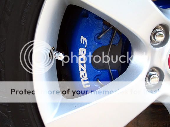

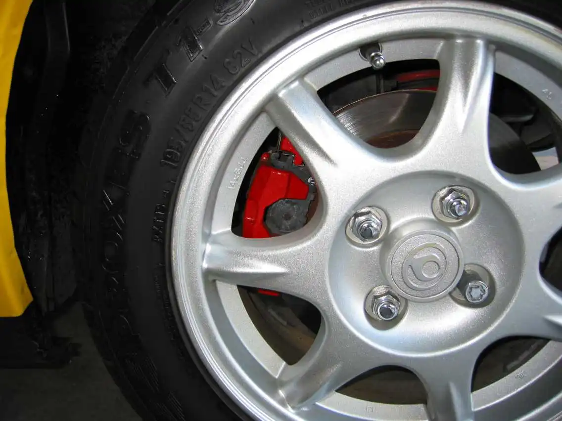

Here are mine. It's hard to see here, but I did my rotor hats a while ago too. Even thought of doing the rotor edges, but then that to be a prime place for chipping.

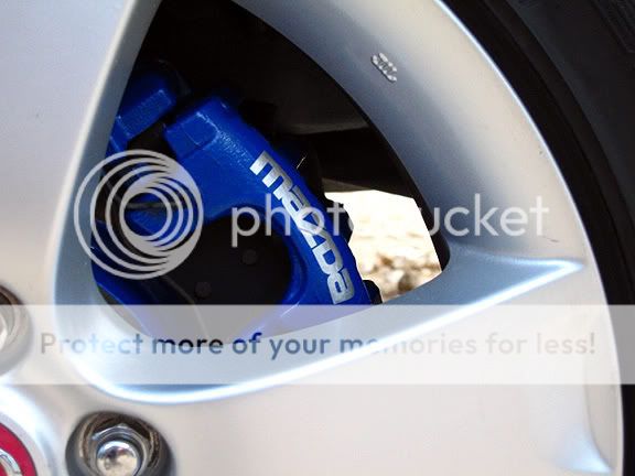

I saw that you had ordered your decals from Xenonmod and thought you might like to see what they look like on... or at least one way to install them. These are the aluminum/silver ones of course.

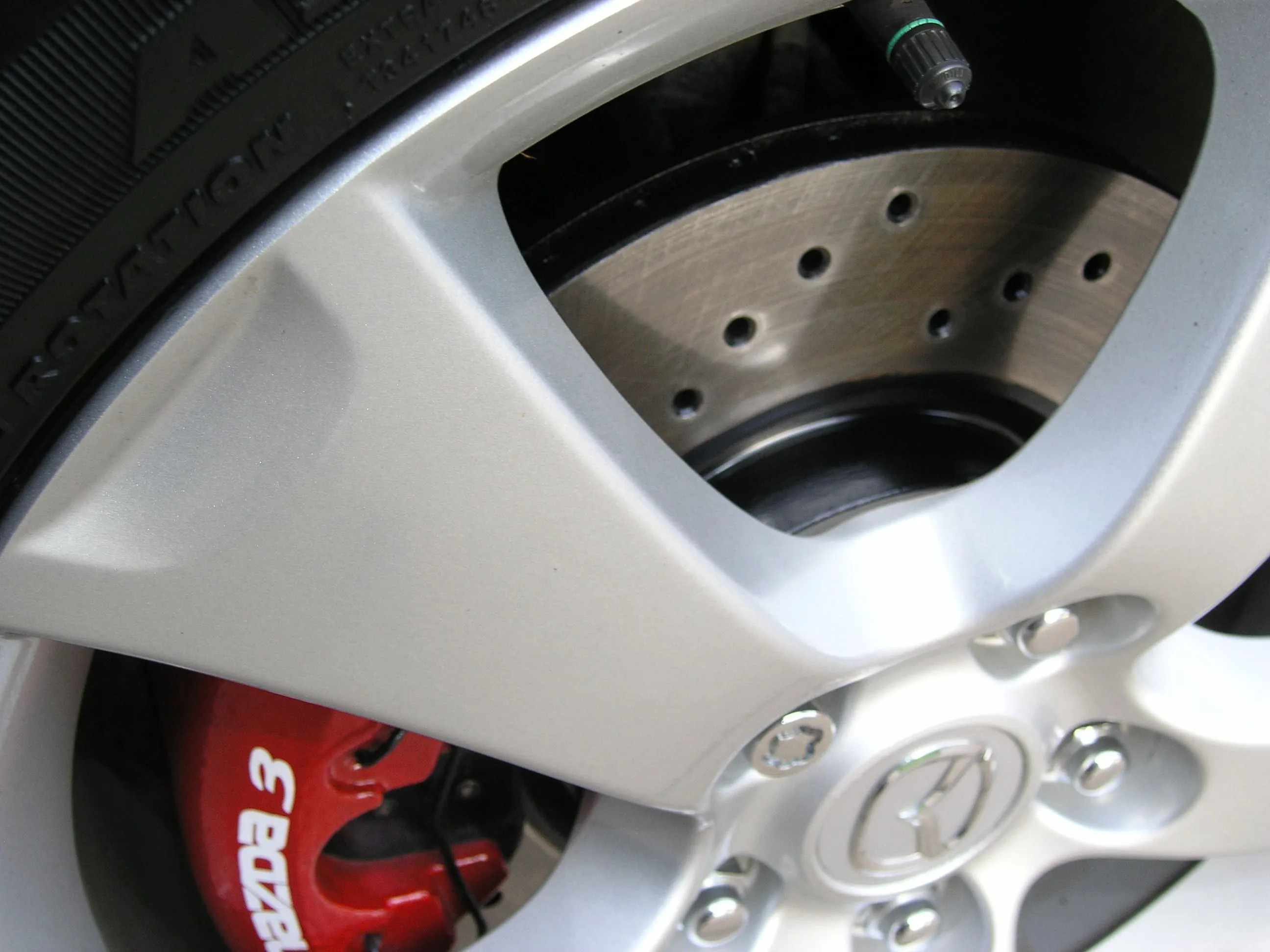

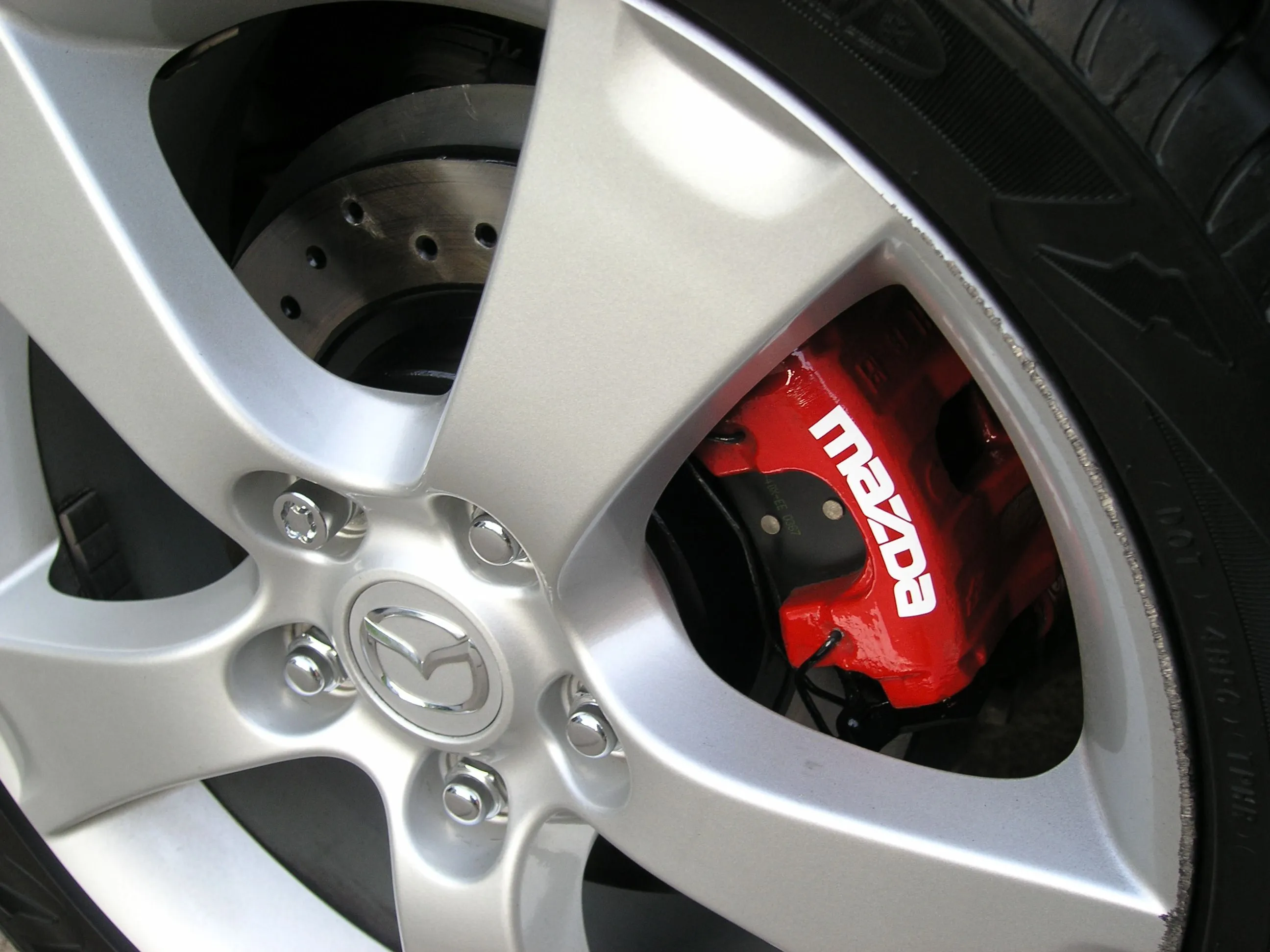

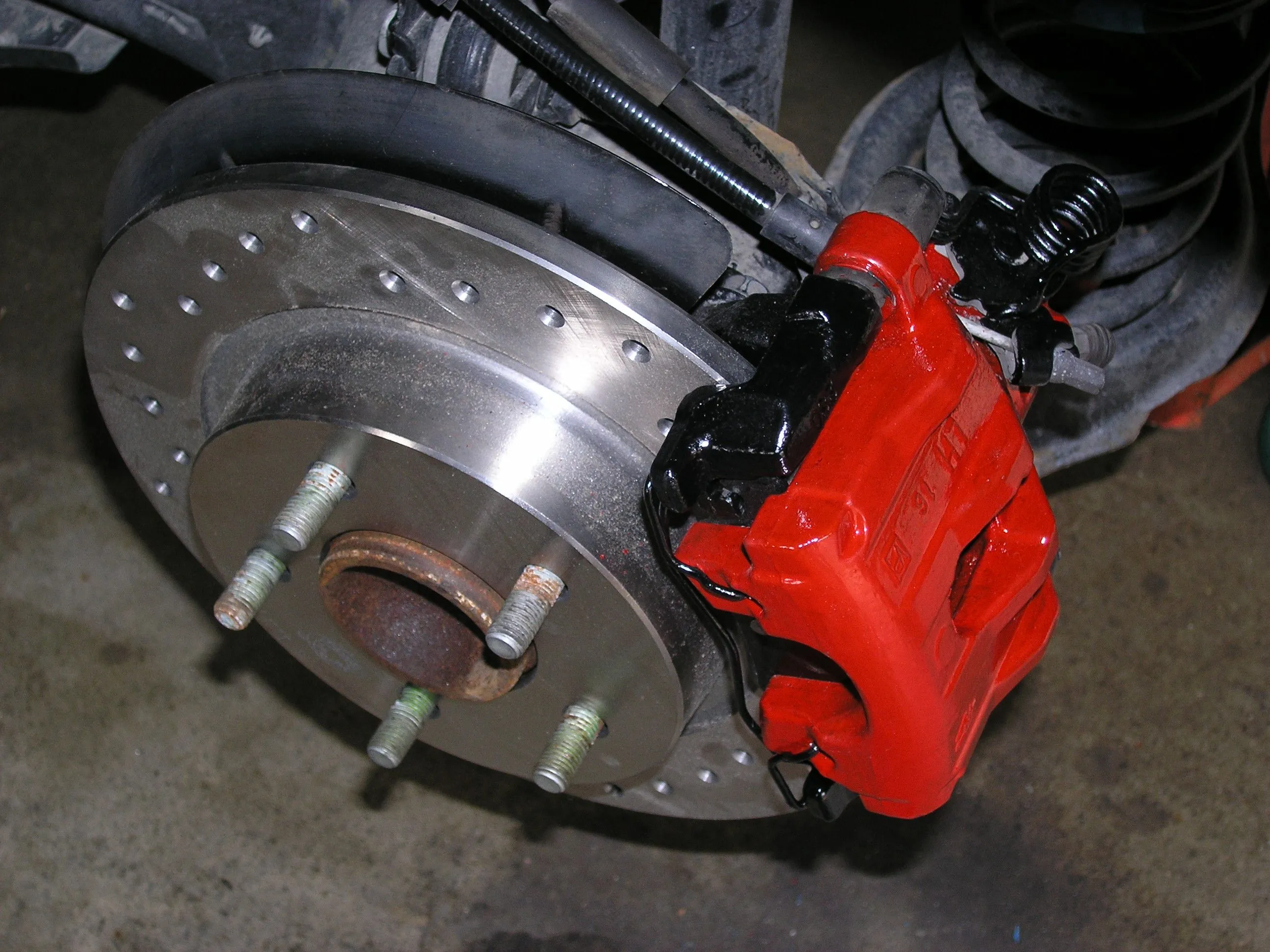

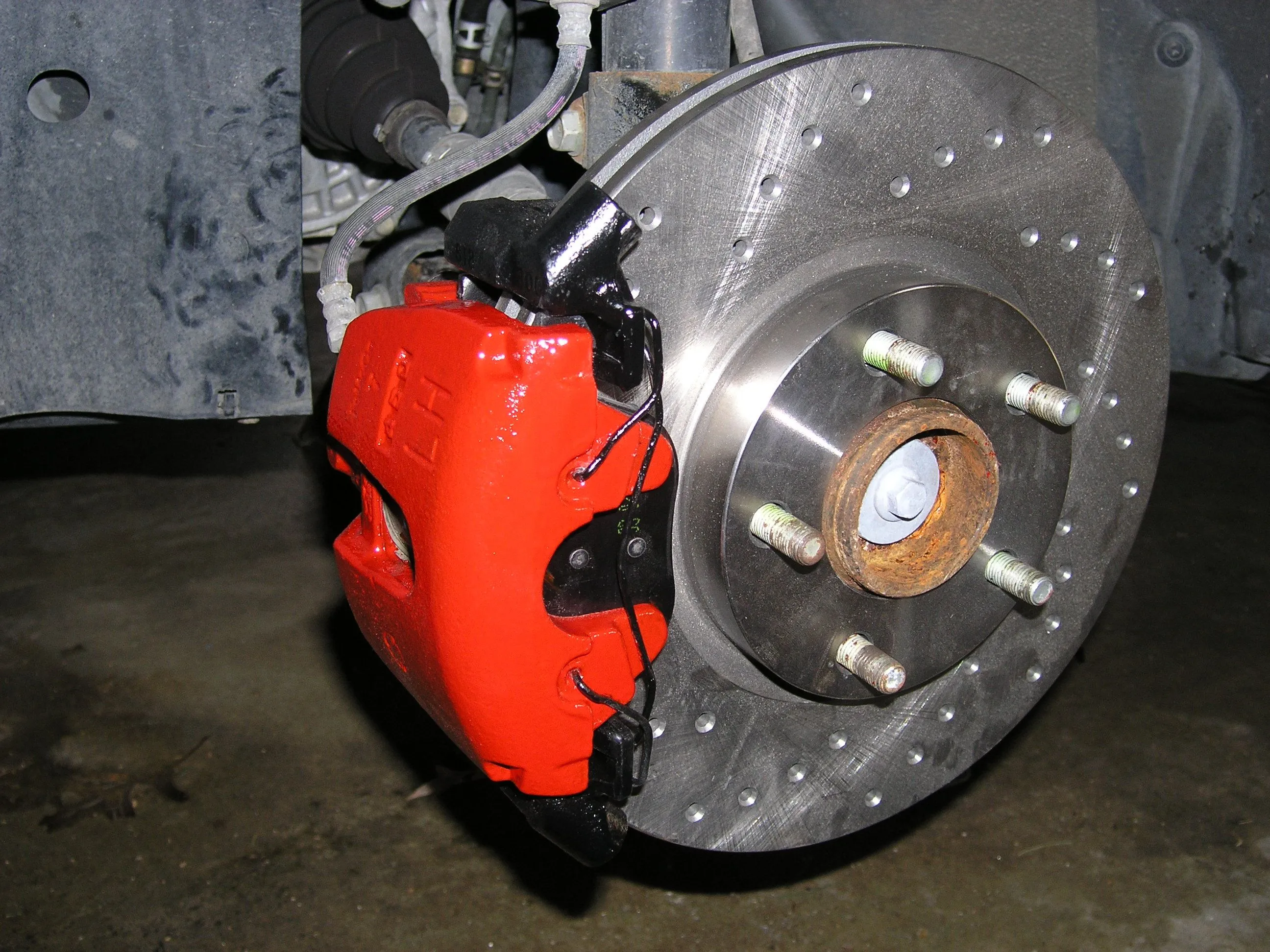

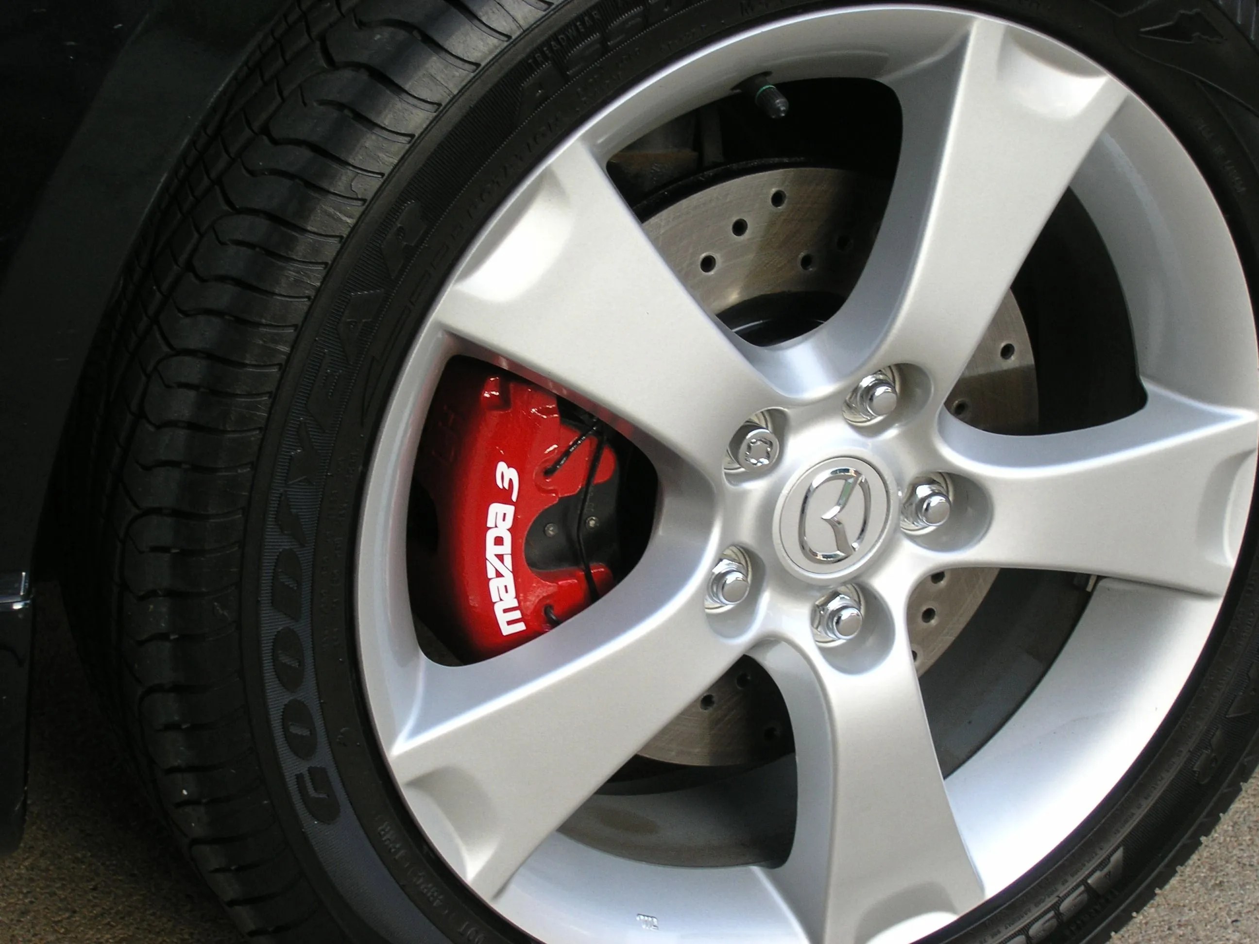

Calipers AND rotors finally DONE!!
FINALLY, I'm finished with my calipers and rotors. This last weekend I put the 3 up on jackstands, took the wheels off, and SIX hours later was finished!
The calipers still looked good from their original painting. I only had one chip on the edge of the left rear and I think I caused it when I put the wheel back on after the original painting. I touched that up and cleaned up the rest (just a little dirty from the rain, etc.).
The main problem was the rotors. Once it rained on them, anything that wasn't a braking surface turned a light orange--including every single beveled hole in the cross-drilled rotors. UGH!!
I bought a fine wire wheel brush for my cordless drill and used that on the rotor hats and outer edges. I was suprised how well it worked! Then again, there was only a light coat of rust on them. I had another wire brush attachment that I was able to use to get the rust off the beveled, drilled holes.
After cleaning away the rust/dust, I got out the left over black caliper paint from my mounting brackets, and painted all the entire rotor hats up to the edge of where the pads rub on the braking surface. I then painted the outside edges of all the rotors and got down in the front vents. If anyone wants to do this, I'd save the vents to last--It screws up your brush a bit!
After I finished with the hats and the edges, I painted every single beveled hole by using a plastic detail/touch-up "q-tip" brush that can be bought in packs from any automotive paint shop. I think the brand name was Pro-Touch or something like that. It worked great! Just really, really time consuming!
I let everything dry overnight and added the decals the next day. Thanks for the advice bbrich57, I just don't have your willpower! I think the calipers will hold up nicely. We'll see... The decals were REALLY easy to apply and I think, look great! That's
http://www.xenonmods.com/newallcaliperdecals.htm
if anybody's interested.

So far, after over 300 miles of driving, the edges look perfect. No chips, cracks--nothing! Maybe too early to tell... If anyone does get those rotors, make sure you paint them or get them zinc-coated before you put them on! It should be much easier to do when they're off the car.
My wife was out of town when I did this project and had the digital camera with her so I don't have any pics without the wheels on like I had before. Wish I did, because they looked sweet! I did take some when she got back and they're posted below. Thanks for everyone's opinions and advice while I was undertaking this project. It was much appreciated!!
