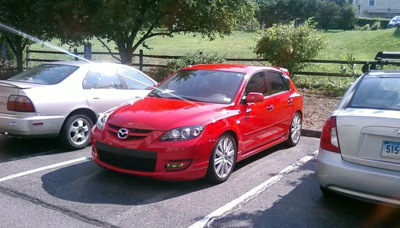

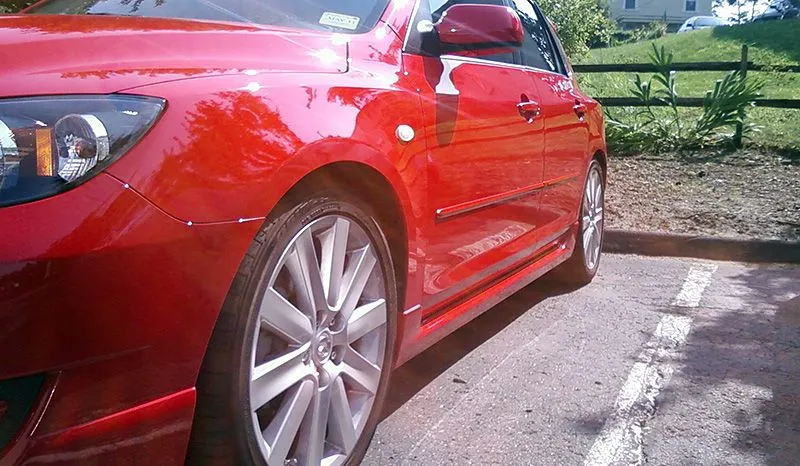

installed the eibachs plus mazdaspeed rear camber links.
the drop is subtle and very nice.
ride is not much different from stock. will most likely go with yellows or FSDs in the future. but first - sway bars, not sure which yet.

I've had both the Cobb's and H&R's. I can tell you H&R's are nothing like stock, and are not comfortable. That beings said, I love them and wouldn't trade them for the world. They are nice and low and tight, and feel great for me. When I was running the Cobb's I was fairly happy with them, but looking back I think I should have been less happy. They drop it around 1" and felt quite a bit like stock, but they did float.
I'm at 35000 KM's with stock struts running lowering springs the whole time I've owned the car pretty much, and my struts are fine.
how much different is the drop with cobb vs h@r?
