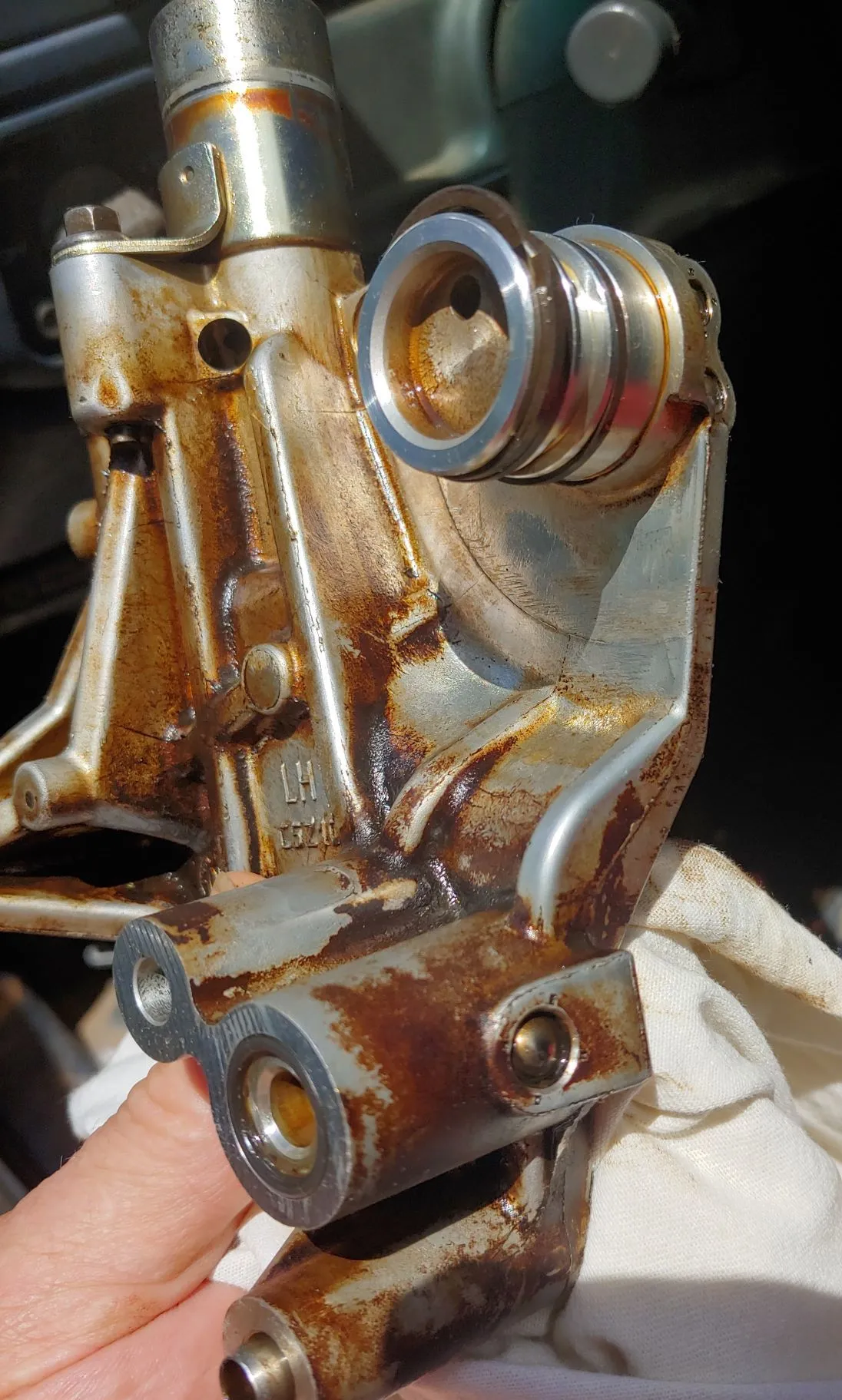

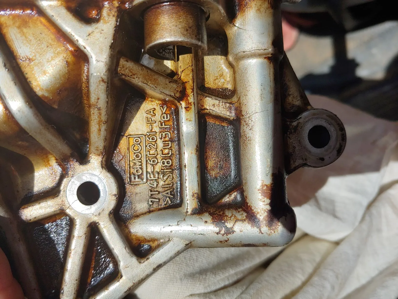

Hi all, I've had the dreaded water pump failure on my 2010 Mazda CX-9 3.7. I'm doing fine with getting the work done, I'm at a loss though on finding seals for the Solenoid Valve Body. It's the part that fits into the end of the cam phaser and holds the VVT solenoid. Where it fits into the phaser, there are three "o-rings", they actually look more piston ring shaped then o-ring, and there is an actual o-ring that seals the oil gallery, against the block. I have looked at every schematic I can find online, and I can't find anything. If I search the part number, off of one of the bodies, 7T4E-6C261-FA all I come up with is people selling used ones. I'll attach a couple of pics for reference. Any help would be greatly appreciated.
