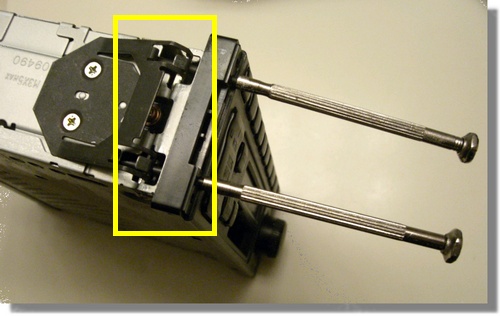

the tabs are nearly identical to the ones in the picture.
Just push them towards the center and slide the radio out.
ignore the screwdrivers, pressing them in through the glovebox is 5x easier.
I will try again tomorow, if not I am going to push it through the glovebox..btw the radio in the pic above is different to mine, my radio is a double din I hope it still work.
