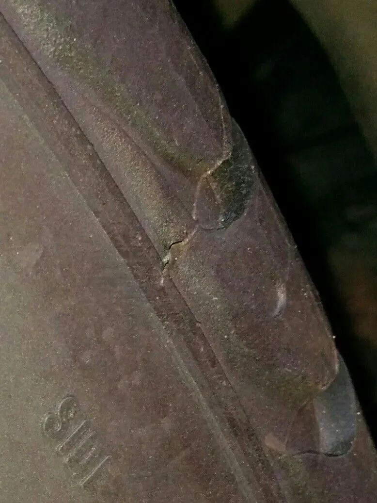

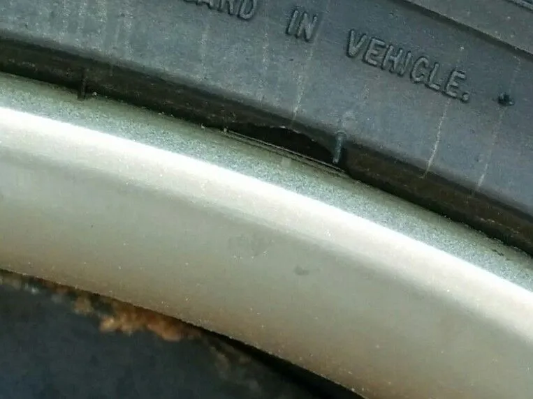

Can you give me your thoughts on these 2 pictures? These are tires that are on a "new to me" car that I am supposed to pick up tomorrow. I was looking to get pics of the DOT numbers but when I did, I saw this.
I'm assuming both are safety issues. The crazy thing is, these Goodyear's are this year ...dot is 0616.
I see a crack in the first pic and the second it looks like there is a chunk missing altogether from the tire where it meets the rim.
Thanks so much guys. Your help is greatly appreciated

First pic looks like a minor rock mark, the second pic looks like the bead sticker was not peeled away in that spot. I would not worry about either

I'll admit that I'm not the most knowledgeable person when it comes to cars, but to me, that first pic looks like a crack. That can't be good. My 6 year old tires don't have any of those.
For the second, that looks like a hole. I can see more of the rim. Again, not to argue, but how can that be a sticker?

No worries! The first pic is like the side wall tread edge ran over very sharp rock, maybe metal? > On the second pic, imagine a very thin piece of saran wrap... :) It is just glossy, not a missing chunk... Before it and after it you can see the torn away jagged remnants between bead and wheel.
OK...I feel stupid about the 2nd pic of that only a sticker. It totally looks like a hole where you can see more of the rim haha. I'll concede that that one isn't a problem
However, the first one is real damage. I'm assuming the chances of that getting wide is now much higher. I was always told that if the crack or break or puncture is in the sidewall, it's toast.
Isn't that the situation here?

Would love to see in person, but from that angle and pic it looks very minor shallow. Definitely point it out to the seller and try to use as a concession, however that really looks to be in the top 10% of the surface of the tread.

If it's not leaking, I really wouldn't worry about it. Provided that they don't shake going down the road.
The bead would probably never seal if that was really a hole.

Any chance that can be patched that close to the sidewall?
If it starts leaking, it's not repairable. A plug might hold for a while.
I'm sure that car has a TPMS, so you will know pretty quickly if it decides to let loose.

Looking at the pic again, I think what you are seeing is the shadow from the rubber FLASHING from when the tire is made... little thin piece of excess rubber...
Notice how that line continues horizontally across the tread of the tire?
You're fine. If there was any damage to the structure of the tire, it would start to bulge. Just watch for leaks and bulging in that area.

You win. 100% right. I went over those tires for 20 minutes.. Couldn't find a thing wrong lol.
