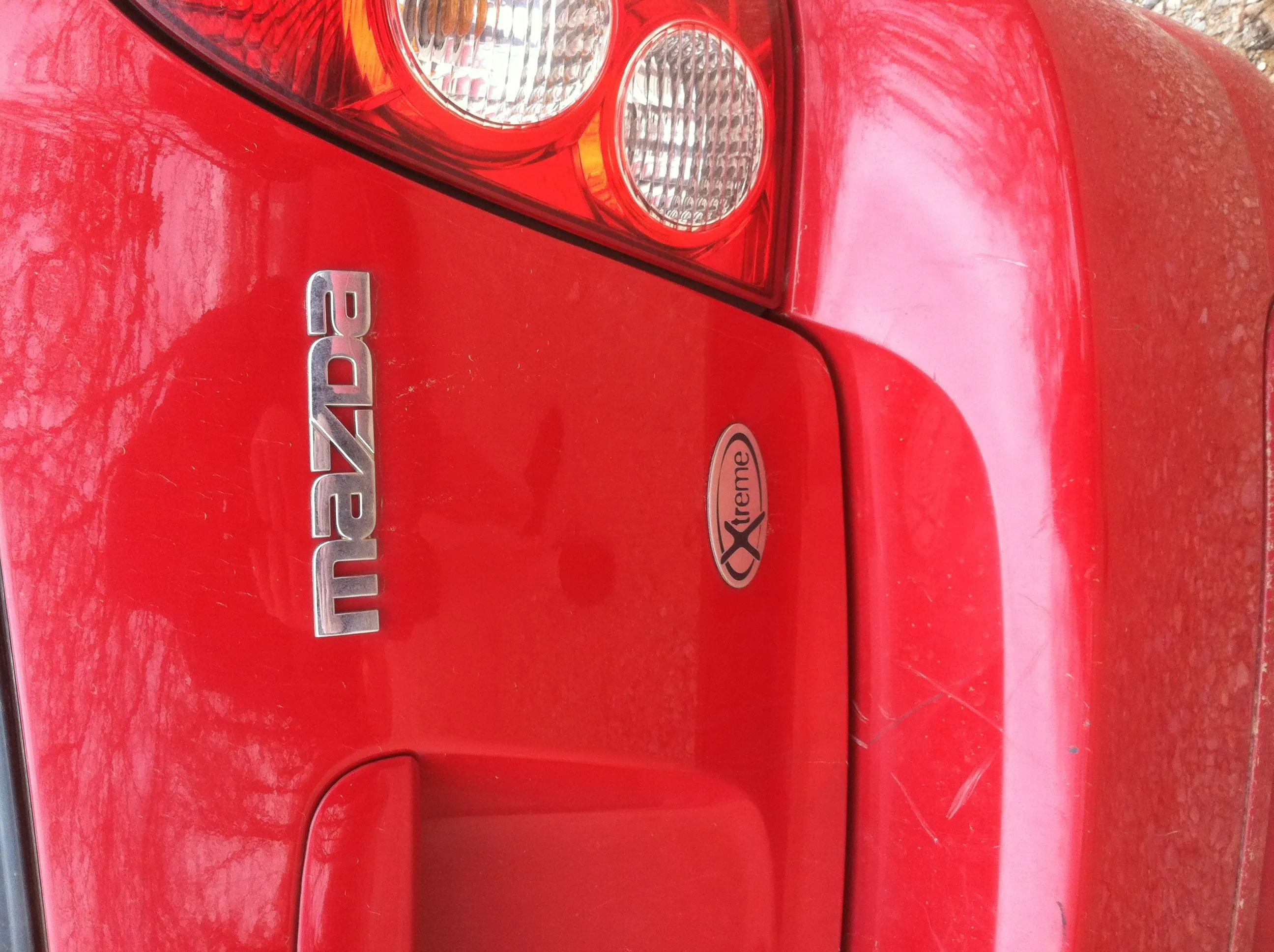

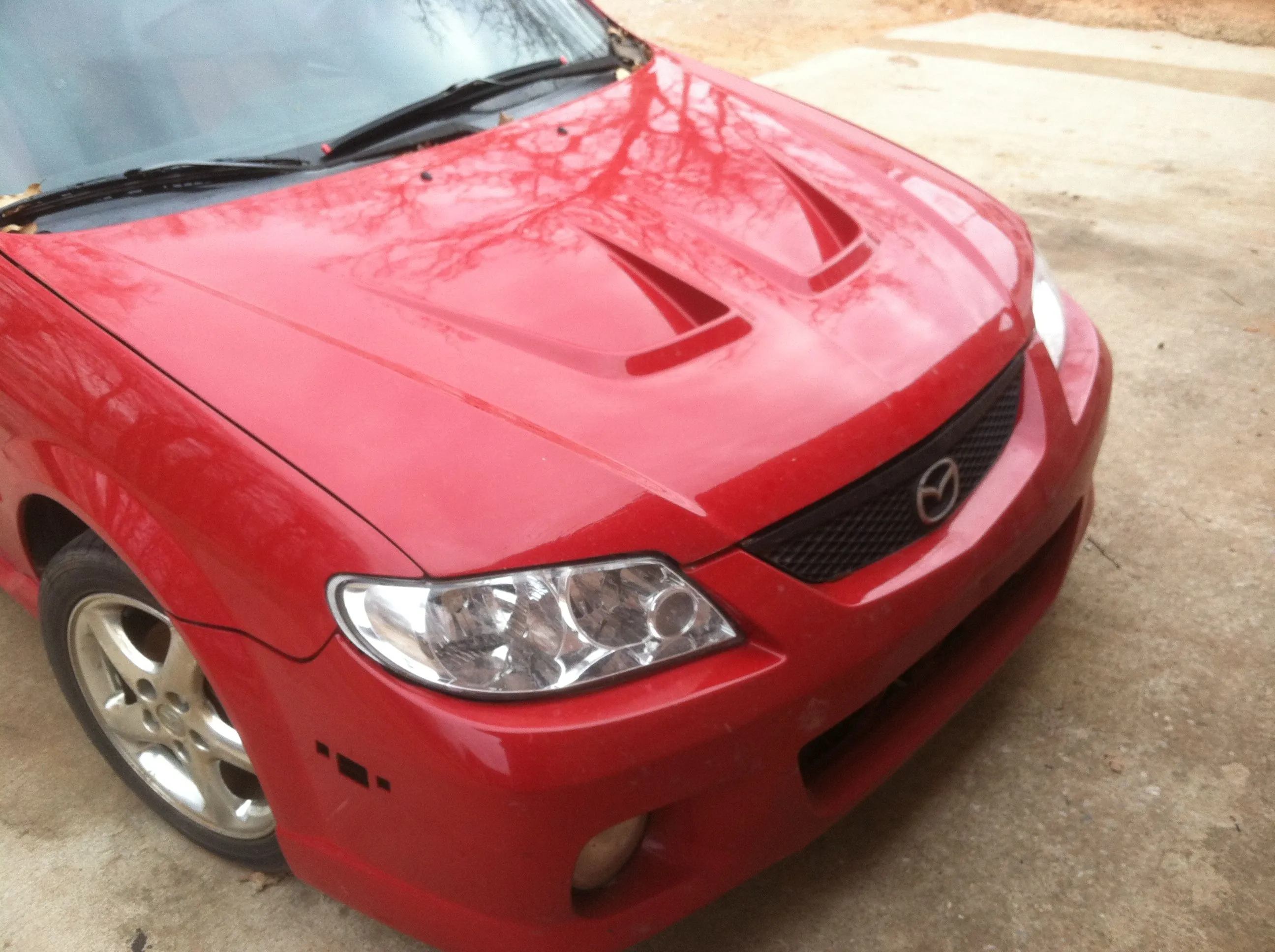

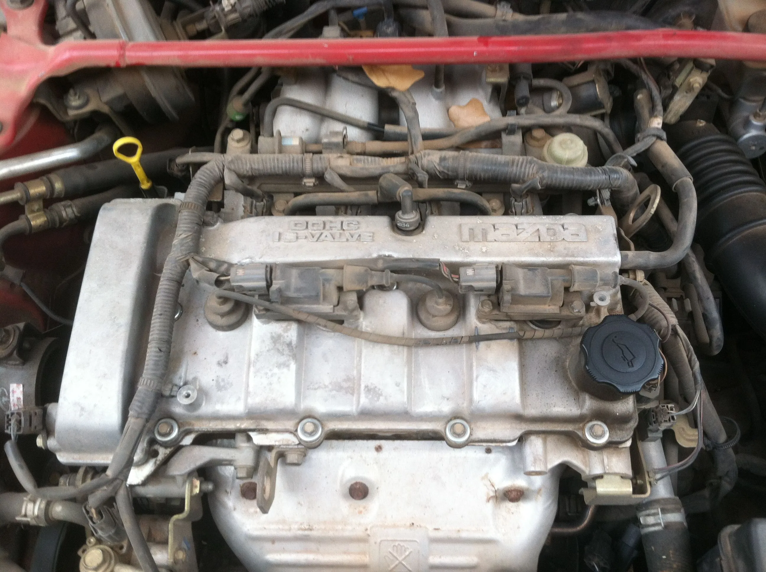

My friend has a 2002 Mazda Protege5, last year the engine started knocking really bad and white smoke comes out the back end now....wellp it was suggested to me that i need to look for a new engine. i go to research what engine came stock and according to the internets, it is the 2.0 FS motor, which is a 14 valve DOCH...cool. Well, the motor inside the car is a 16 valve DOHC, which according to the internets is the FE-DOHC or at least thats the only mazda motor i can find that is a 16 valve. Now my friend keeps saying that when they bought it the guy told him "its some special limited model" which i cant find anything about, im going to attach a few photos so you guys can visually see what i am talking about. the only thing i know is there is something on the back that says xtreme and the hood has some like scoop/air induction things haha, i dont know if this is just some cosmetic kit or not.
anyways, i dont know if the current motor can be fixed...so i am planning on buying a new one and having it installed, the only issue being...i dont know what motor i am going to need. i wanna keep it oem, im not going to mod the car or do anything other then make it reliable so i can make it through school and beyond

the FSDE 2.0 is a 16 valve not 14 valve, and unless your in another country, its the only motor that comes in a P5, you may have misread your info, as far as "special limited model" all i see is a sticker and an aftermarket hood
http://en.wikipedia.org/wiki/Mazda_Familia unfortunately this is all i have been able to find, granted only like 80% of wikipedia is reliable, that is what it says. and i figured the sticker and stuff was all cosmetic, but if youre sure then awesome, it eliminates all my worries haha
also, any good/reccomended websites to order engines from?
Fresco is right. The only special edition Protege5 that exists is called a Sport2.0 which you won't find the the US unless they were imported. They have a High compression 2.0L motor that makes 170hp instead of the FSDE's 130hp. The Sport2.0 has a different bumpers, skirts, and decals all over. The protege5 pictured above has an aftermarket hood and some random xtreme sticker. As far as the 14-valve. That's a typo. That would mean 3.5 valves per cylinder instead of the 4 valves per cylinder with the 16-valve engine.

i dunno if a seafoam treatment will work. i was told to take the valve cover off to make sure things werent loose. i mean its knocking pretty dang loud, it sounds like a rod is busted...but when i check the oil level its full?? i dunno, if i can fix it myself i would do it, but i dont know whats wrong with it 100%
is there a name anywhere on that hood? i really like the look of it and would like to try and find one. Are the scoops functional or have a pop out to make them functional or completely cosmetic?

As far as the hood goes, I'm not sure who the manufacturer is, I just know BrianMP5 has that hood on his P5. The scoops aren't just visual, they have grills and will allow airflow directly below their opening. I doubt you can find that hood easily. The majority of hoods for the P5 have gone extinct except for the carbon fiber and evo style
I would recomend that if it needs a new motor, to simply replace it with excactly the same motor that it has, They are very common and that would reduce any wiring problems.
+1
any mazda FS-DE 2.0 will work
+1
+1
and will be much easier to find an FS-DE 2.0.
Make sure you get a 2.0 and not the Canadian 1.6L I believe. I had to sort through all the 1.6L transmissions and find the right 2.0L transmission when I replaced mine
