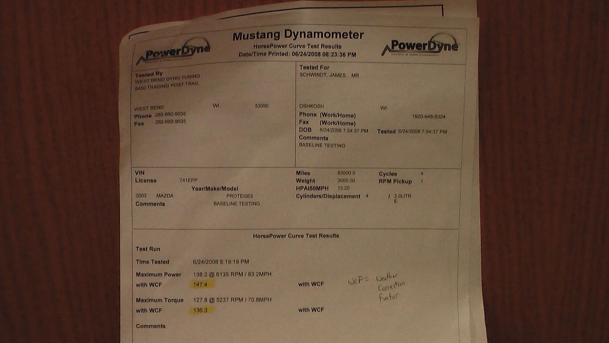

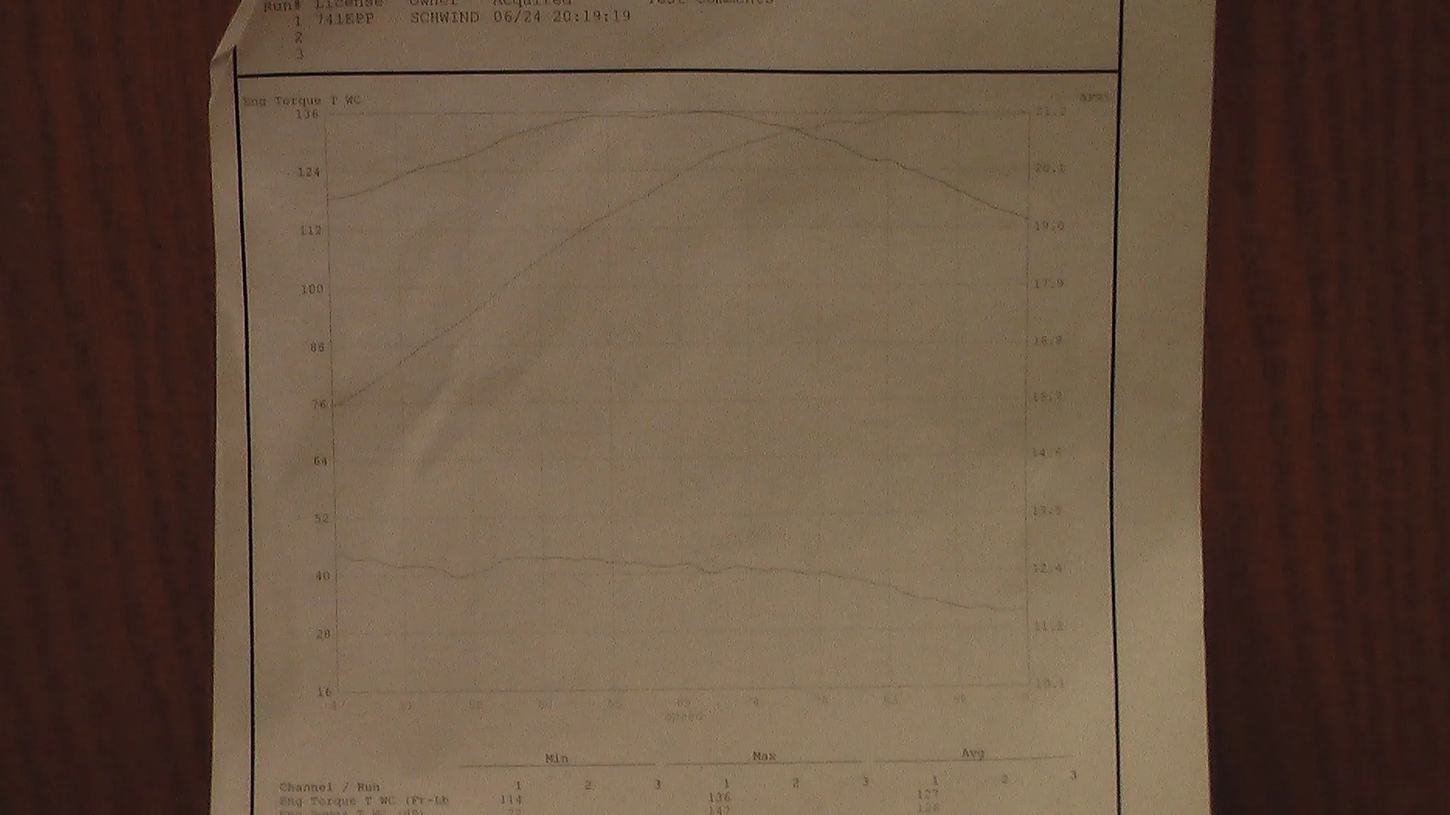

Dyno sheets!
147.4 WHP @ 6135rpm
136.3 TQ @ 5237rpm
Twigs
SRI
MT EMS
PnP head
Coated 10:1 pistons
Over sized valves
Titanium retainers
stiffer valve springs
626 manifold
Thunder headers
MAM midpipewith highflow cat
Racing beat Catback
9lb flywheel
welded MSP differential
spec stage two clutch
innovate LC-1
I think thats all he has
Best part about it, that all below stock Red line. And from was he what saying there is no loss in the bottom end.

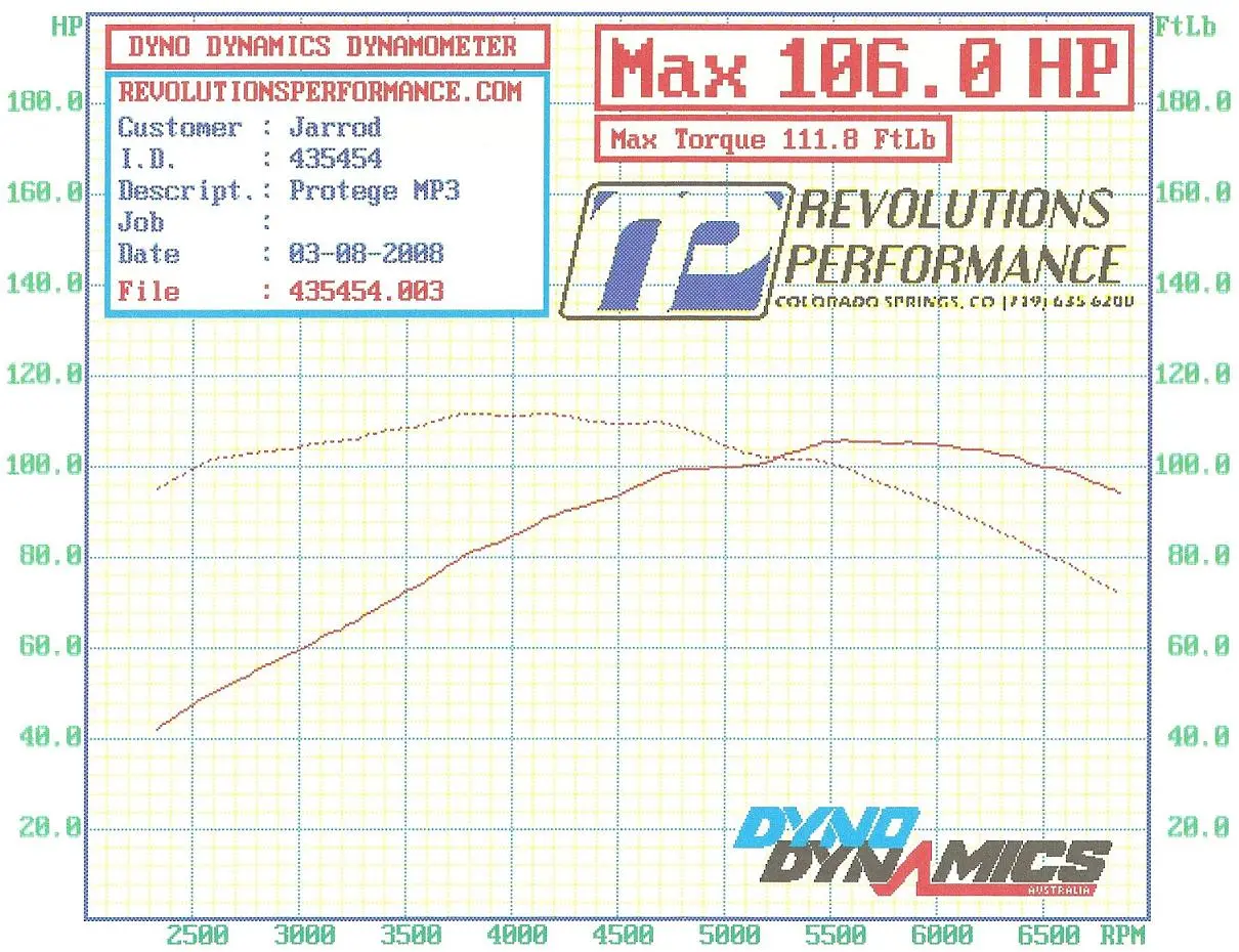

Here's my lowly numbers: 106 HP 112 TQ
I guess I'll put my name in the NA stuff for now. At the time this was done, I had the shorty header, intake and exhaust. I plan to dyno soon to get a reading from post medieval pulley install. Then this winter I will install my twiggy sticks and adj cam gears along with hopefully an AFC. Also need to get my 626 intake mani installed and see if that actually does anything for us NA guys. Then the debate can be settled.

Honestly after full exhaust and intake the next best thing is the AFC.
the ecu doesnt respond well to the mods w/o some sort of tune.
I'm really trying to decide if should spend the money now and get a full standalone. There are several LT-10's for sale right now. Or go with just and AFC and buy something bigger later, IF I need it. I have the money now to get a microtech, that's what's so tempting. But how user friendly is it?
