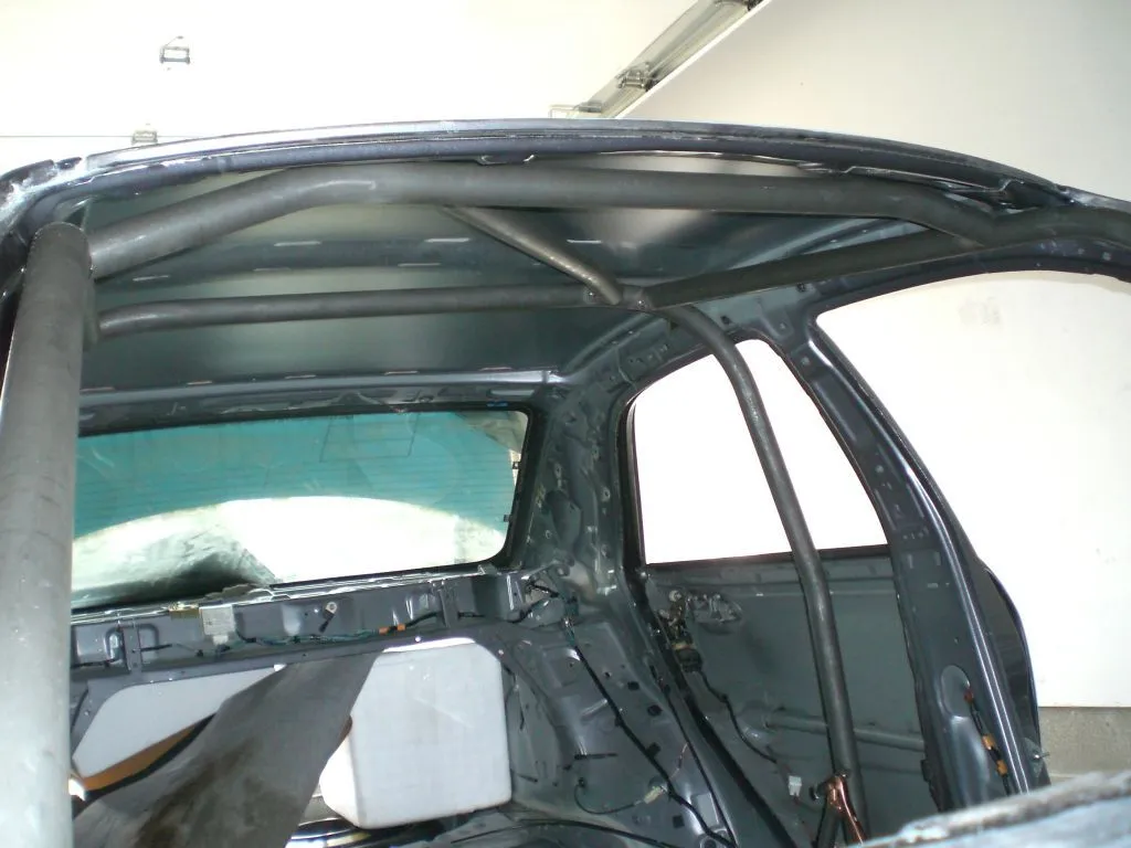

Well I got my main hoop finished and one of the A-pillar / roof bars. The radii of the hoop are touching the roof supports on both sides and the legs are in line with the inside of the B-pillars (at least they will be when I push the driver's side out a little when I weld it) The hoop was a major pain in the ass, but the rest should go a lot faster.
I've been working hard today. I have the front down tubes, the top windshield cross bar and half of the roof X tacked in place. I'll be working till about 11 tonight and I'm hoping to get the rest of the roof bars finished and have this welded to the body by then.
wow. That's some impressive craftsmanship dude. Beautiful work. I can't wait to see it done :)

Roof section is all welded. I'm out of shielding gas and I'm beat so that will probably be it for today.
