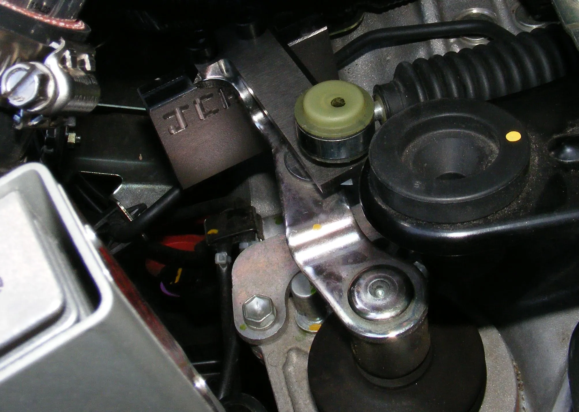

Looking at this, it appears that your design moves the lever towards the back of the car. Whatever direction the ball is moved, in this case towards the front, the shift knob moves the opposite way. Is this correct?
Shift knob back...Lever moves back.
When in neutral...The shifter is in the same spot as without the plate. The picture is an illusion. The ball is moved towards the left side of the car. Not forward or back.
I went back and looked at the photo of it installed, and you are absolutely correct (big surprise - you designed it). In car, you can see that the new location sits squarely on an imaginary line drawn between the original and the shaft.
You are correct sir!

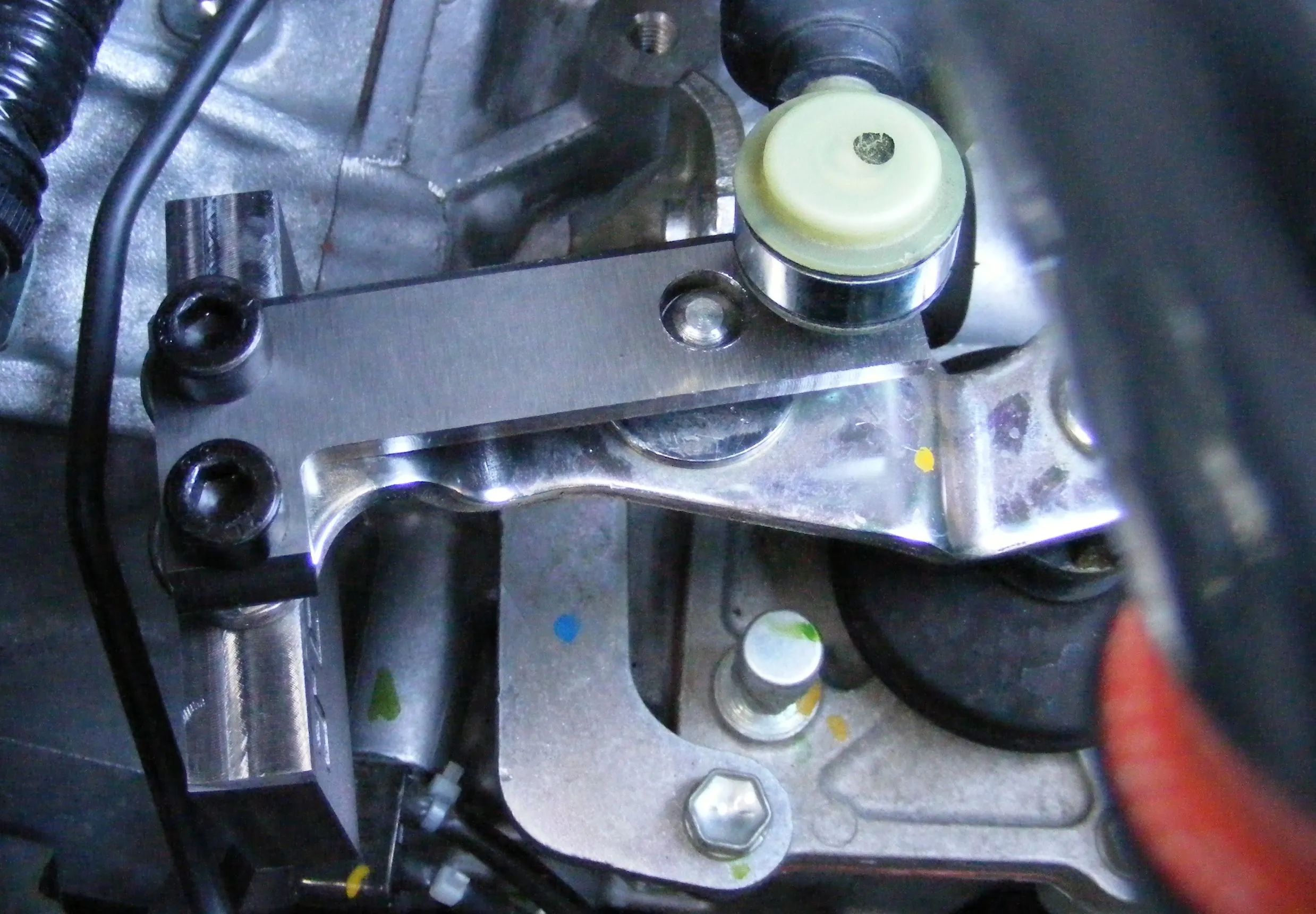

This seems to be the thread for custom short-throw shift plates and shifter weights. I've worked on my own design and I finally finished and tested everything!
My twist is that I made everything from Titanium scrap I had at my job. The shifter weight is pure titanium while the STS plate is Ti-6-4. Long story short I love the shorter shifts and the lighter shift weight.
If I had to do it again, I'd probably not use Ti-6-4 because it's like machining hardened steel, only tougher. I actually skipped the tapped hole and used a nut instead, I could see the flutes in the tap twisting as I tried to tap it.
Feel free to use my print at will. I included tolerances on the location for the new shift point so that you may move it wherever you like. You can probably move it further than my tolerances if you add material to support it.
Props to jbarone and DarthVader for their designs!
