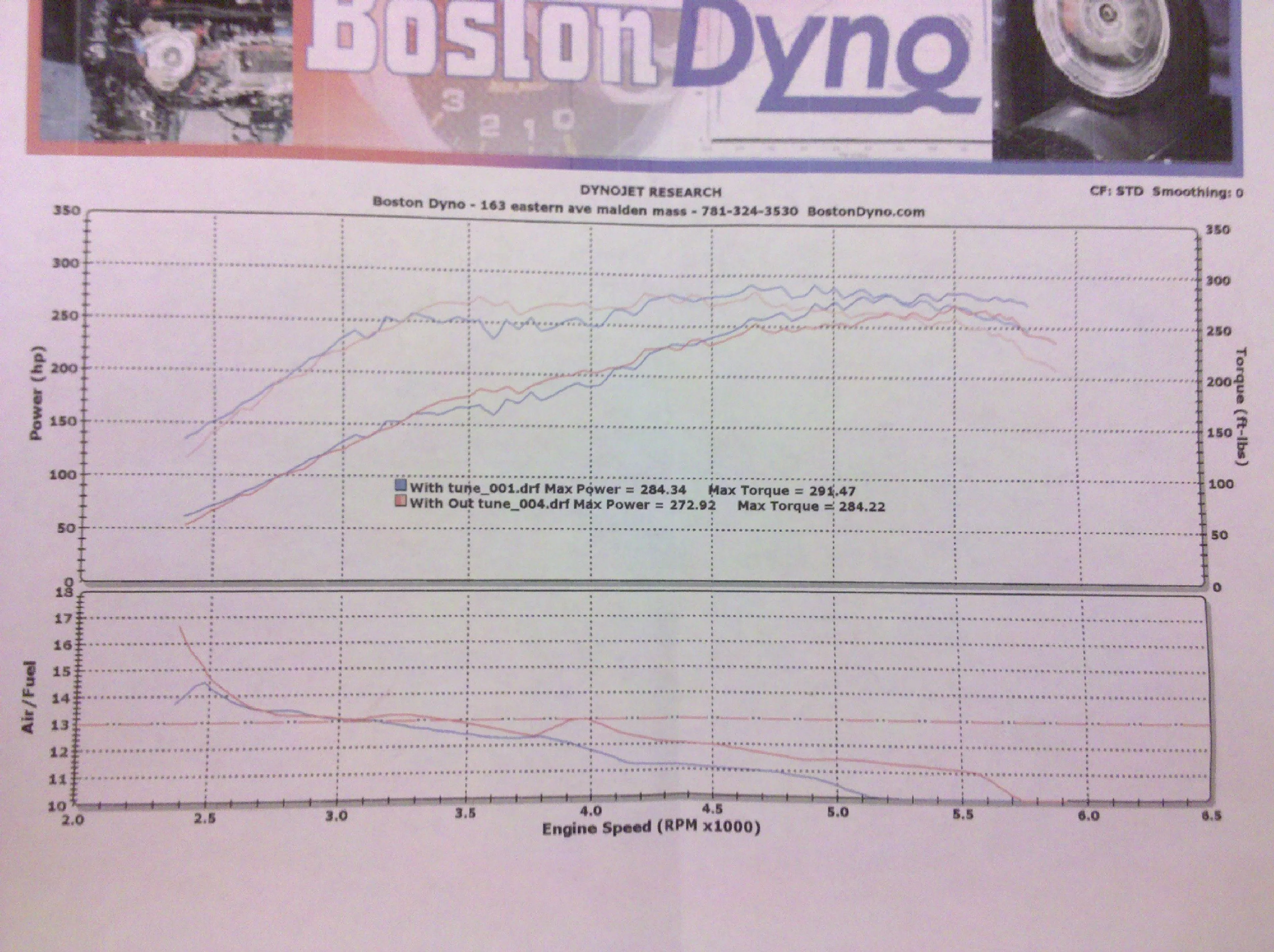

My Hypertech Impressions
Also sorry I do not have a color scanner( Getto) but the top pair are the TRQ the STOCK line is on top at 3500.. The bottom pair are the HP STOCK again is on top at 3500.
Better graph

I've looked over the dyno charts and comments by anm6 and MS3JamOnIt, and talked to anm6 via phone a bit today. Here's my observations on their dyno pulls.
Air/Fuel Ratios: The air fuel ratios they are seeing are in line with what we got on our car. Actual stock AFR's at wide open throttle, above 4500 RPM, are in the mid to low 10's, and can dip into the 9's. This engine is is different than most engines, and tunes, that dyno shops are used to tuning. It is direct injected, so the fuel atomizes a lot better than with a port injected type engine. There simply isn't any issue with the cylinders washing out or causing a misfire or dropping spark with our tune at WOT with this engine. I can elaborate further if needed.
Air/Fuel Ratios with "Stock" Tune: The AFR's staying in the 11's with the "stock" tune are actually lean. This is being caused by an incorrect MAF calibration. With the stock air box and stock tune, your AFR's would be in the 10's at WOT. When you install an aftermarket intake, and don't correct the MAF calibrations, the stock tune is going to lean out at wide open throttle. The computer will correct the AFR's at part throttle with the fuel trims, but at wide open throttle, the ECU is adding the amount of fuel based solely on the air and load calculations from the mass air sensor. Running the aftermarket intake with a correctly calibrated MAF sensor with the stock tune would result in AFR's in the mid to low 10's at WOT.
Dyno Testing: One of the critical issues when dyno testing these cars is heat soak. With the intercooler being mounted on top of the engine, it is easy to get heat soak between dyno runs. The trick is to maintain consistency between the pulls. When you start seeing power drop off between pulls, then you're probably getting some knock retard. Even a slight bit of KR will reduce power output considerably. When we were tuning our car, we had to fabricate a bracket to mount an axial fan directly on top of the intercooler to keep fresh air coming through it. Here's a pic of it on our car.MS3 Dyno Pic.jpg.webp
If you make back to back pulls, and your power numbers are off more than 3-4 HP between them with no changes, then there is something else going on.
Having the hood up and the fan on the car might not be helping that much. A lot of dyno shops have the rollers to the rear of the bay, so that the front of the car is facing the bay door. They can put a fan in front of the car, and blow fresh air across it. If the front of the car is facing the inside of the shop, then its likely that the fan is just circulating the heated air. The radiant heat coming up from the engine compartment is being blown around by the fan, and is just being sucked in by the engine and intercooler.
Power Gains: Something else to look at is what RPM you're starting the dyno pull. With these cars, you need to start the pull as low of a RPM as you can. If you look at our dyno chart, we started ours around 1100 RPM. This allows the turbo to spool up to full boost. A 2 wheel chassis dyno doesn't put the same load on the engine that is on it when you are driving down the road. The rollers are a lot lighter than the weight of the car, and the RPM's come up a lot quicker. This is what is causing the torque numbers to be lower than ours.
Our max gain was made at a higher RPM than peak HP. The main benefit of aftermarket air intakes and exhaust mods on these cars is the improvement of airflow at the higher RPM ranges. The Hypertech tune takes advantage of the added airflow up top, and the numbers show it, even on a stock vehicle. You should see significant gains over stock from 6K up.
I suspect that both cars were experiencing some knock retard, although anm6has a front mounted intercooler, and let the engine cool down quite a bit between runs. I suspect that he was getting some KR due to the MAF calibration being off.

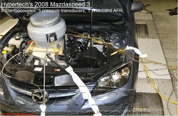

What we learned after over 1,100 dyno pulls is that leaning out the air/fuel ratios increased the exhaust gas temps to unsafe levels, and is susceptible to knock retard. We tested tunes with leaner AFRs. What we found is although more power can be made, the resulting increase in EGTs was not desirable for engine longevity, and the performance was inconsistent.
The EGTs at wide open throttle with our tune are right at 1500, which is around 50 hotter than stock, peak to peak, during a dyno pull. If those AFRs were pig rich, you would see a measurable reduction in EGTs over stock. This just isnt the case with our tune on this engine.
We also tested our tune with no MAF correction, and the engine does make slightly more power. But during multiple dyno pulls, the results were excessive boost, an increase in EGTs, and excessive knock retard, and all with leaner AFRs.
With our tune, boost comes on full at 2800-3000 RPM. We tune the boost cut and load cut limiters to allow for mods, but leave them in place to protect the engine from a mechanical failure that may cause destruction if these limiters are removed. With the air mass calculations correctly measured, these limits can be used just like the factory tuning uses them.
All of the protection strategies that the factory tune uses are still in place. The Hypertech tune accurately models the engine power output which allows the ECU to precisely implement the protection strategies to prevent overboosting, overloading, and overheating the engine and catalyst. We put a lot of time and effort into developing and testing this tune to ensure that it is not out of control. Not all of the aftermarket tunes available for the Mazdaspeed3 do this.

Yes, we thoroughly tested the Hypertech tune at different air/fuel ratios to see the affects on EGT's. We tested tunes both richer and leaner than stock.
Simply put, the leaner the AFR, the higher the EGTs.
The only way to get unburned fuel in the exhaust at wide open throttle would be to have a cylinder misfire. You would see an instantaneous drop in EGTs if this were happening.
We measured EGT's in each exhaust port, in the exhaust manifold, as close to the cylinder head as possible. If there were any issues with cylinders misfiring, we would be able to see them instantaneously.
