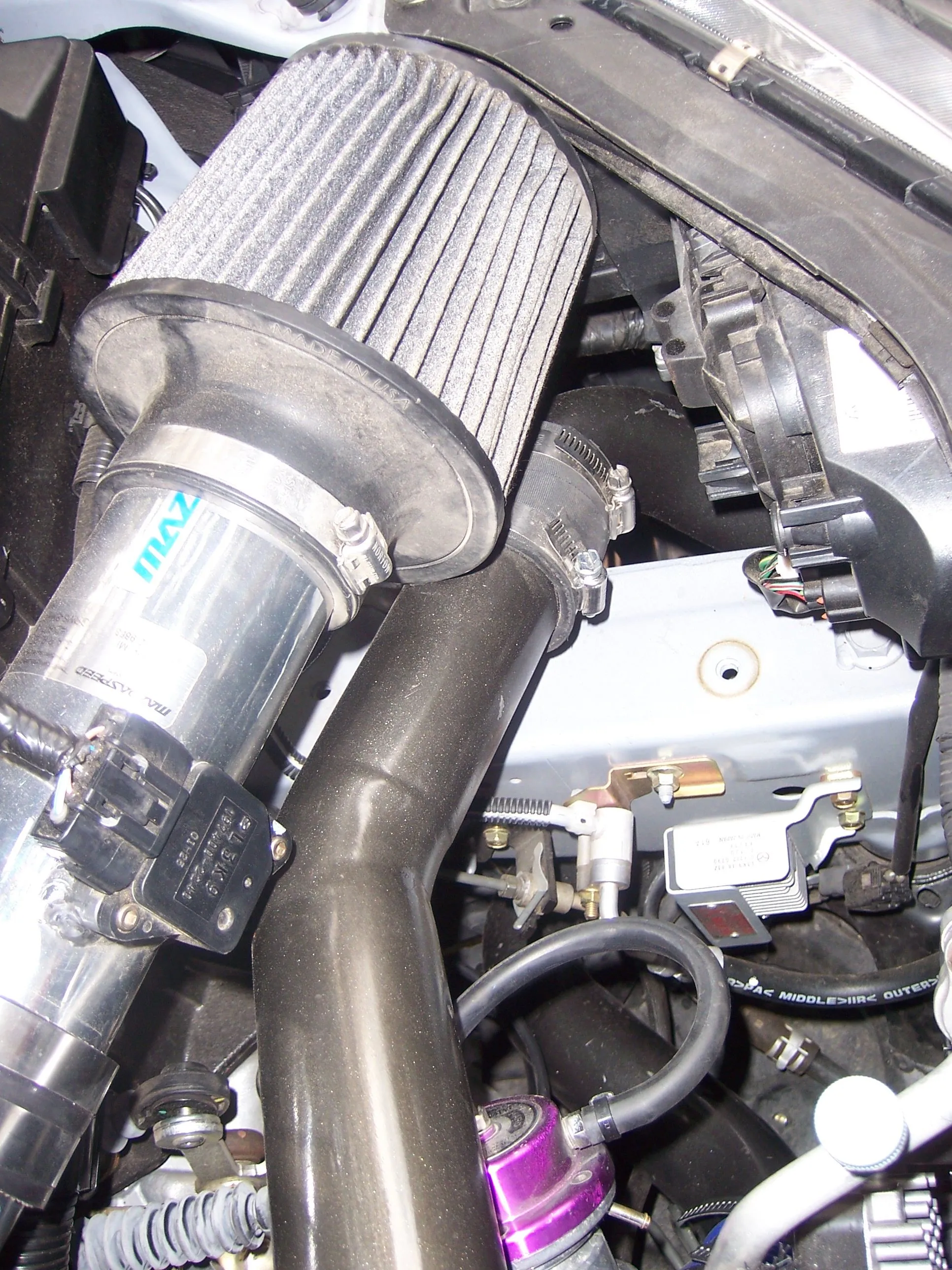

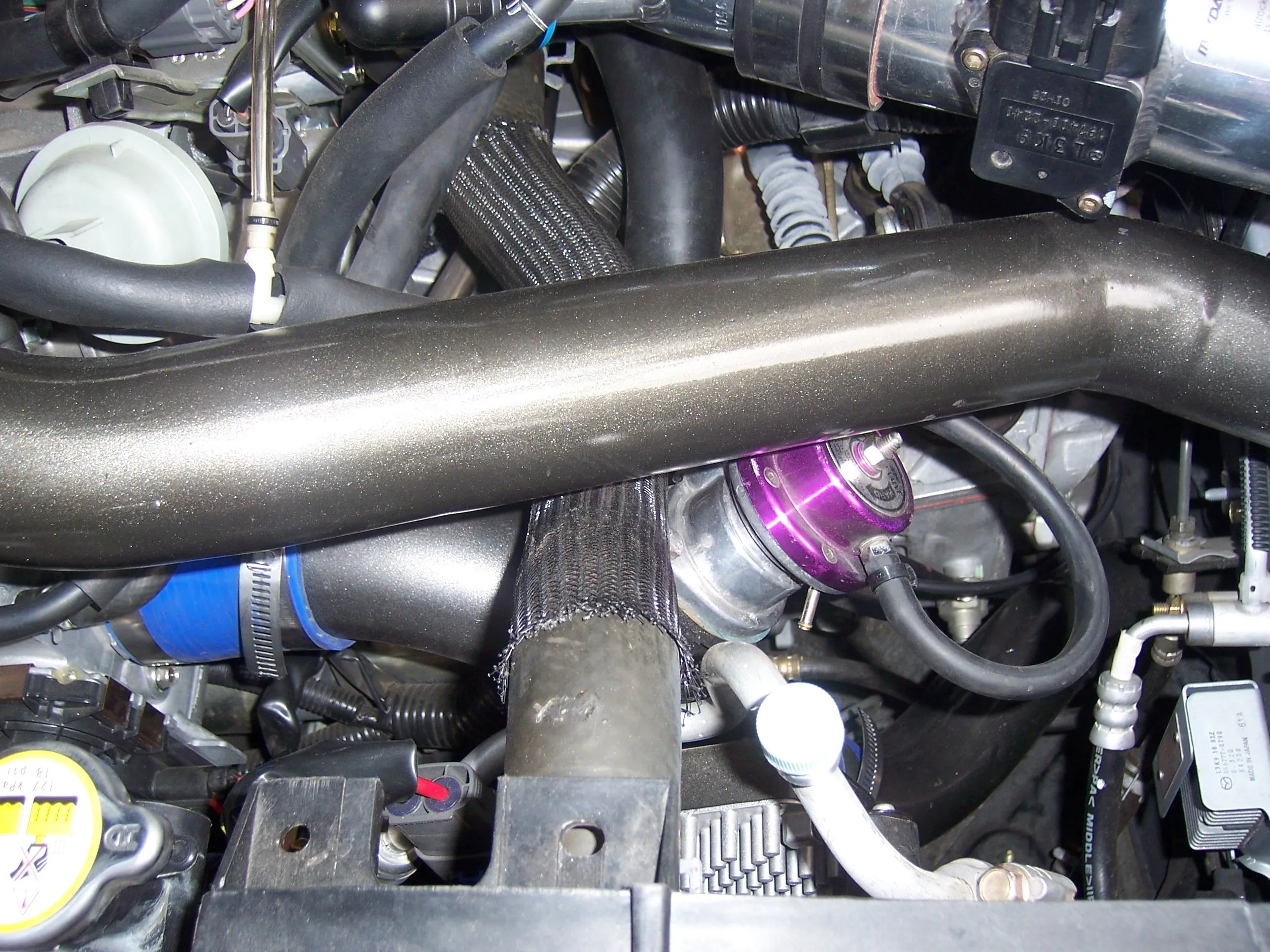

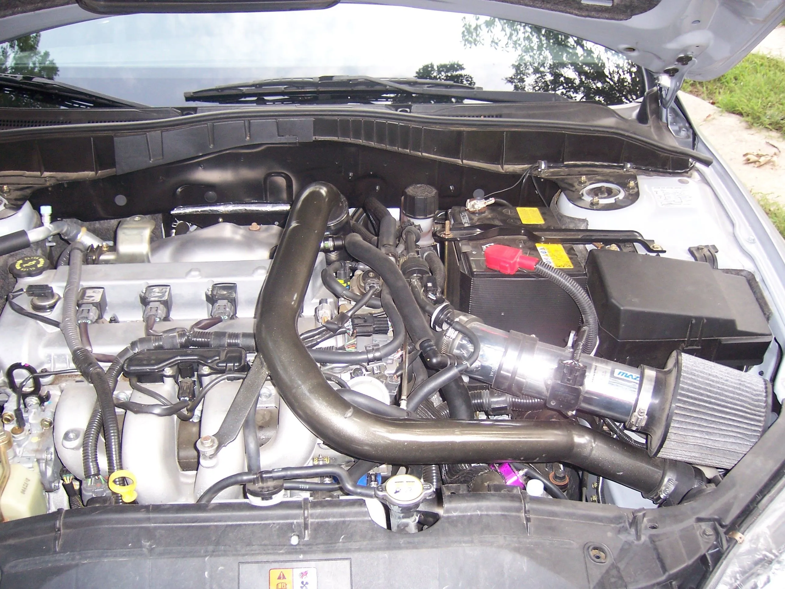

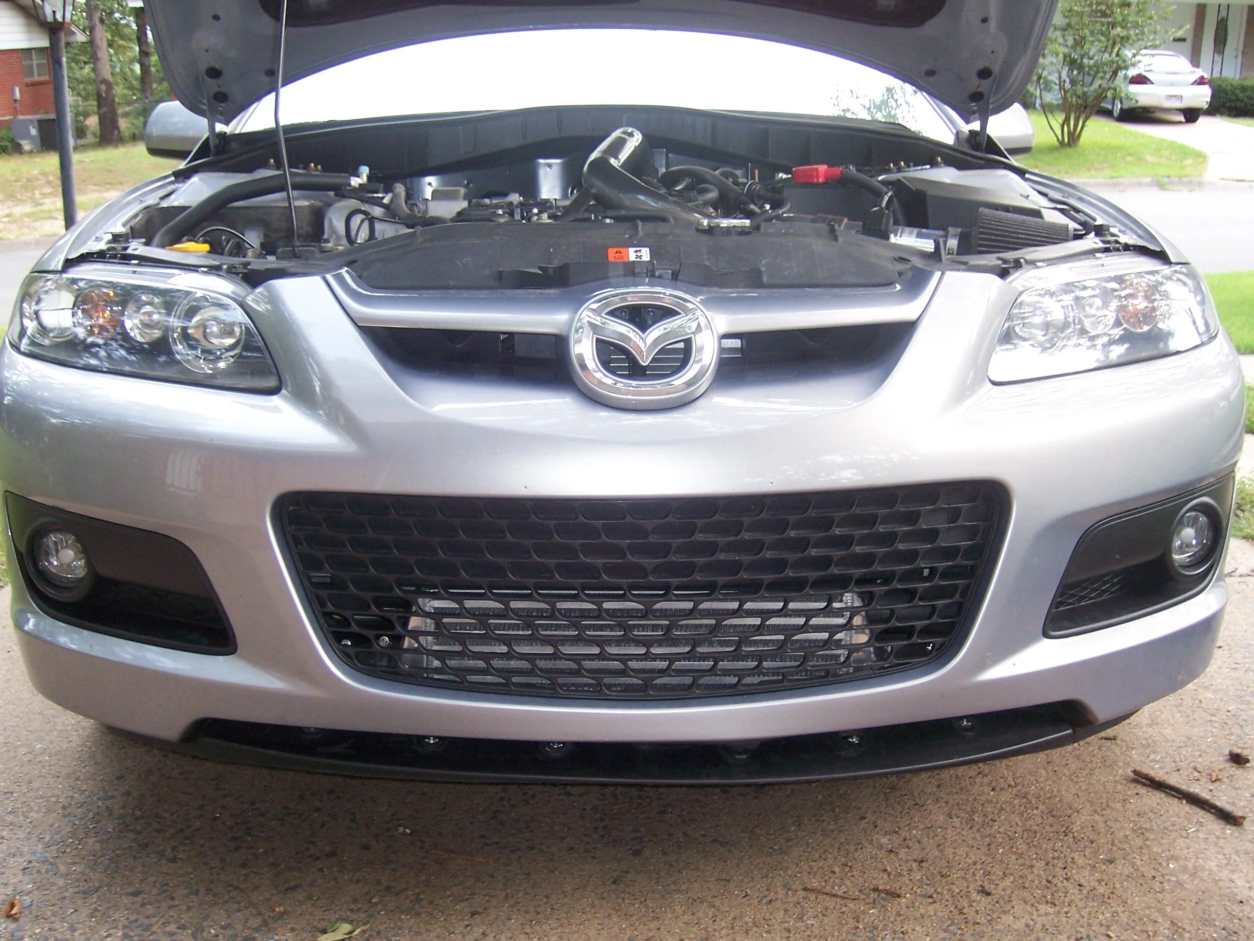

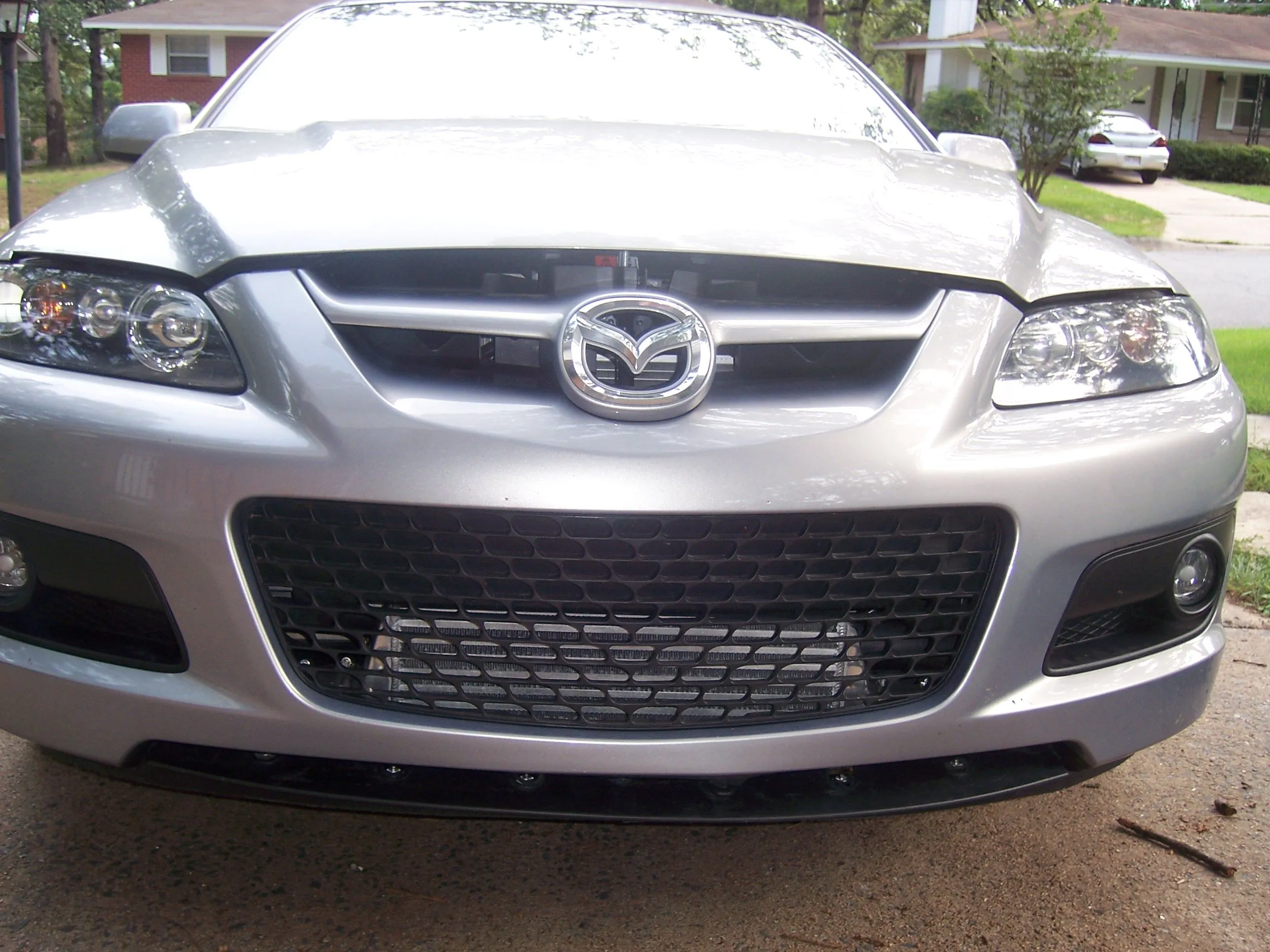

I know the factory splitter looks funny, it was late and we tried to get it back on the best we could. But it is back on normal with a little extra cutting. Hope you guys enjoy!!

I got it done at Polk Performance in Benton, AR. Everything was made form scratch except for the IC. There isnt an AWD dyno anywhere close to here, but they are getting one in August or September, so believe me when I say I cant wait to dyno my car either. Because this was the first kit they made, sort of as a doner car, I got a deal on it, but I dont know how much the kit is going for now. Dave, the owner of the shop, asked me to let anybody interested in the kit to call the shop. Their hours are Monday - Friday 9am-5pm central time. The number is 501-778-7223.

Is the hood not completely closed on the first pic?
No, I popped it before I took the picture. I will get a better and updated picture tonight or tomorrow. That way you can see how the bottom factory splitter fits perfectly now.

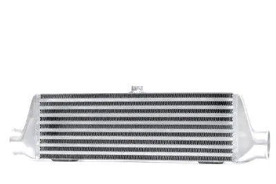

If you ever end up taking the bumper back off, could you get some pics of how you mounted the IC. Also, what format are your endtanks?
I am still working on getting the photos developed that have the bumper off. If you have ever had your front bumper off, picture this. If you place you hand in the center of the bumper support and feel the back side of it, there is a hole. What he did was drill a small hole in the bottom of the support and put a bolt through the hole and screwed it in the top mounting bracket that was welded to the intercooler. As for the endtanks, they said it was just aluminum, nothing special. Here is a picture of the intercooler, so you can see the mounting bracket.
