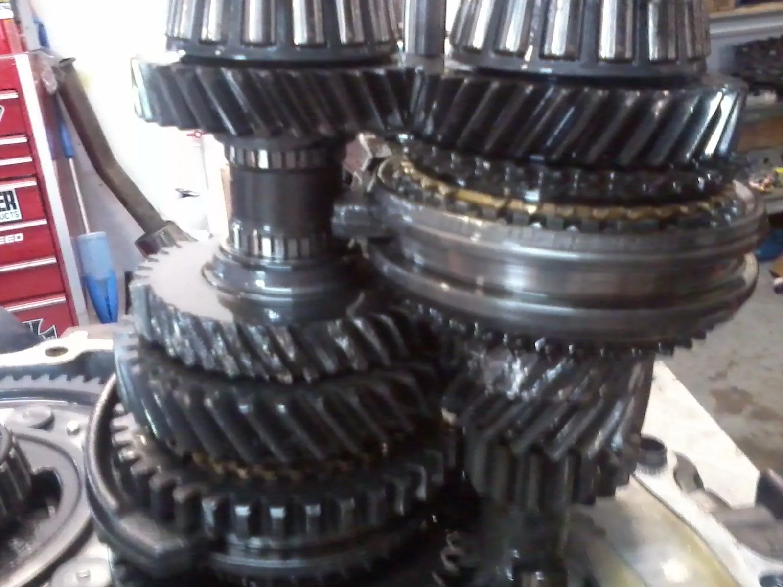

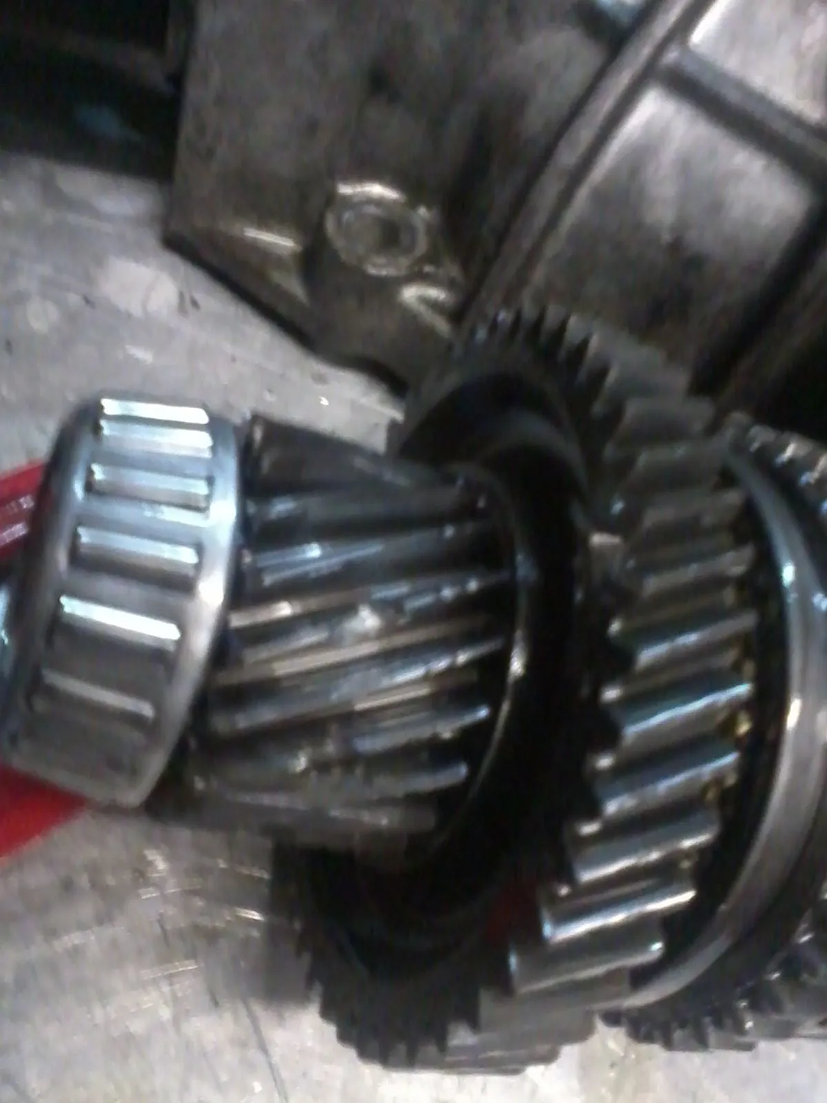

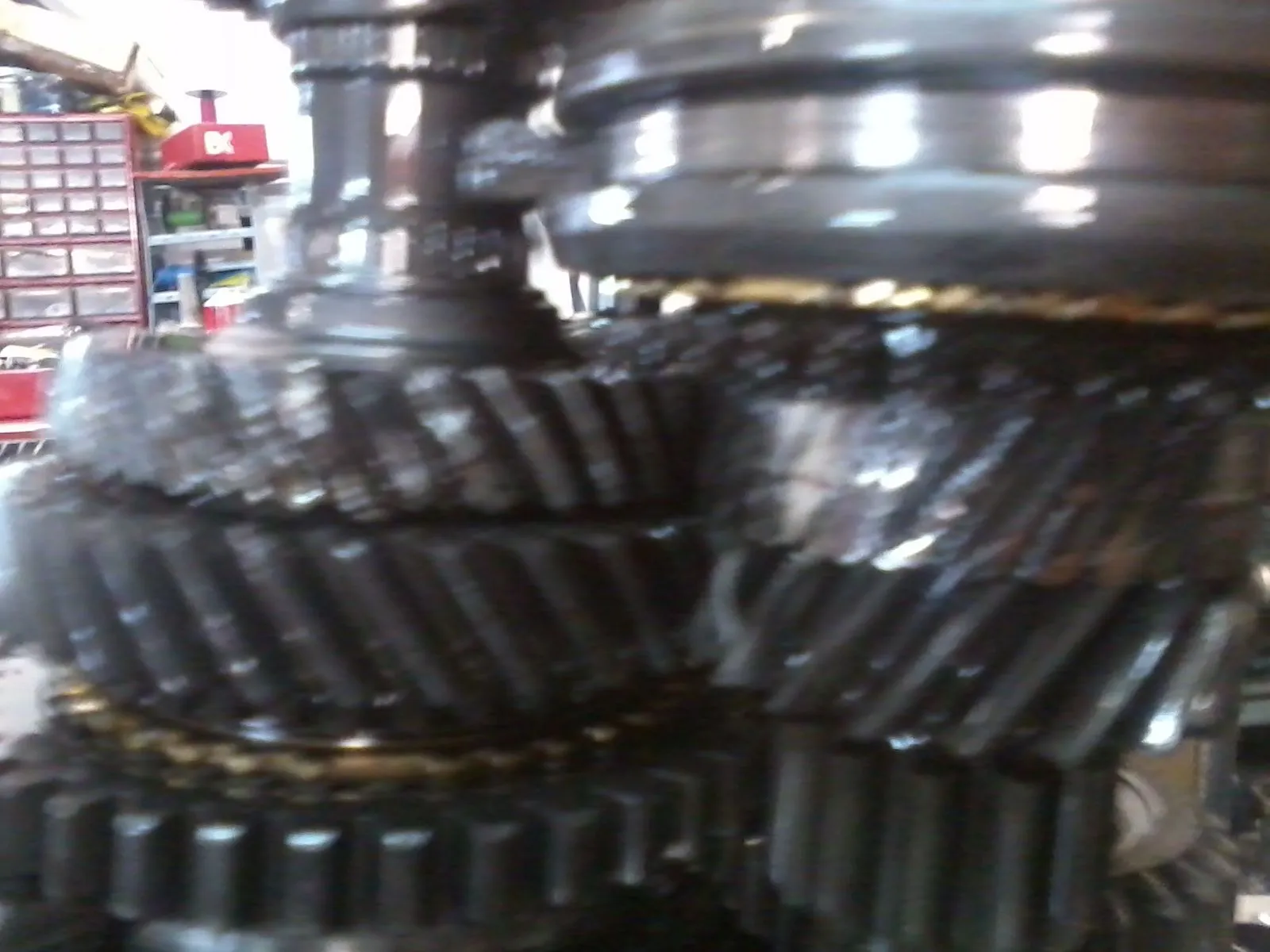

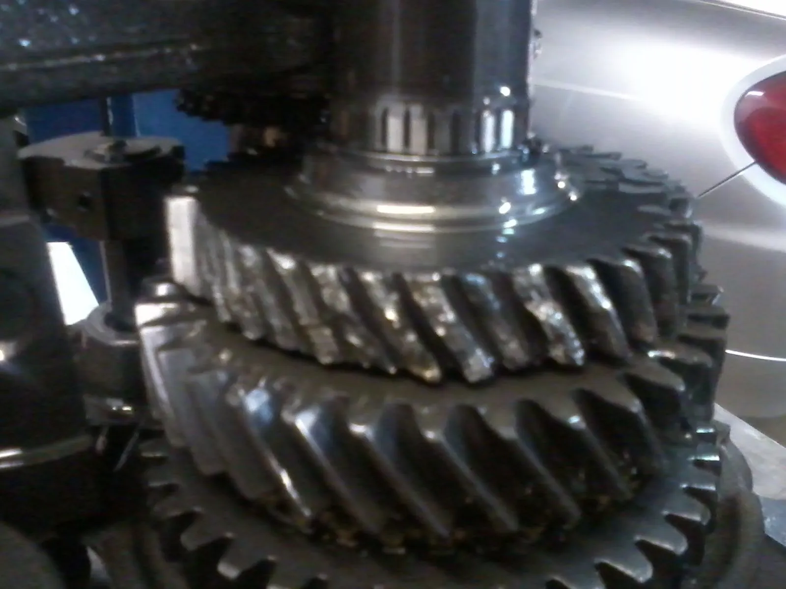

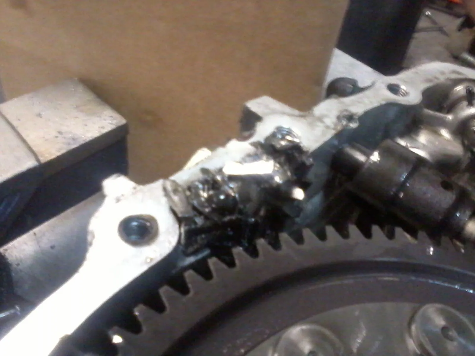

Hey everyone i havent posted on here in a Pretty long time but id like to give everyone an update on the car. Shes been running on 25 psi on the gt30 for a good 6 months making 538whp 492trq . Nd yes all that on a STOCK geared tranny ! . all i have is a quafie lsd . soo now comes the sad part about a week ago i was driving home from work and as i shift into third the car starts shaking and before i know it third gear decided to take a s*** on me -__-. soo we took the tranny appart and ill post the pics of what it looks like. but i broke 3rd gear and damaged my final drive gear so now i need a new one. to cover the gear that i broke i orderd a cpboost 3rd nd 4th gear combo both gears are billet and double synchroed. well ill keep everyone updated on the progress of the car ^__^.
