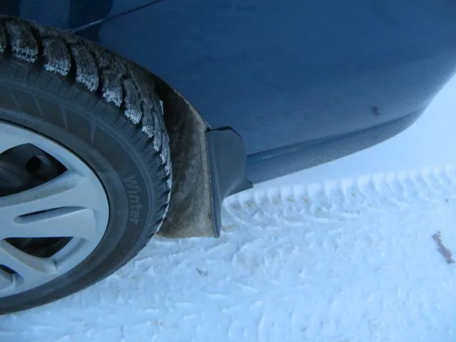

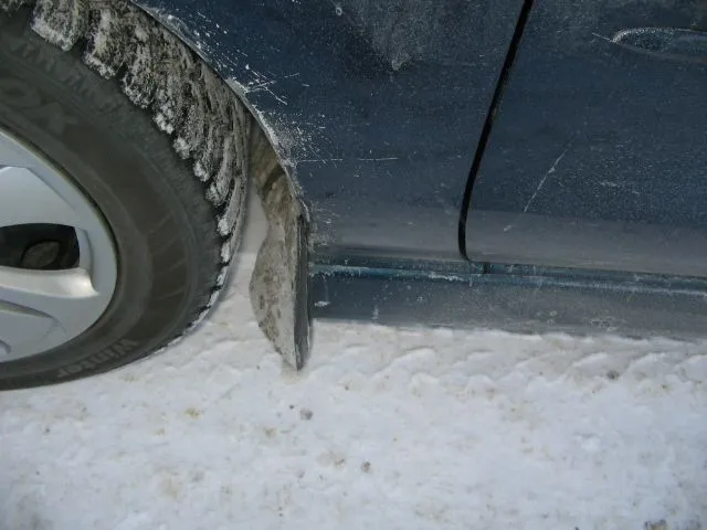

No idea why MAZDA does not have mud guard for the Mz5 GT.. here in saskatchewan, flaps help prevent the salt from residing under the side skirt the whole winter season. I had to use those mudflaps at the canadian tire.

Thanks to Skyhawk for helping me with the mudflaps. His photos helped a lot.
I finally settled on these types for the rear of the Mazda5. Hopefully Madza will eventually have the correct accessory for us North American types.
Installed them today. Not the best, but they will do the job until the correct ones are installed.
Just tried to install the same mudflaps on my GT as sapacif, but found that aside from the predrilled holes on the outer edge, there is nothing but plastic on the inside of the wheel well. The outer edge sits nice, but inside it's floppy and I'm worried that something could catch and pull it off. Any suggestions?
I like the flap you used. I'll be changing mine when they are worn.
If it is plastic at back of the inside of the mudflap, then it is safe to drill a hole
on the plastic (i.e. no danger of rusting). Then just screw the flap to the plastic. Had the same problem in the front. I drilled on the side sill surface backing the flap.
As the tire rolls over those nasty speed hump in malls for example, you'll hear the flap scrape on the speed bump. the flap material should be flexible enough to aborb the force instead of it pushing back on the mounting screws.

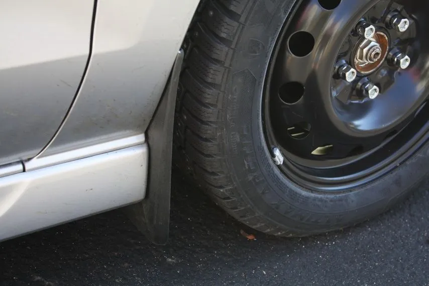

Time to wake up this thread. Inspired by skyhawk and sapacif (above), I now have a pair of these exact universal Roadguard jobbies on order for use on the front. I also have a pair of the official OEM rear ones coming (by way of a complicated family-based arrangement) from Europe, where they are available. I carefully compared hi-res photos of the Euro/UK version of the 5 to my own car, and have concluded that the rear fender well profile is the same for all practical purposes. Even if the fit is not exact, I am sure it will be close enough and adaptable. Will post photos of the result when/if installed.

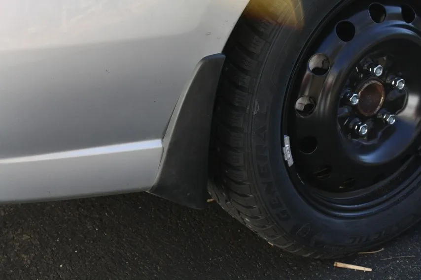

OK, here we go. Did the winter wheel changeover yesterday (see General Altimax Arctics with steelies in the pix), and installed the new mud guards while I had the wheels off. The cheapie specials on the front as suggested by sapacif, and the OEM Mazda European version on the rear.
As you can see, the Euro OEM version is a very close (but not 100% exact) fit, there is a small mismatch of the rear fender contour at the crease, but it's not a big deal. The two pre-punched holes in both flap and fender matched up perfectly, and the capture nut clips included fit just fine in those locations.
The only one that didn't line up correctly is the third one you don't see underneath, and that was easily remedied by a self-tapping screw. The diagrams in the included paper instructions were not too helpful, but this isn't rocket science. The written instructions were actually hilarious (and essentially useless), as they were in one of the worst English translations that I have seen since I worked on Sony pro analog video gear back in the late 1970s.
Example instruction: "Tightening the bolts certainly. If the bolts are tightened by out of regulation torque, the mud flaps may be broken or dropped out". There are more, too numerous to list.
In any case, they worked out OK, but a tad pricey at 48.00 given the current exchange rate. In combination with the cheap front solution, not so bad overall.
