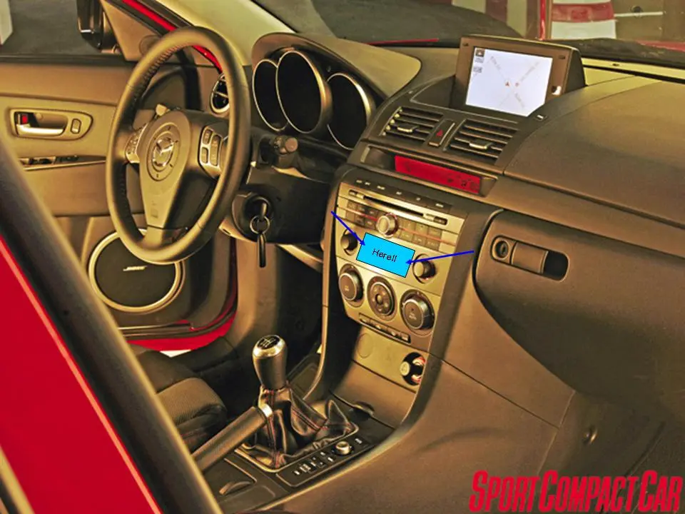

Also, can you install it below the radio between the two knobs?
See image below!!

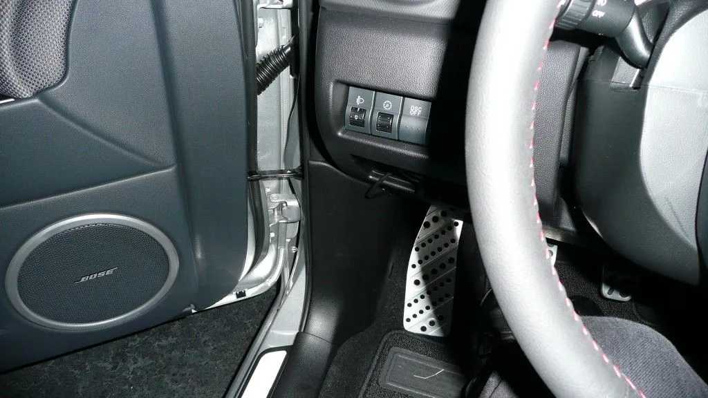

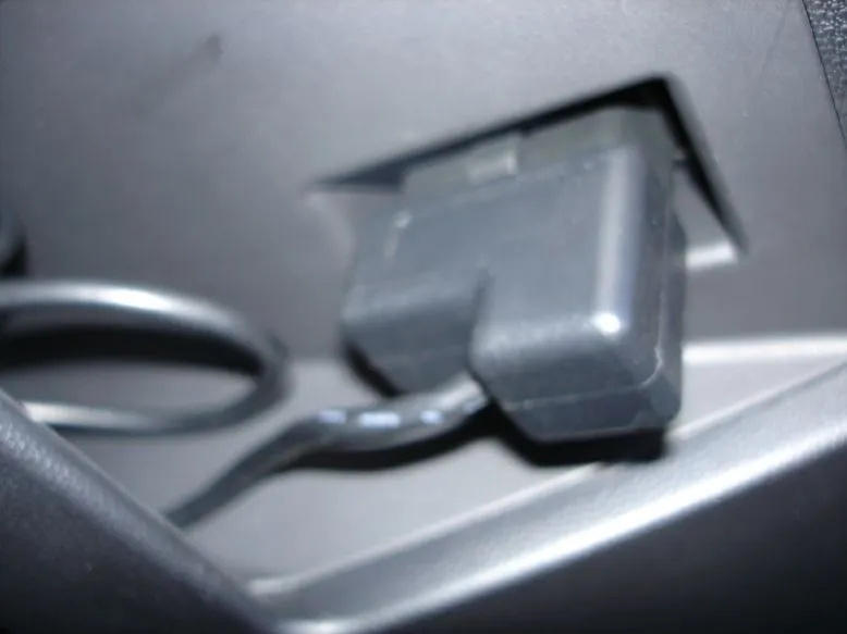

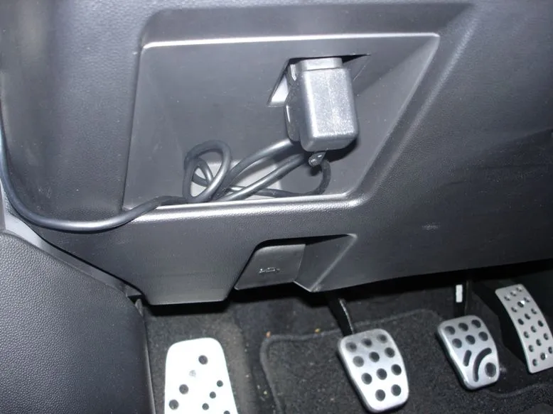

pics thats what it looks like you dont notice it if you hide the wires or if your really looking for it

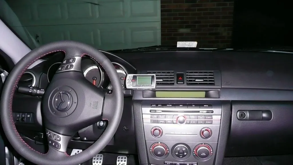

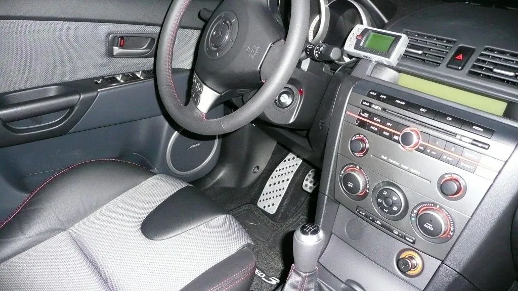

Here are pics (taken in the dark) of mine. I tried to show from the back seat and from the passenger seat. Pretty stealthy.
