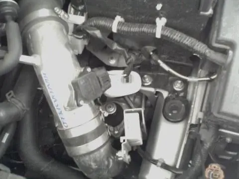

Probably should have also attached the photo of the location of where I put the engine bay temp sensor. Here it is. It's the oval white object right next to the MAF sensor. It's sitting on top of one of the rubber mounds where the stock air box used to be. I figured that the intake on a SRI would be pretty close to that if I was in SRI mode, and I did not want it sitting top of something metallic as that might transmit heat to the sensor.
Not trying to make a big deal about this, but that engine bay heats up fast. If you leave it sit longer, like you might in the staging lanes at the dragstrip, underhood temps get pretty damn close to 130 degrees.
