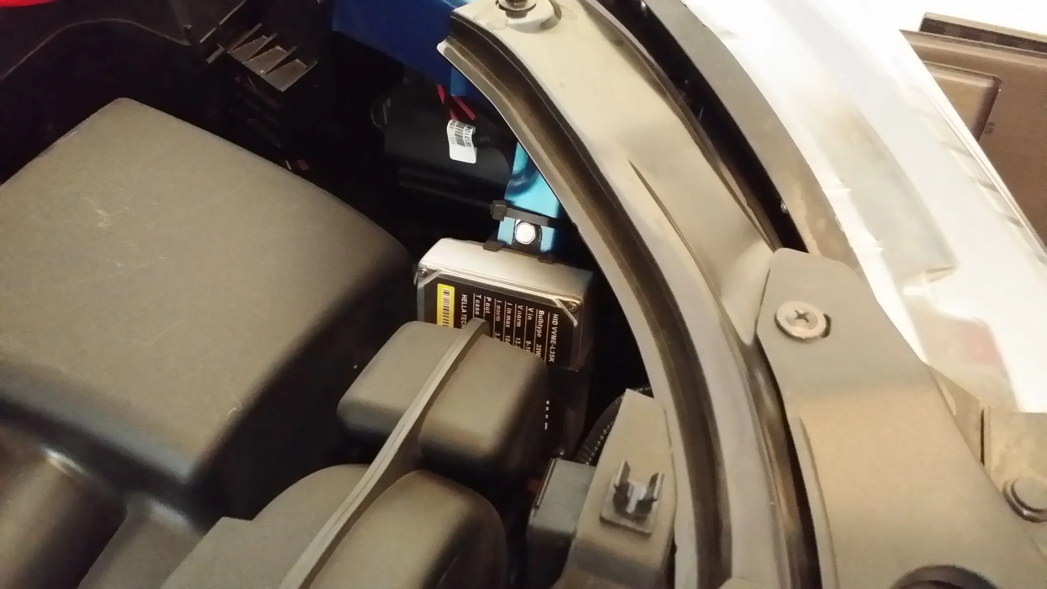

I wanted to get the HID since I got the car last year but never get around to it. The light output look really good. If you could post some pictures how to install them would be great, at least where to mount the ballast, I find the headlight area on the driver side really tight.

You only need the relay tdman. From what I understand, the canobus is for cars with special burnt bulb detection systems or things like that. I'll try to post a few pictures of my balast placement here when I get the time, and maybe do a more complete write-up of the installation procedure in the How-to section later. This is my first time tinkering with a car, and I had no problems, so you should do fine.

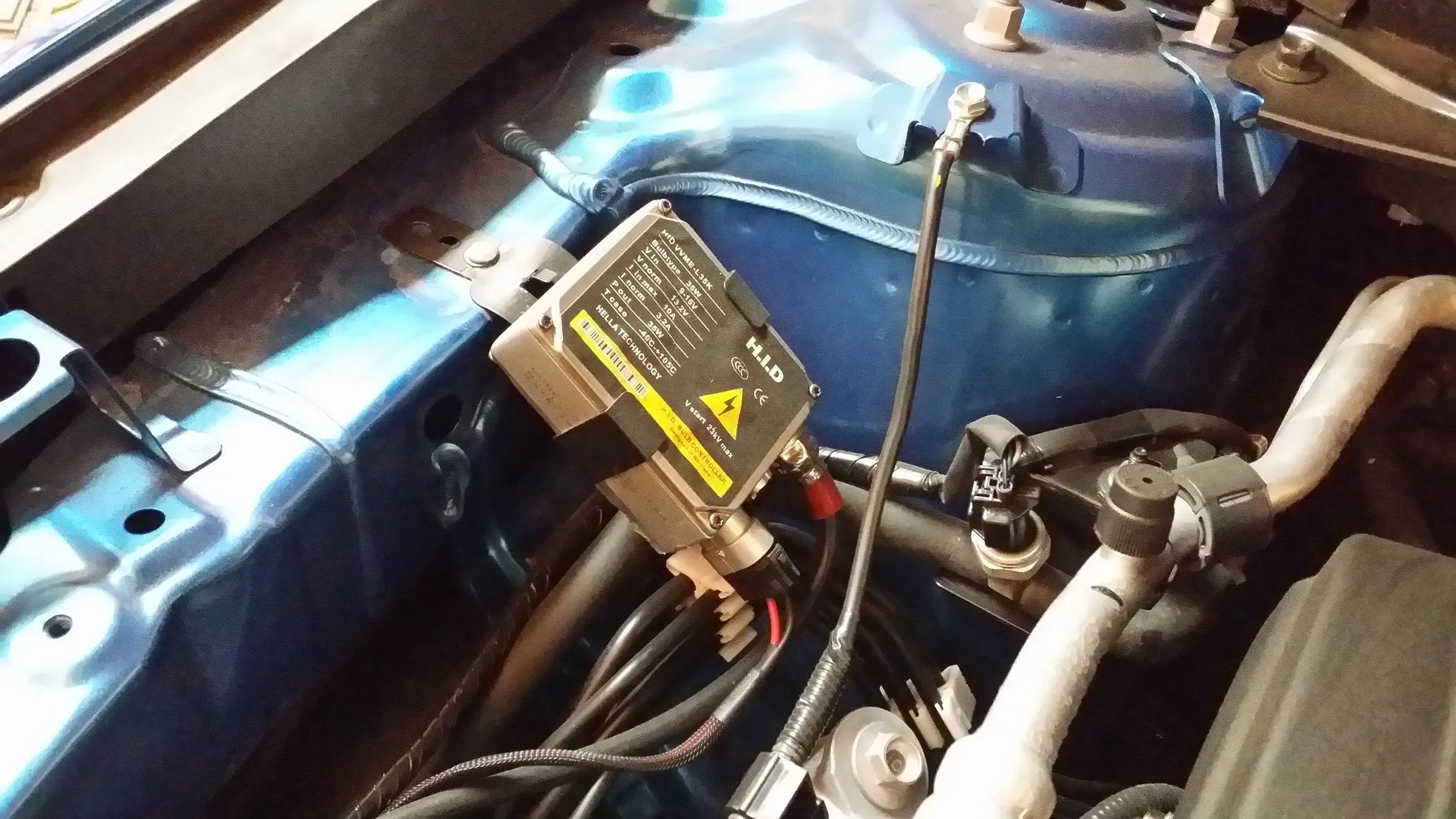

Here is where I have installed my ballasts, they are not Morimotos though. Maybe, when these will go out.

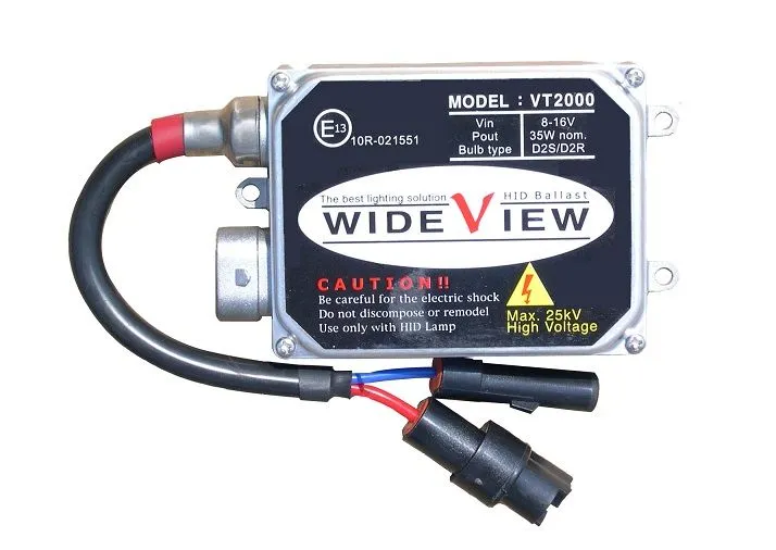

I did not have good luck with those slim ballast kits. I'm using, the old school big ballasts. and the wiring that comes out is pressed on , not that screw on nut type.
