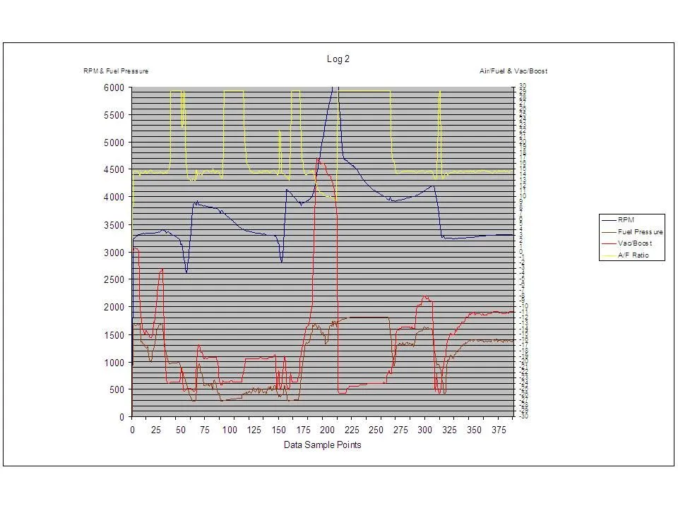

I finally got some data logging off my MS3 and I've noticed my A/F ratios dip in the 10s and occasionally in the 9s.
My first question is ideal A/F ratios...?
11s...? At which point does it become critical; 10s, 9s...? Am I causing damage to the engine dipping this low...?
My current breathing mods are a MS CAI and a CP-E catted DP. I'm planning to install my ETS 3.25 TMIC this weekend and I'm assuming thats just going to worsen the problem...?
Will installing a high-flow fuel pump resolve this issue? Laloosh, Haltech, Driver311, any others...?

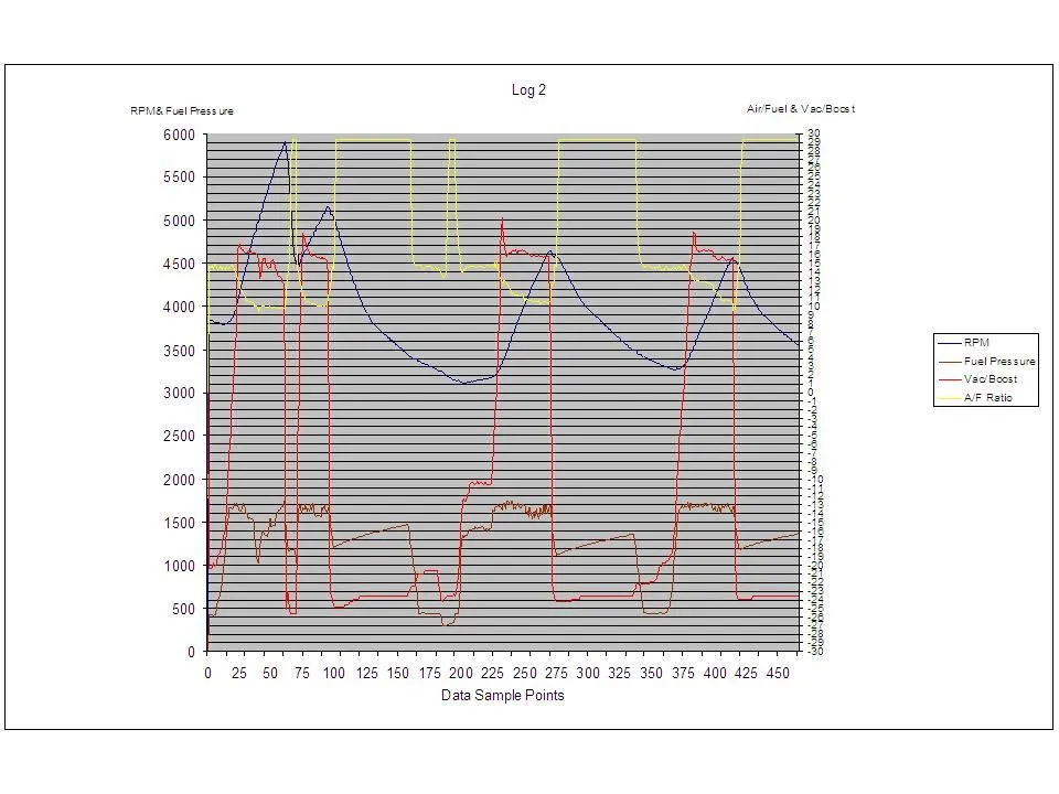

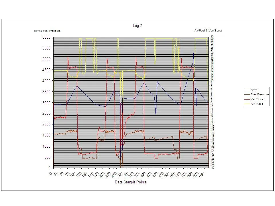

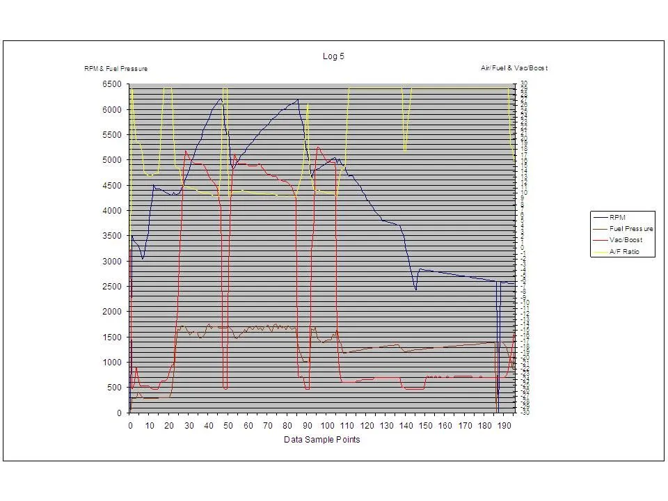

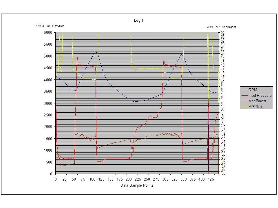

There are a few accelerations I did on the highway. I couldn't get a clean single run do to traffic and roads not being available at the time. In a one or two of those plots I hit 9s...
I graphed RPM, Vac/Boost, A/F Ratio, and Fuel Pressure. Did I need anything else?
I am planning to do a clean 1-4th gear run asap...
See what you guys can decipher from all this... Do I have something to worry about? I need/want to learn this stuff; its pretty interesting... (2thumbs)
Please bare with me, it was my first time data logging with the DashHawk.
I'm still unfamiliar with the unit and all its settings.
Thanks for the help guys!!! (2thumbs)

the "lower" the number, the richer it is. it's Air/Fuel ratio, so the more air there is in the mixture, the higher the number will be.
the shape of your AFR curves look pretty reasonable. it begins to run richer when you boost, so that's a good thing. as for the exact numbers you see there, i really have 0 qualifications to tell you about their validity.
