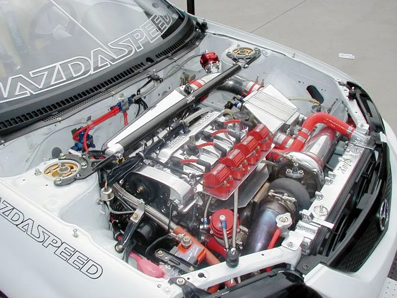

I like how JIC did this setup. I wondering which wires and coils they are using. Looks like MSD coils.
Since me and you are the ones keeping this thread going, he he, do you know or can u tell which wires are those. I will try and make that same or very similar bracket fo r the coils. Also do i need 4 or 2 bosch coils. I think they are sold in pairs for around $80.

just wondering which plug wires are you using with your setup, and do you have any pics of that.
not sure i'm following? are you talking about the plugs on the leads?
I just went to a shop, showed them my coils, said "i want them like this" and came back 20 minutes later and they were done
Sorry, Im referring to the wires that go from your coils to your spark plugs. If I could find which ones JIC is using on their protege i would go with those. Sorry, to keep asking you all of these questions.

Im curious to see how your leads look like, and also how your whole system looks like under your hood. If you have time post up some pics, there arent many. I saw your thread when you were fabing up the coils and stuff, now i just want to see the finished end result.
