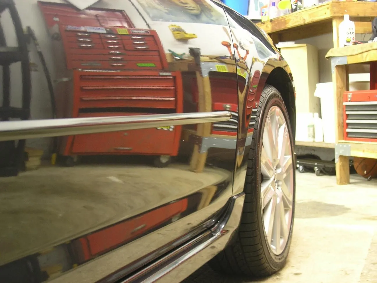

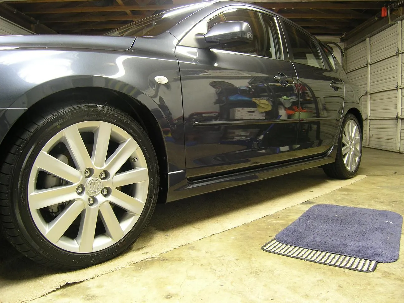

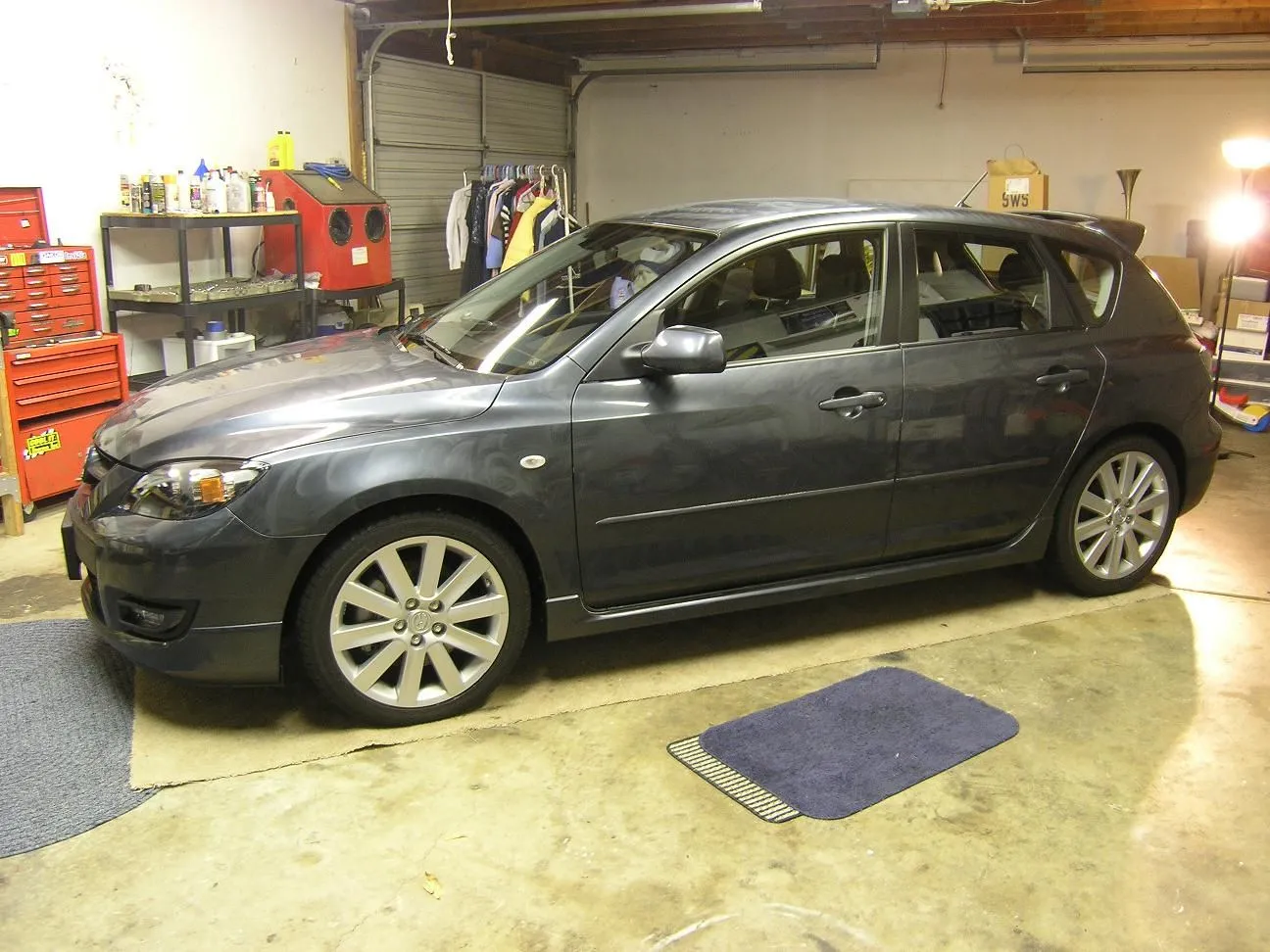

So I just put my first coat of wax on the new MS3. I used the Meguiars NXT 2.0 wax and was very happy with the results. I used it about 2 weeks ago and washed the MS3 today for the first time since and after a 300 mile rountrip to Reno and back along with a few rain showers accompanied by standard road grime. During the wash I used minimal pressure on the wash mit, basically the weight of the mit and my hand and everything came off cleanly and quickly.
I hope she looks this way forever!
