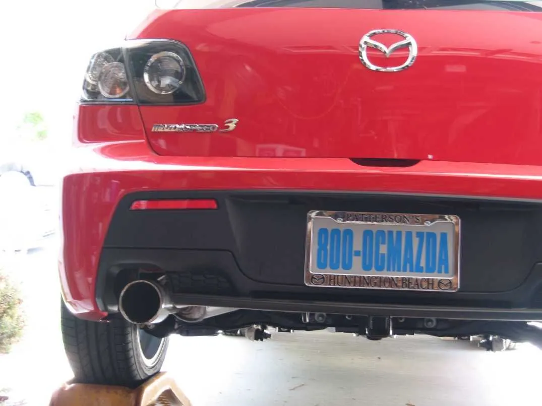

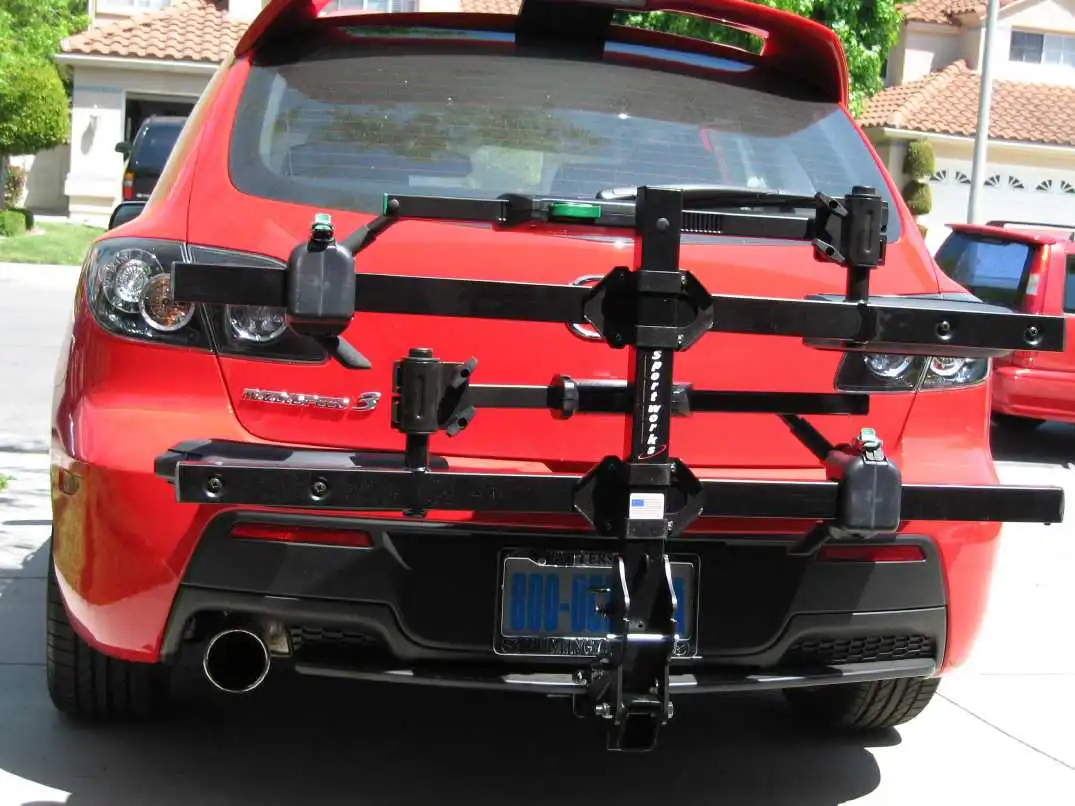

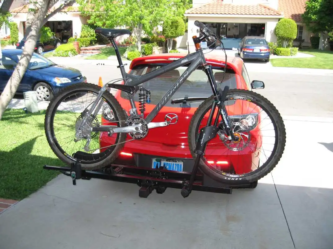

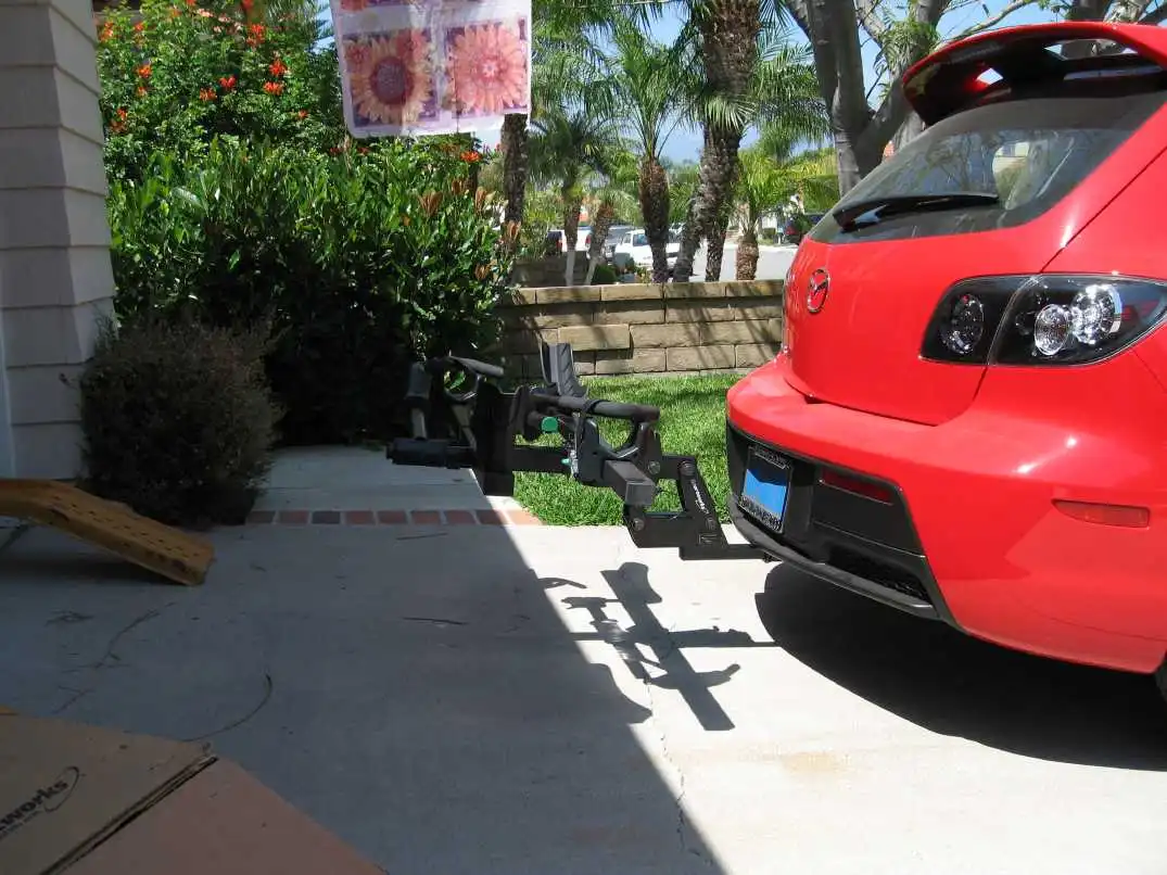

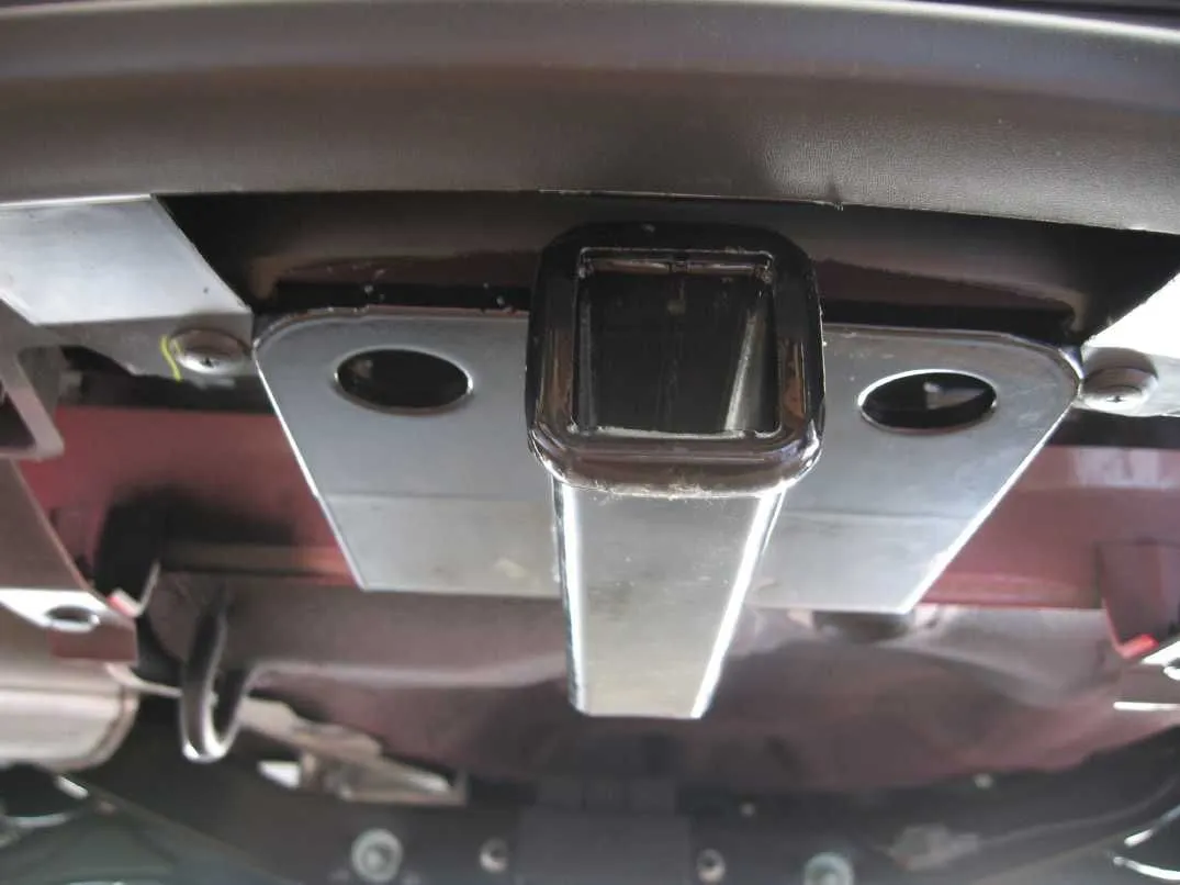

Well if there was any question as to if a Mazda 3 hitch would fit on a SPEED 3 - the answer is YES! It fit so good that you can hardly notice it. I don't plan on towing anything - it is for a bike rack. If you try to put a rack on top - good luck opening the hatch. This is the best solution and it looks great.
The hitch I used was a Curt #11384 because it has a nice HD plate - the other brands (Reese, Draw Tite, Hidden Hitch) all made by the same company "Cequent" didn't look as sturdy and didn't offer a lifetime warranty. Actually the Reese brand did - but I figure it was same as the others - different finish.
Attached are some pictures of the car, hitch and rack. It took about an hour to install because I took my time and had to take some pictures during the process. Install is straight forward - you will need to trim part of the inner plastic fascia to have access to the holes on the receiver - but you don't need that part and you can't see it unless you look under the car. I used car ramps to make the install easier but you could do it without them. I also used some locktite on the bolts - just for safety sake.resized_IMG_7842.webp
