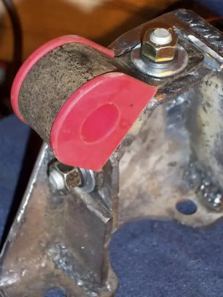

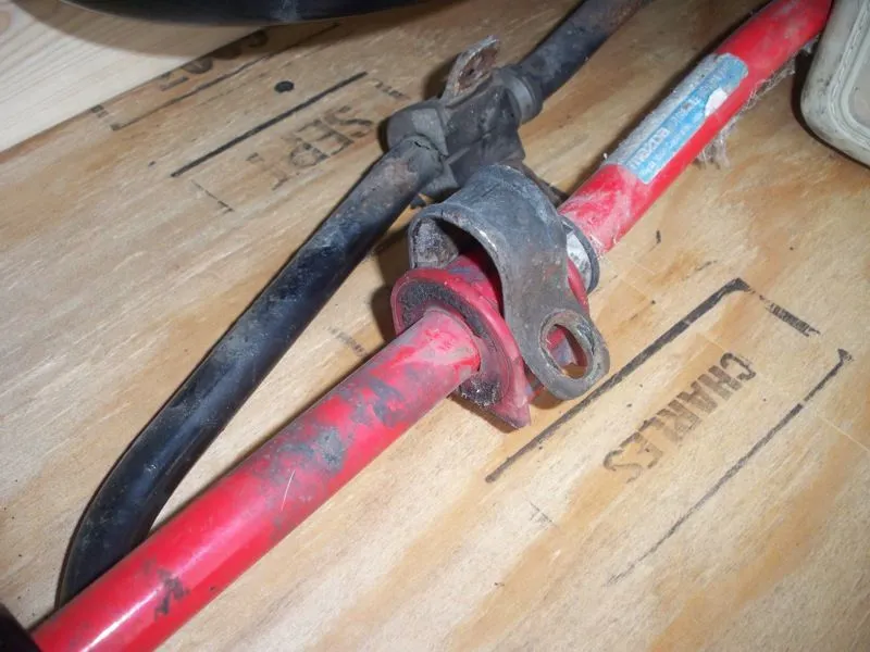

You need the bracket from a MP3/MSP. In the first attached pic, you can see that the stock P5 bracket will not fit over the 20mm AWR bushing. In the second pic, you can see that the MP3/MSP bracket fits over it fine. (Note the second pic is of a DIY clunk fix mount- it is not stock).
I can get better comparison pics tonight, as I have both brackets AND both crossmembers.
Try to find someone parting out an MP3/MSP and get them to sell you the brackets. Only took me a year to find someone... haha... Good luck!

P5 stock bracket on left, MP3/MSP on right (with AWR urethane bushing)
The P5 bushing is clearly smaller- I think it is 17mm, and I know the MSP is 20mm:
Not only is the bracket itself smaller, the mounting holes do NOT line up the same:
The stock P5 crossmember has a both a stud and a threaded hole. The MP3/MSP rear crossmember had two threaded holes:
The stock P5 bracket obviously lines up just fine on the P5 crossmember:
The MP3/MSP bracket will NOT line up fine on the P5 crossmember:
______________
Conclusion-
If you want to use the RacingBeat 20mm sway bar and the AWR 20mm urethane bushings, then you must get the MP3/MSP brackets to use them. In doing so, you must get the MP3/MSP rear crossmember OR get AXR Clunk Fix brackets OR make your own clunk fix brackets.
Obviously, this info is specific to the RacingBeat bar. You can (and should) expect that other vendors would supply the appropriate mounting kits for their sway bars.
