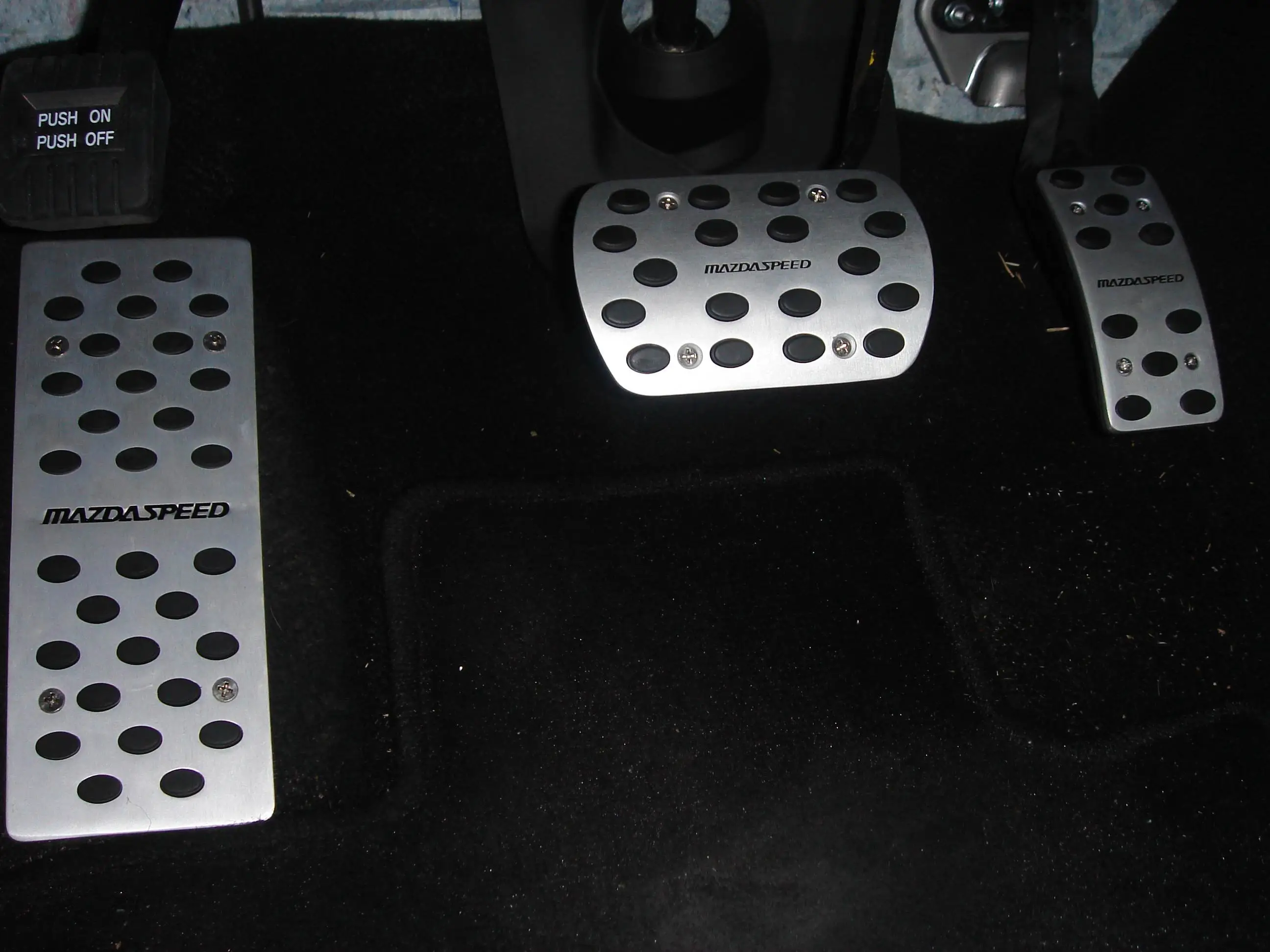

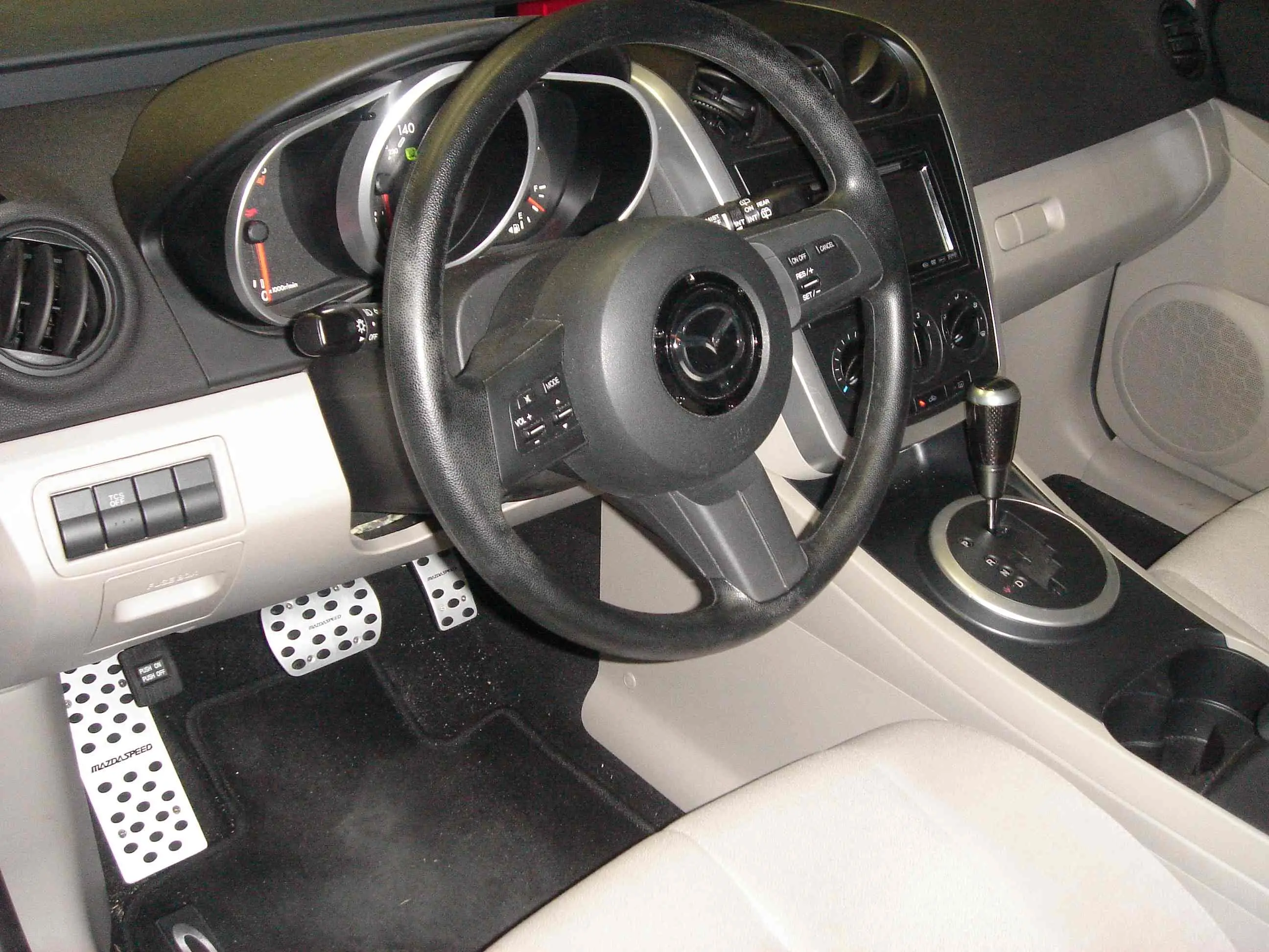

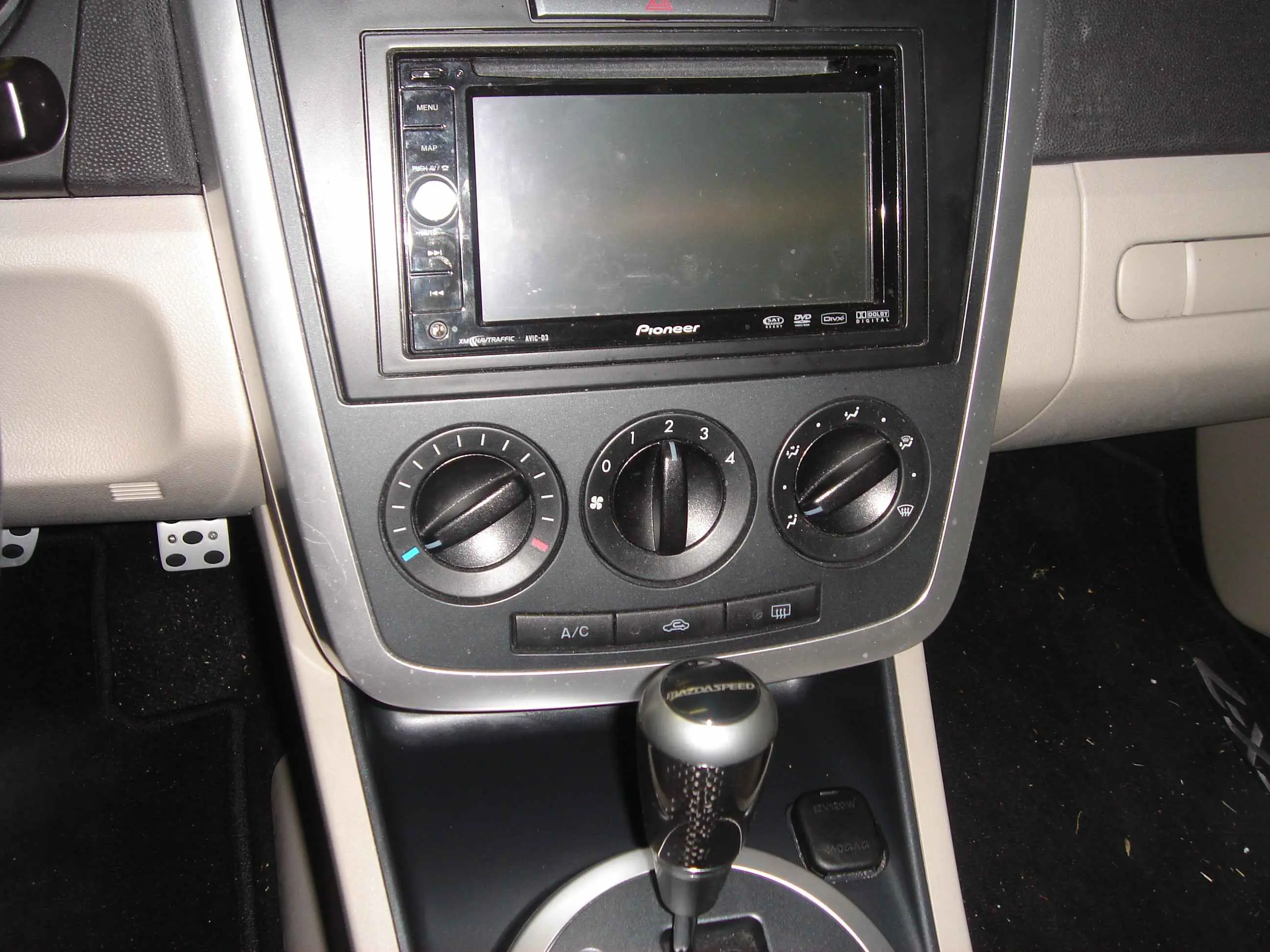

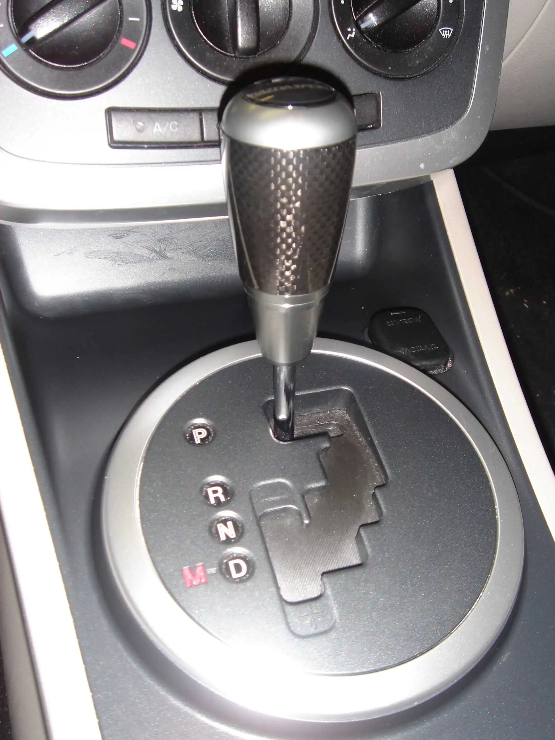

Installed a Mazdaspeed knob made for '06-'08 Miata AT as well as some pedals.

I wondered if those were the ebay pedals, I've been looking at those. Quality is good? How's the install and fit? They look good, I'm very tempted now that I've seen them on the car!
The accelerator and foot rest were easy to install since the provided self-tapping screws can go right through the plastic material. The brake part was kinda a pain cause the screws didn't do the job at all even if the holes were pre-drilled. The screws would require too big of a hole, i don't believe it can be done without going over the edge of the metal brake plate. I ended up buying some smaller #6 bolts and nuts to attach them. Its just as secure, so i'm happy with them.

Could you tell us where you bought the Mazdaspeed shift knob? I'd love to get one as well but haven't been able to locate one anywhere. Thanks!
