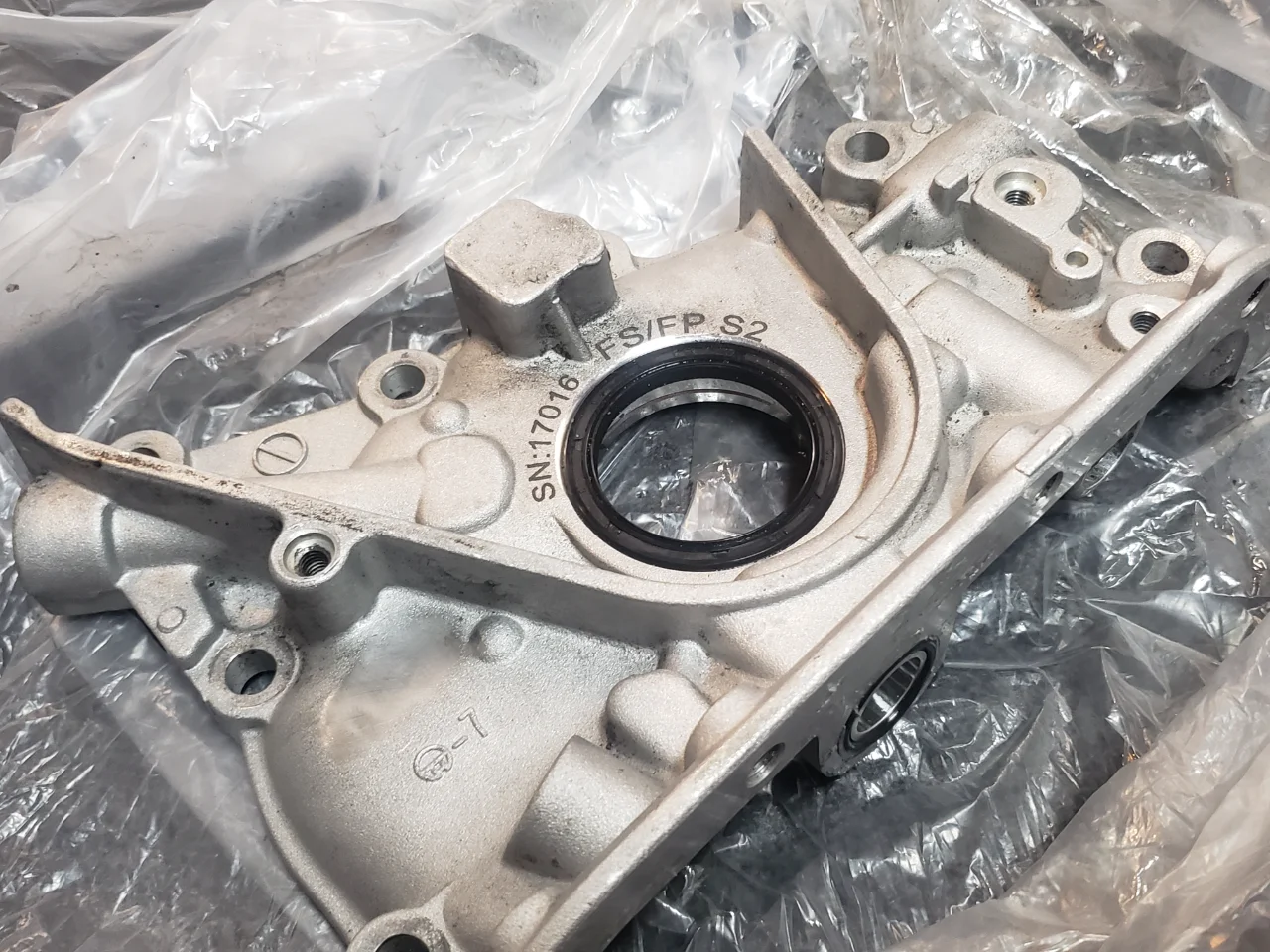

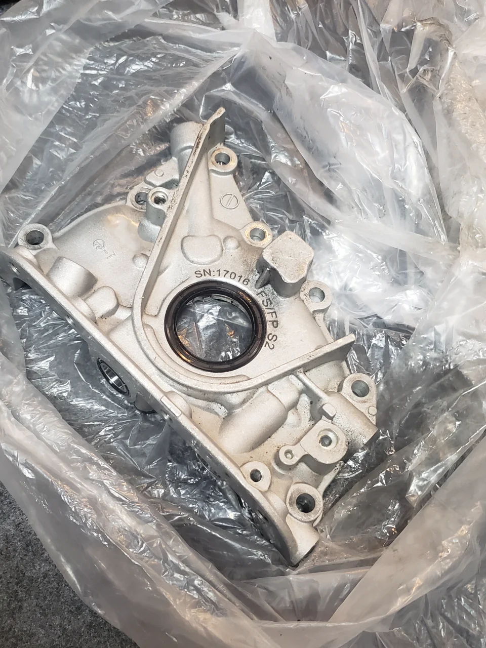

Got a response from Sam on the Boundary Oil pump. Thought I would put it here to help others in the future.
It’s a small operation over there. Not sure the
coating is worth the fee.
You wouldn’t too high is also just as bad as too low pressure.
They increased the redline to like 8k or more, installed a long plumbed remote filter/ oil cooler system that dropped pressure, constant high rpm race use.
I would only run the 60 psi setting on the boundary. Most cars I just use OEM pumps. I installed one with a Boundary on a 60 psi, but that customer never gave me any feedback since I shipped him the engine.
I’ll let you read the ai explanation below, too high is not good either."

That's too much work. Just run an OEM one lol. Has less lines and less failure points. Did you run an OEM one on your mp3 build in the past? Whatever it was, it never gave you any issues did it?
Haha, I think I'll go the Boundary oil pump route at 60psi. Not really sure about running the DOC-B, with all the lines.
I did run the OEM pump on my mp3, I can't really recall having any major issues with it. Maybe some inconsistencies in psi.
I do remember it dipping when accelerating through corners though. Not sure if that was just a oil pan issue.

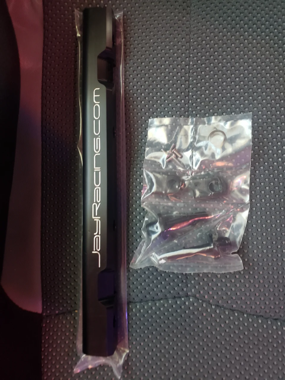

Hopefully Jay Racing emails me back with good news that he found a fuel rail. Said he might have a couple laying around.

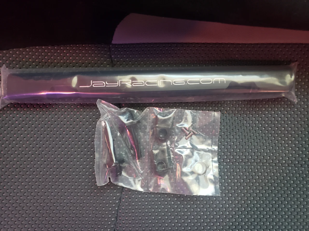

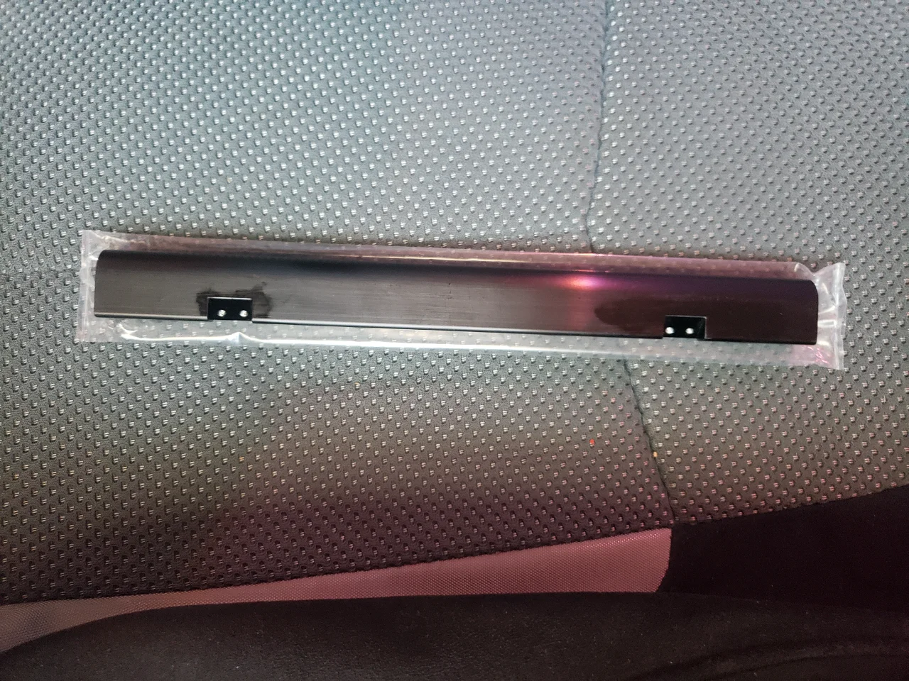

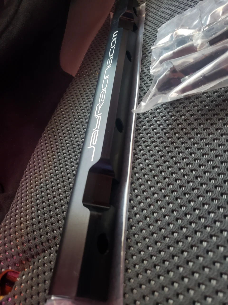

Maaaan, Jay really came through!
Simple email and Bam.
The WRX injectors will work nicely 😁 from yours truly and trusted @323

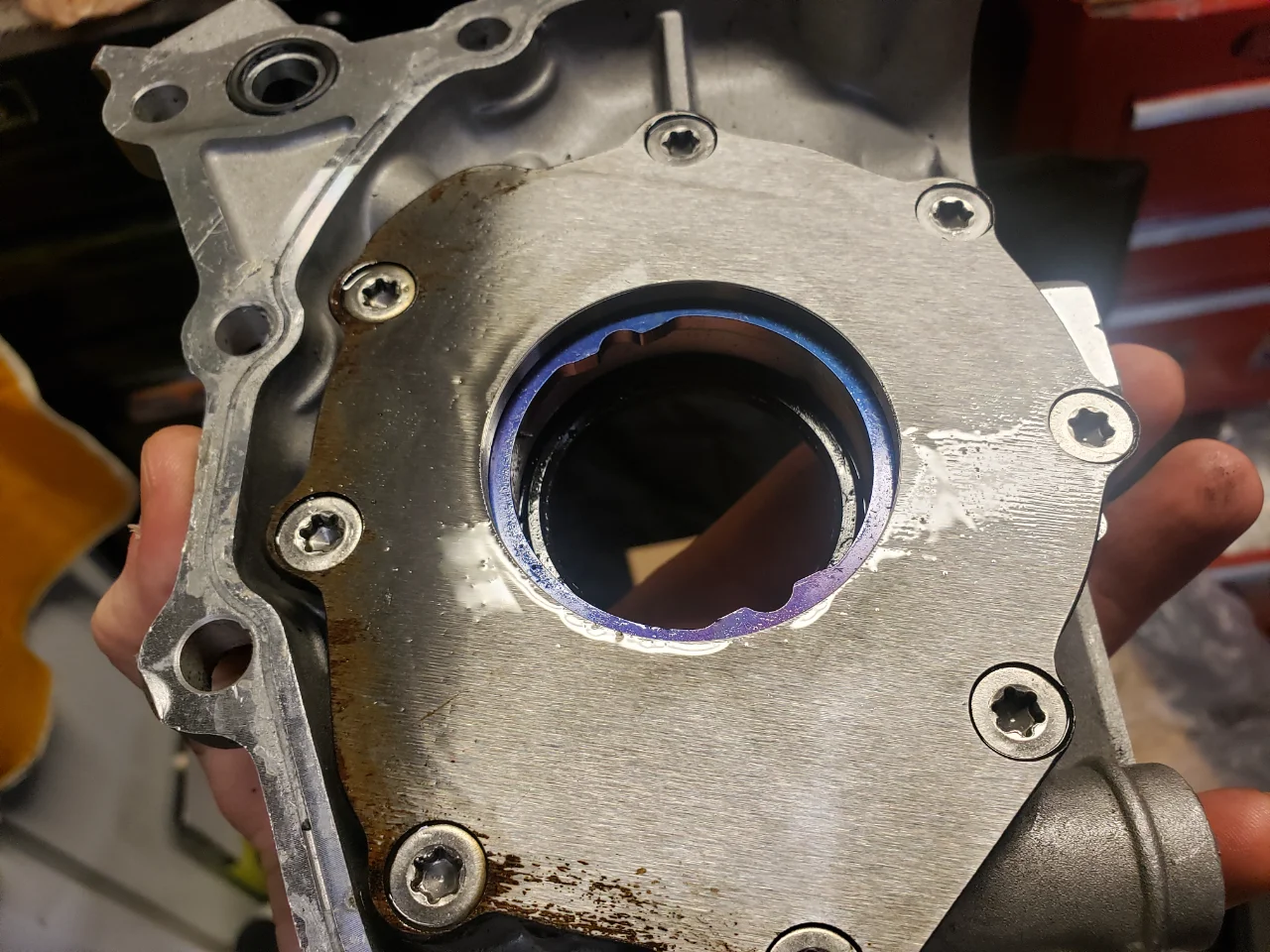

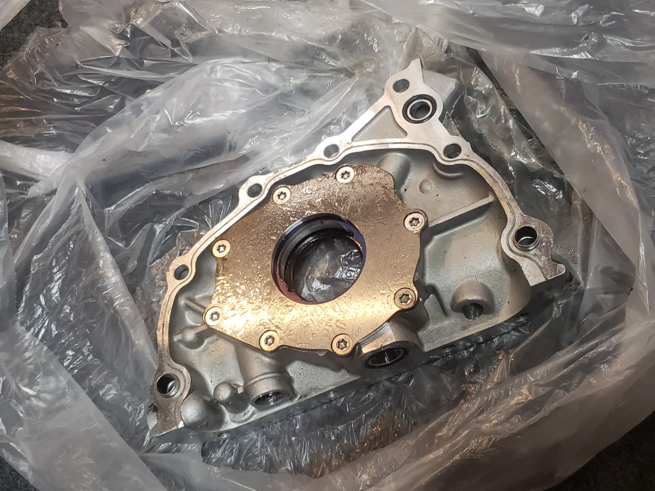

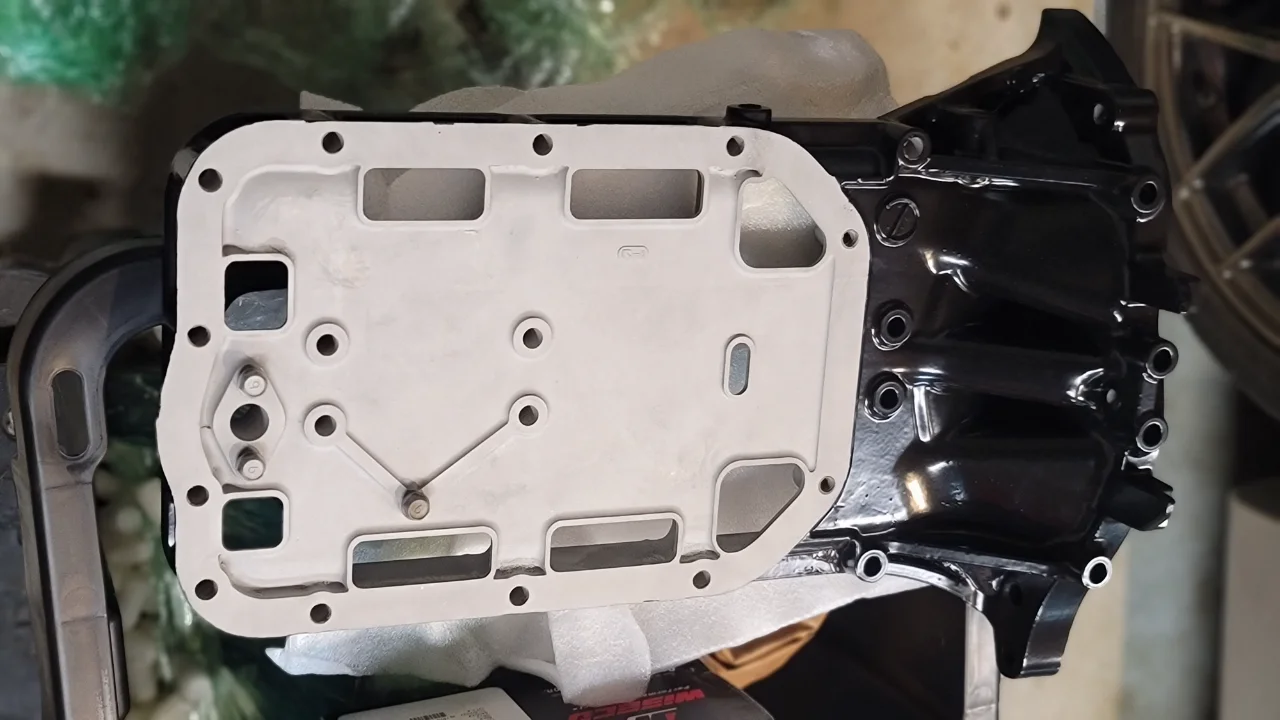

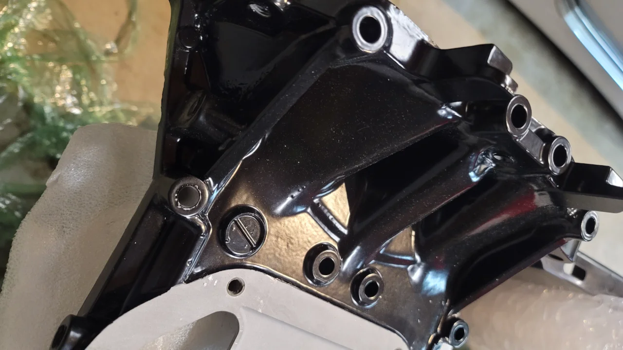

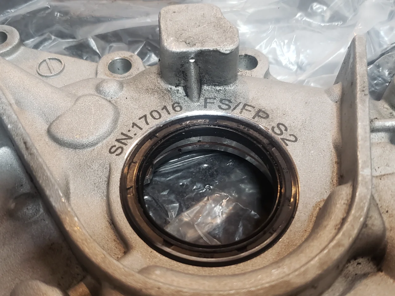

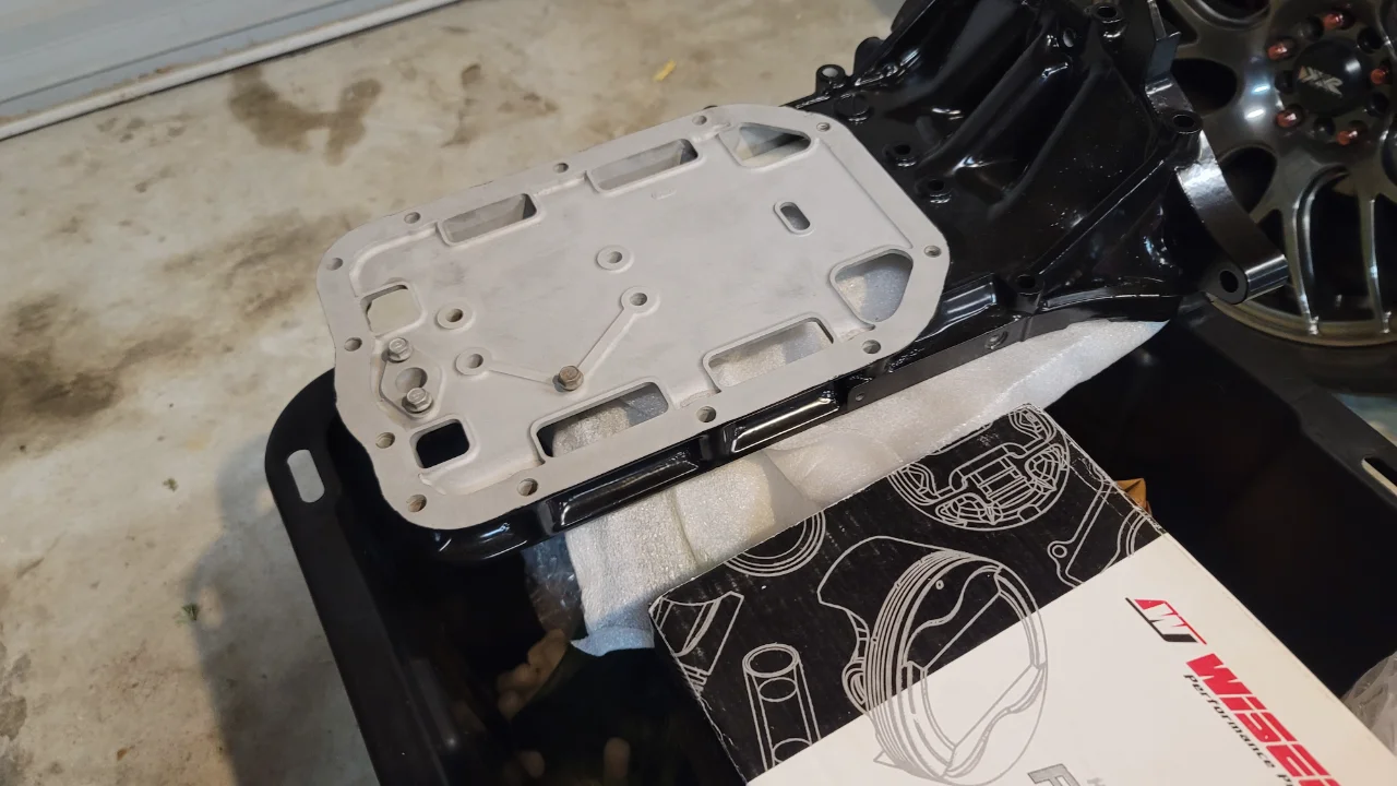

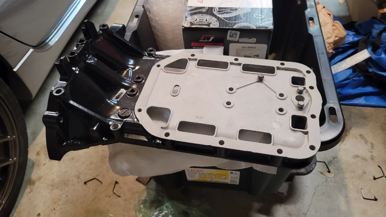

Man oh man, so happy I got this to add to the build. Scooped up this Boundary Pump fast. The gears are also coated. Cleaned her up a bit on the front and backside.

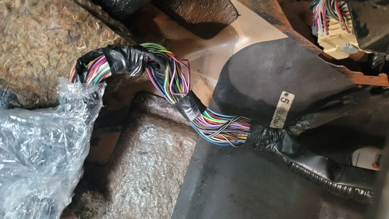

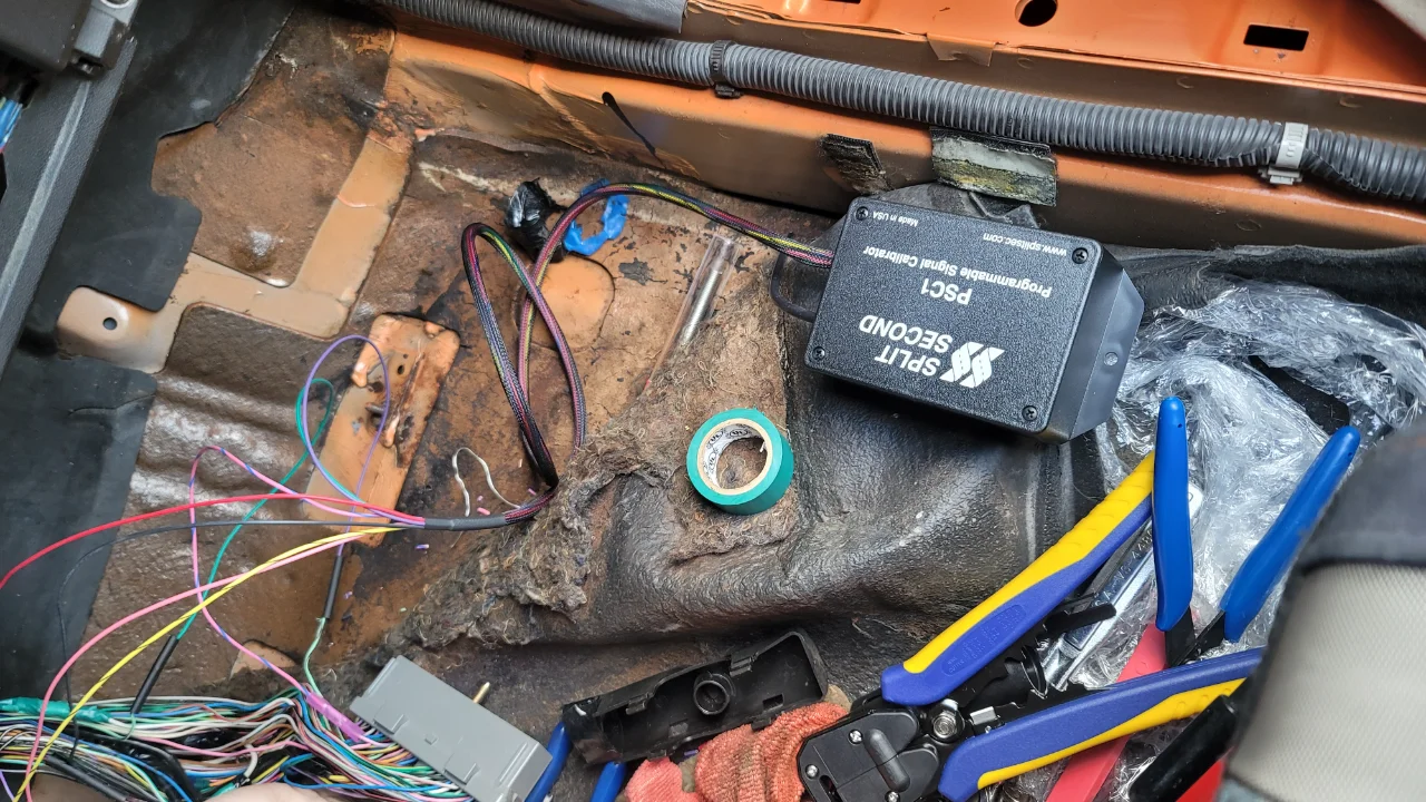

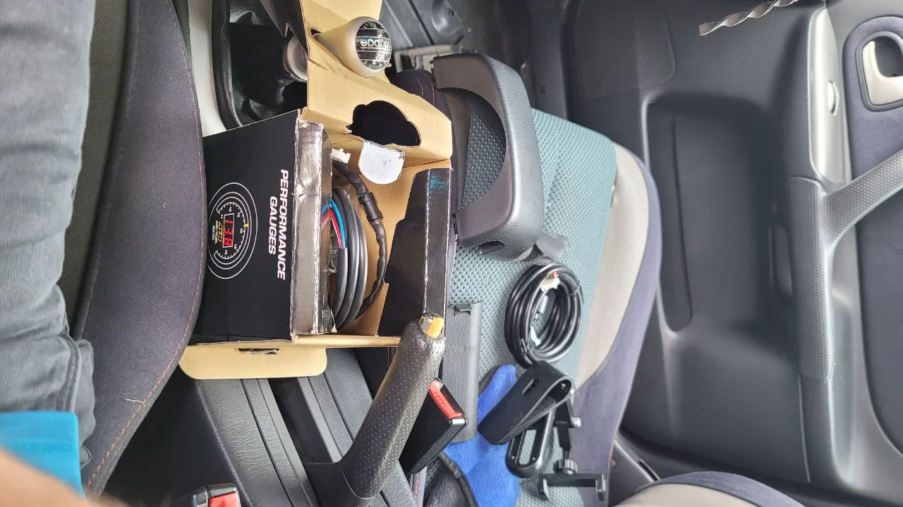

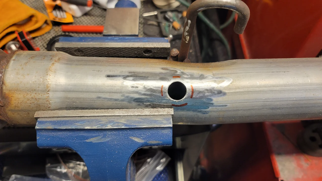

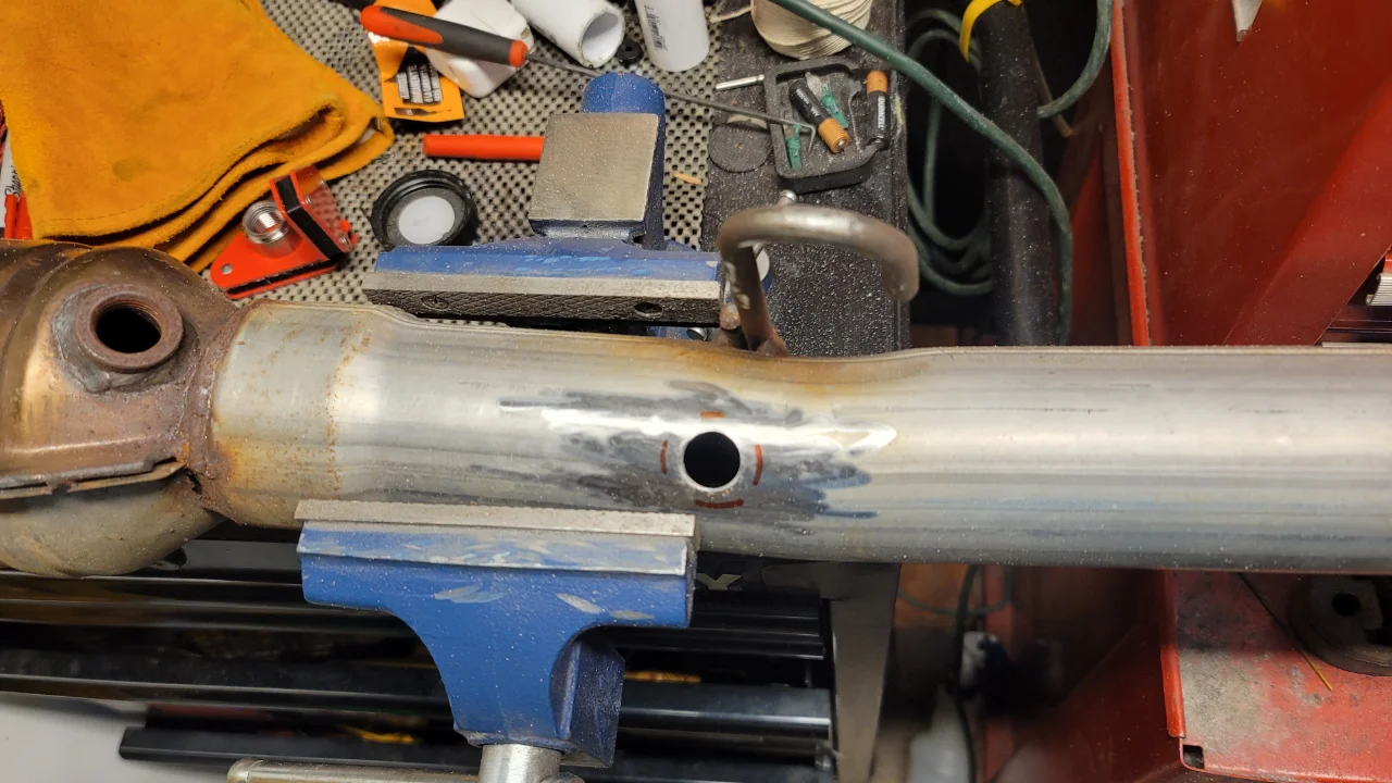

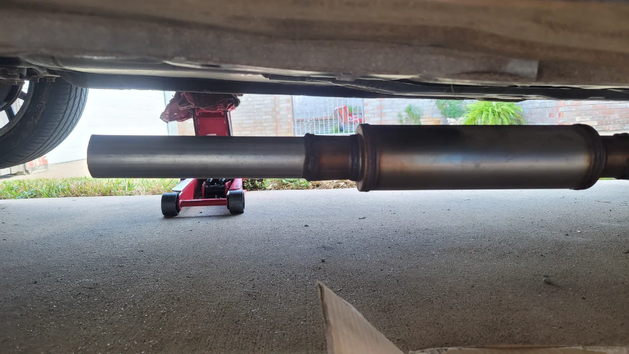

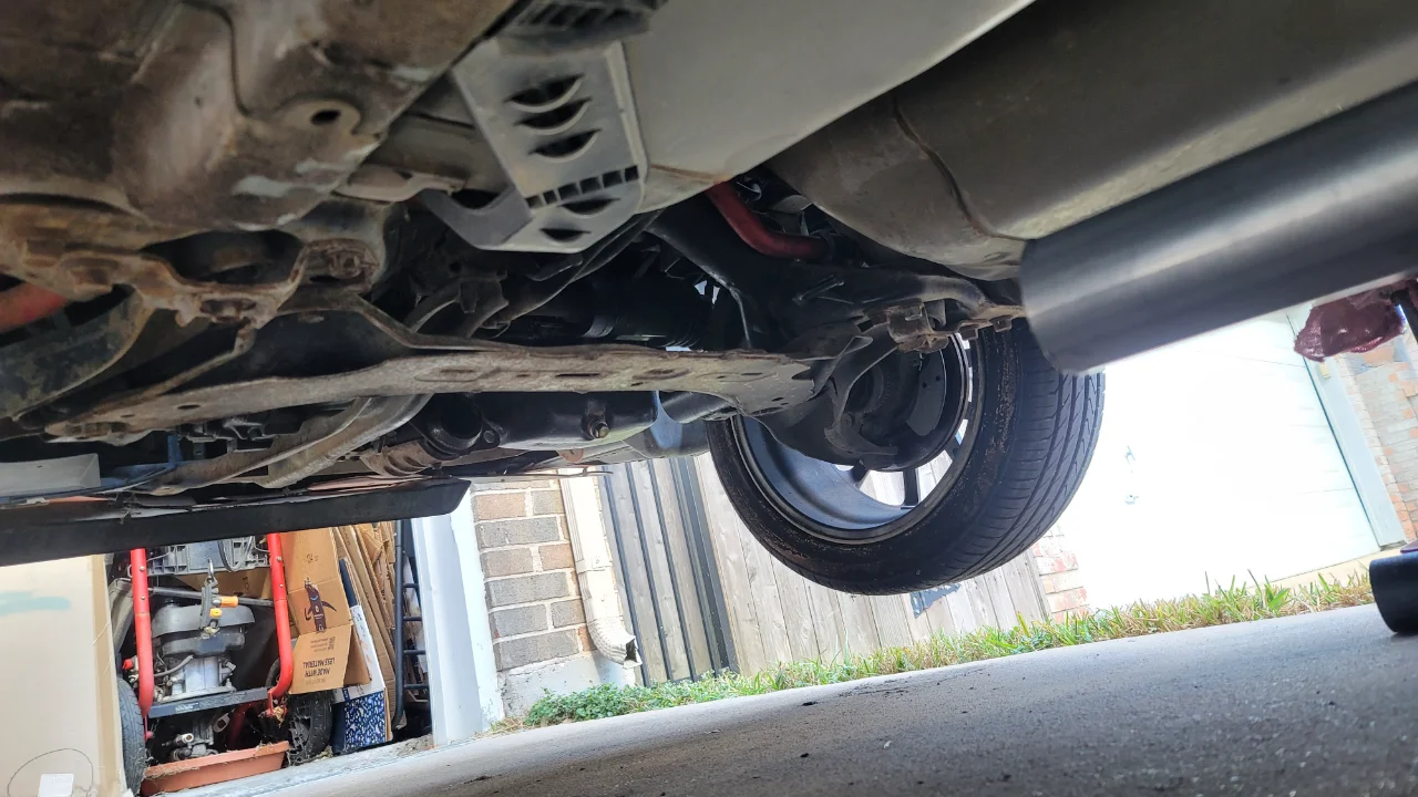

Man… it’s been way too long since my last update. Life has been busy as hell and this build is moving much slower than I ever planned. Definitely thought I’d be further along by now, but here we are.

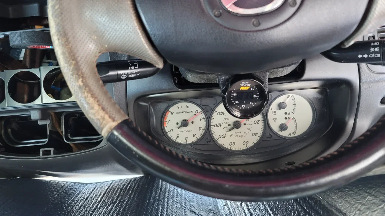

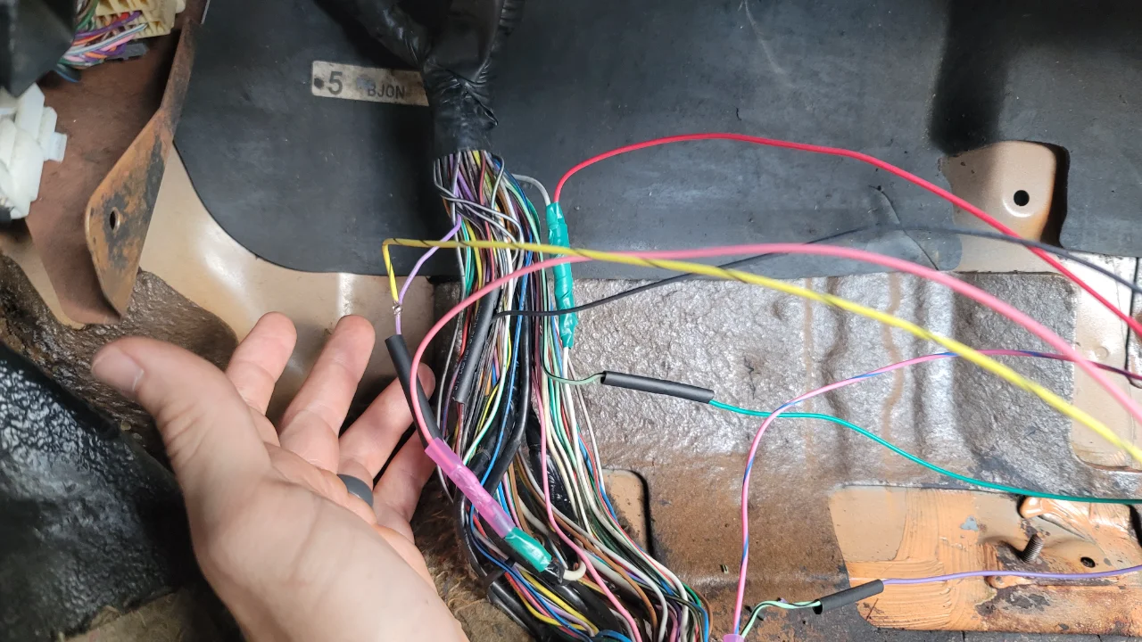

Lately I’ve been bouncing between finishing up the SSAFC wiring and getting the wideband O₂ bung welded into the exhaust. And let me just say, whoever the previous owner let touch this exhaust should not be allowed near a welder ever again.

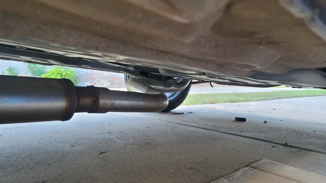

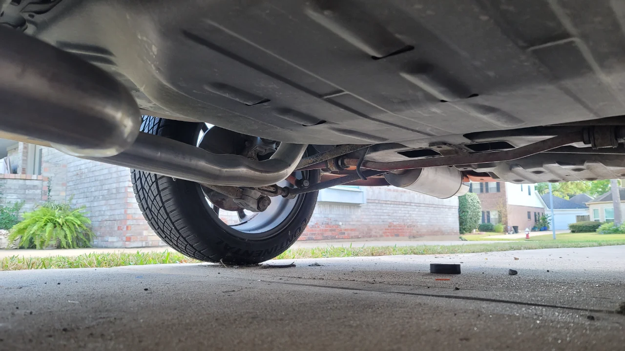

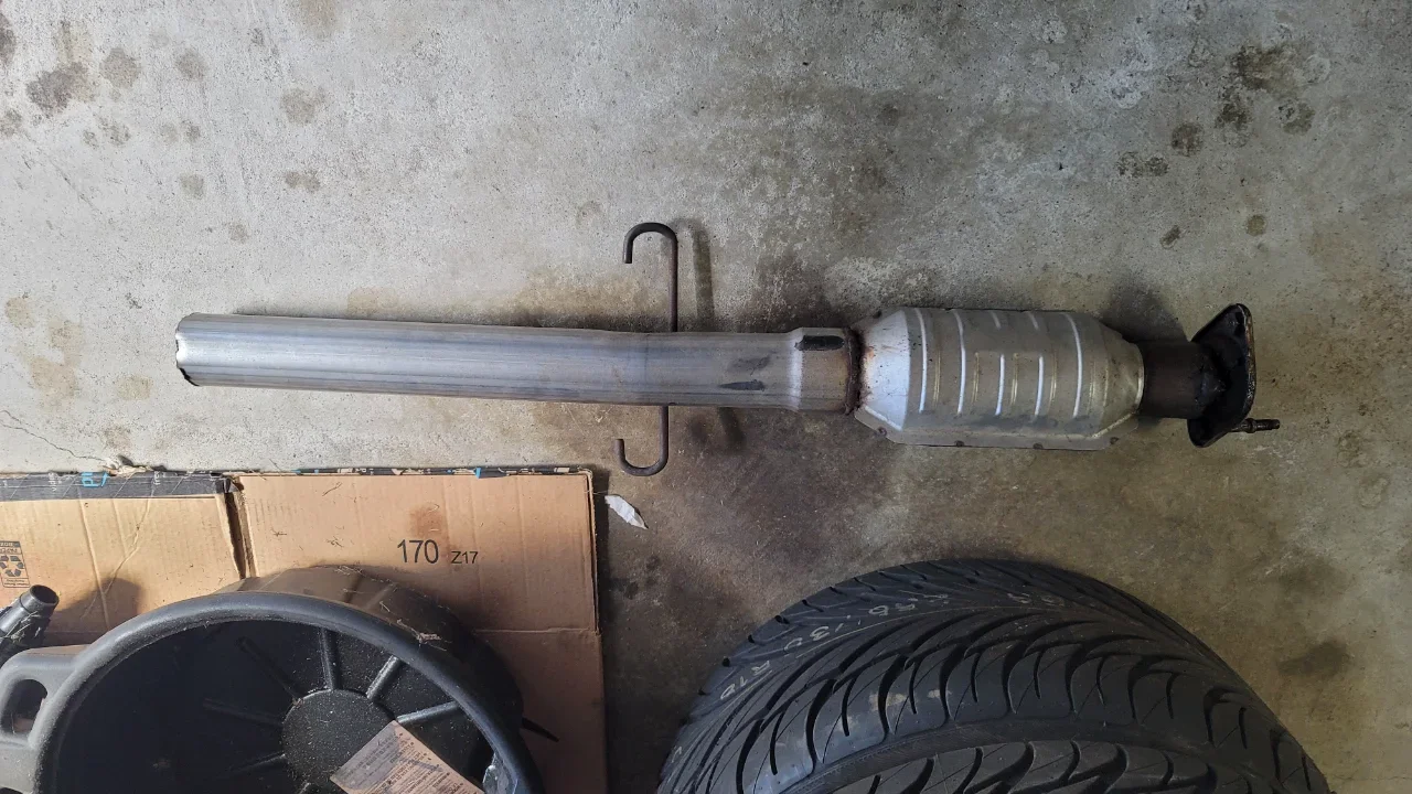

At first I’m thinking, “Cool, I’ll just unbolt it from the front, pop the hanger at the muffler, and slide the whole thing out.” HAHA. Nope. Absolutely not.
Turns out the exhaust shop decided to add their own custom hangers to “support” the aftermarket muffler. And by support, I mean butcher the underside of the car with the most janky hanger setup I’ve seen in a while. Nothing lined up, nothing made sense, and none of it wanted to come out clean.
I fought with it for way longer than I should’ve before finally saying screw it. Out came the grinder. I had to cut those stupid hangers off, and in the end I just cut the exhaust into three separate pieces to get it out from under the car.
Not how I wanted to do it, but sometimes you just gotta accept defeat and start cutting.

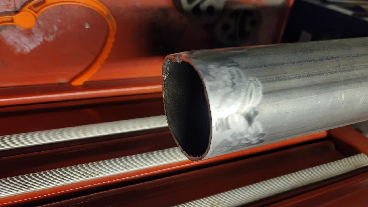

At this point, everything’s prepped to weld the wideband O₂ bung into the exhaust and get that knocked out. Once that’s done and I’m happy with the placement, I’ll finish buttoning up the SSAFC wiring. I don’t want to lock anything in until the wideband setup is 100% solid.
Slow progress, lots of frustration, but it’s moving forward. More updates soon… hopefully with less cutting and fewer swear words.

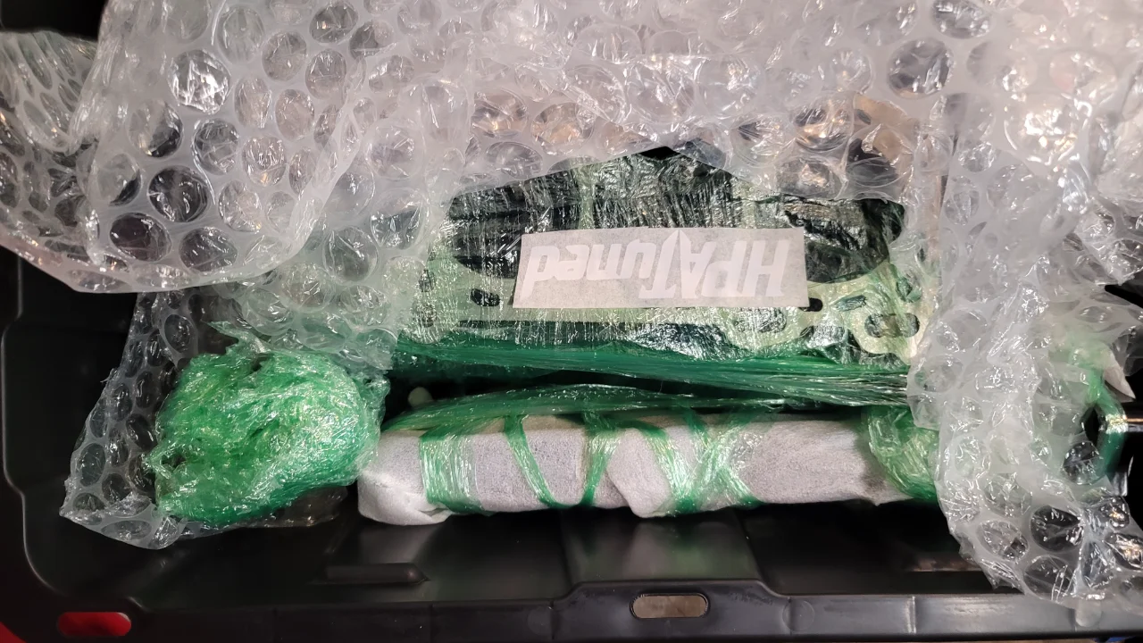

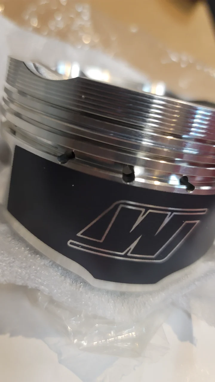

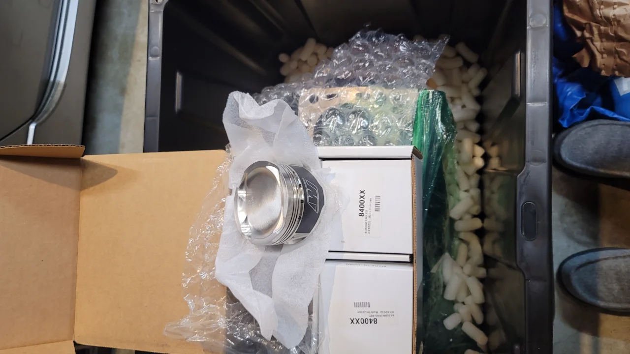

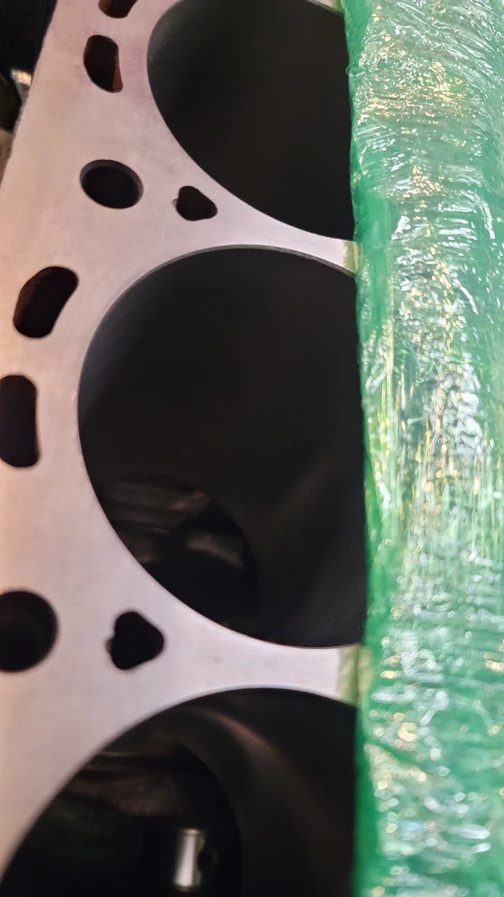

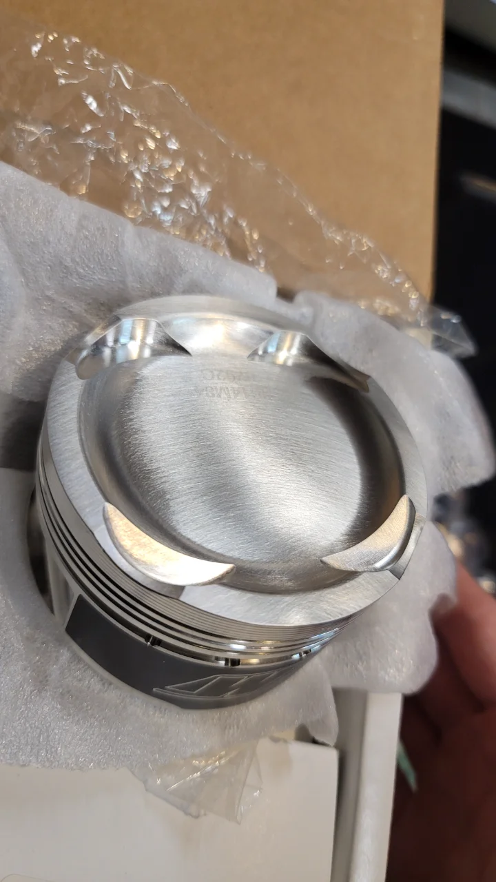

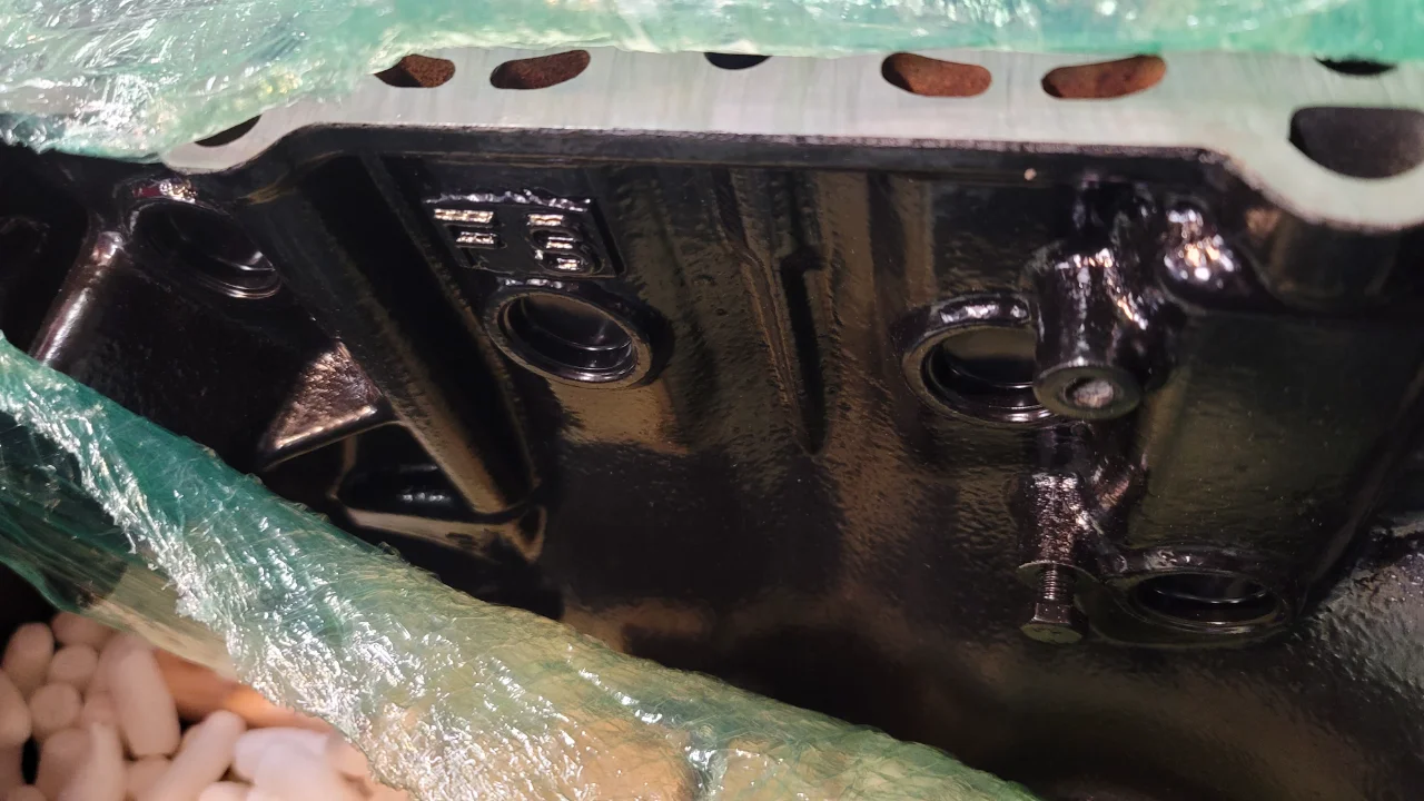

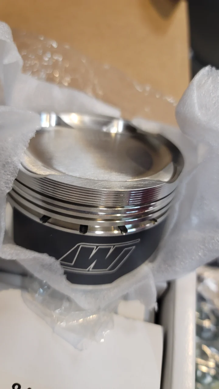

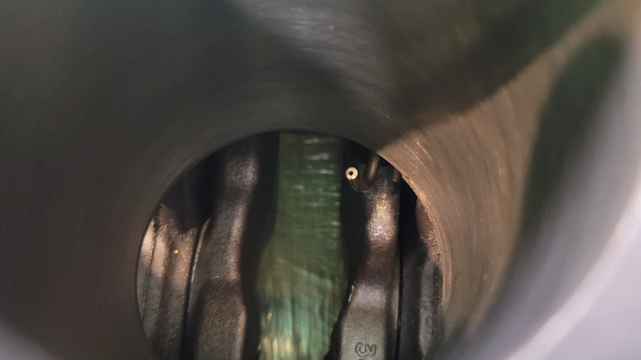

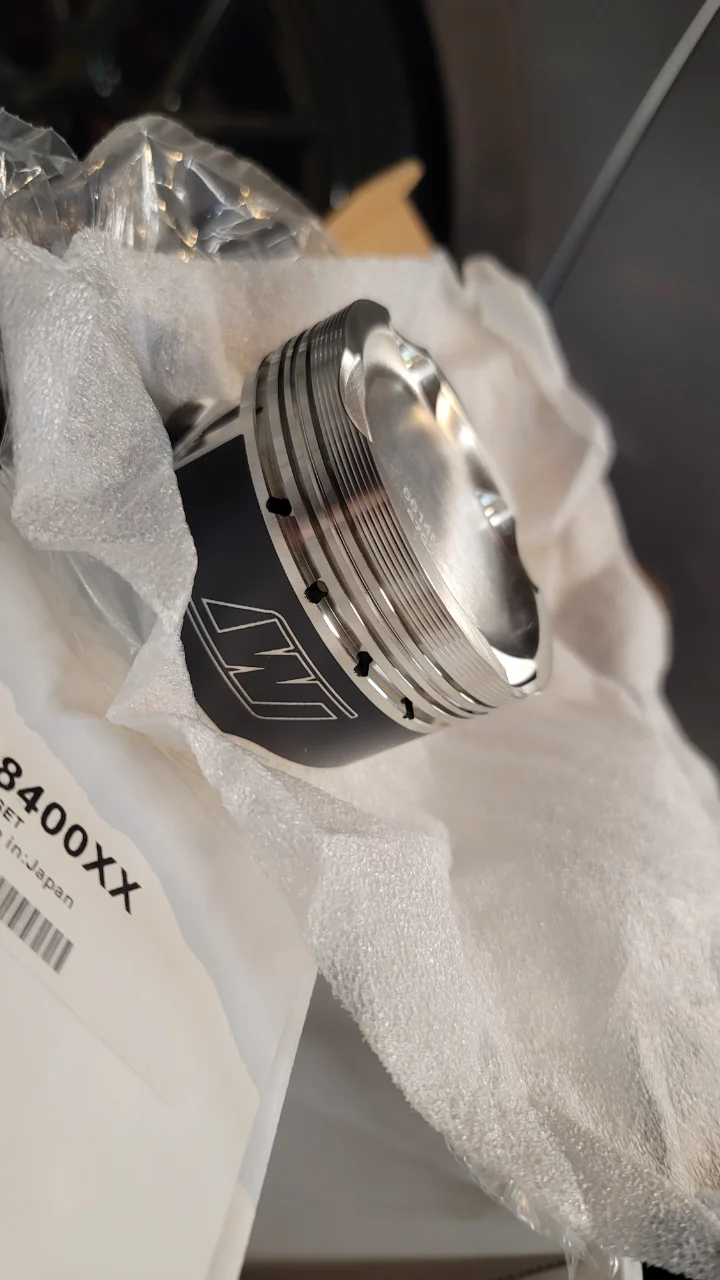

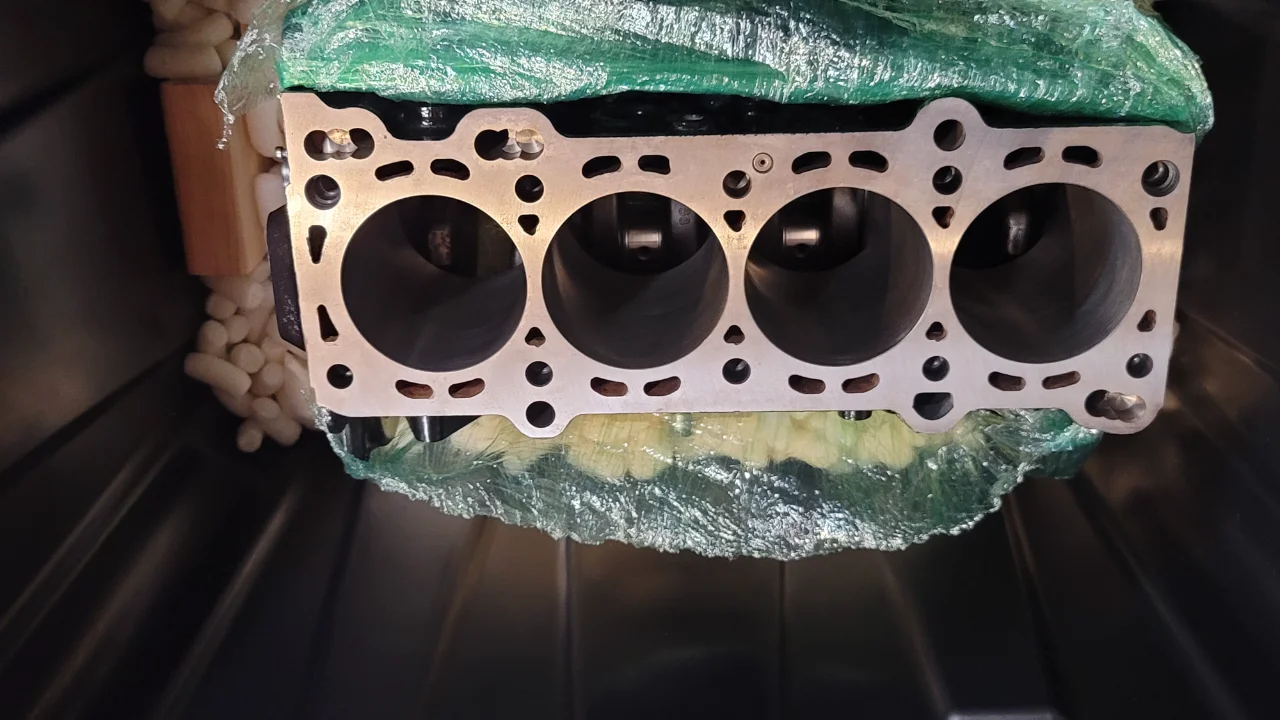

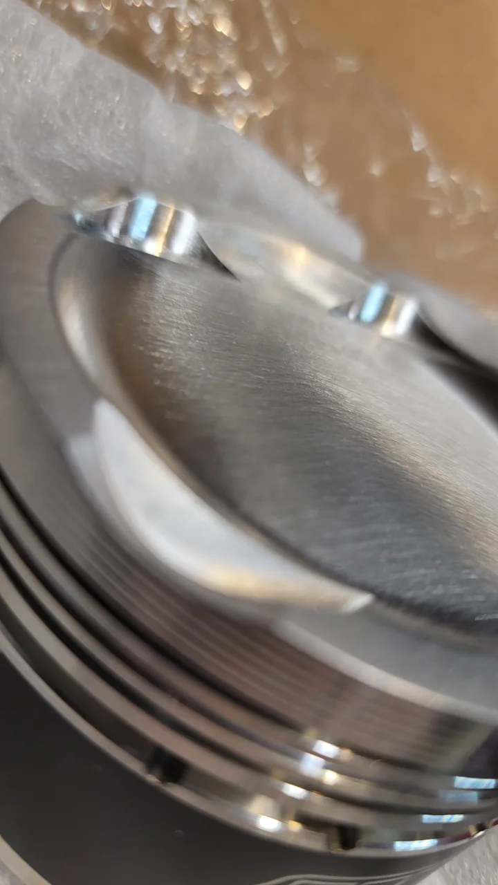

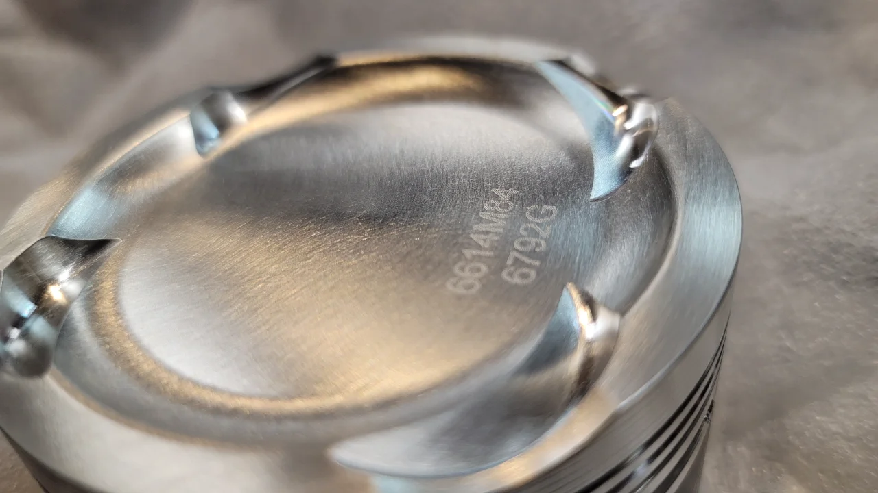

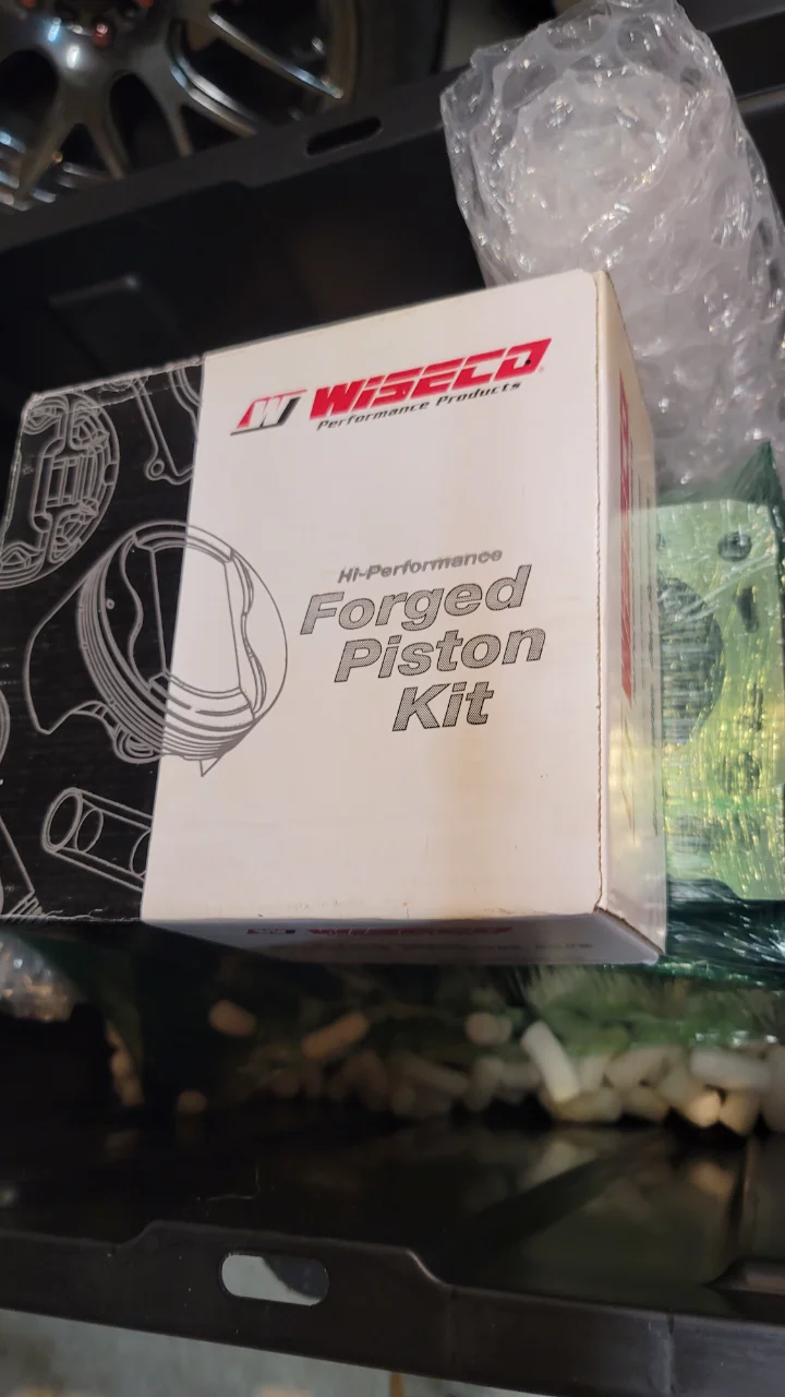

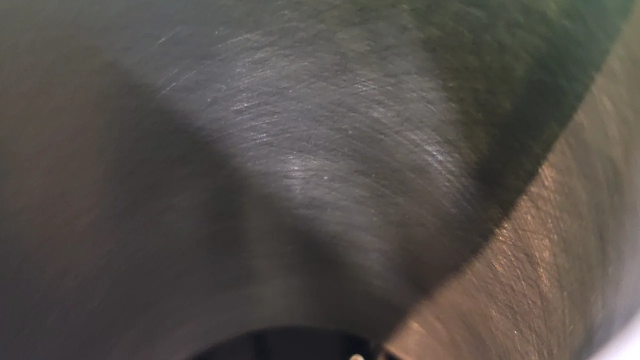

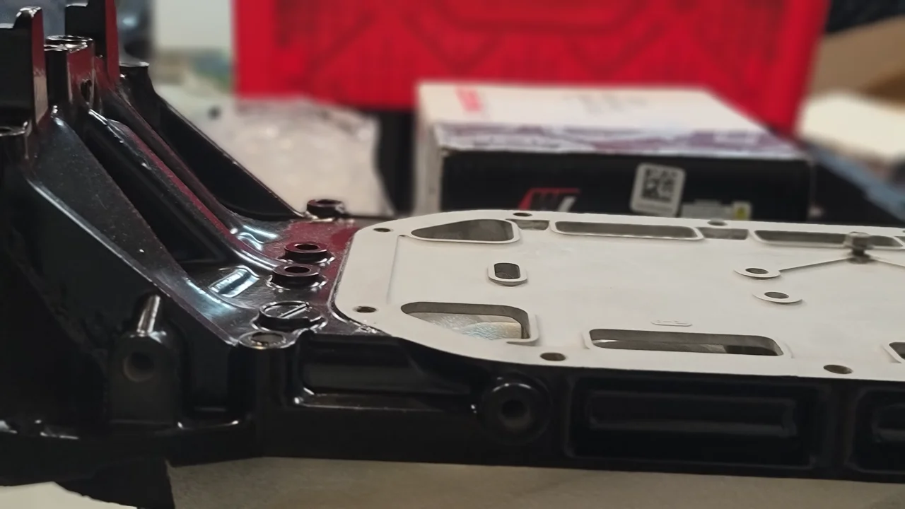

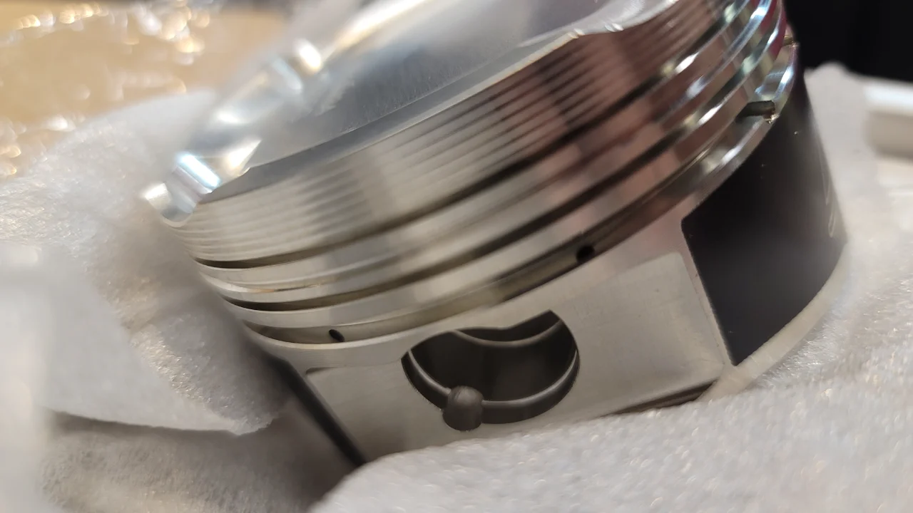

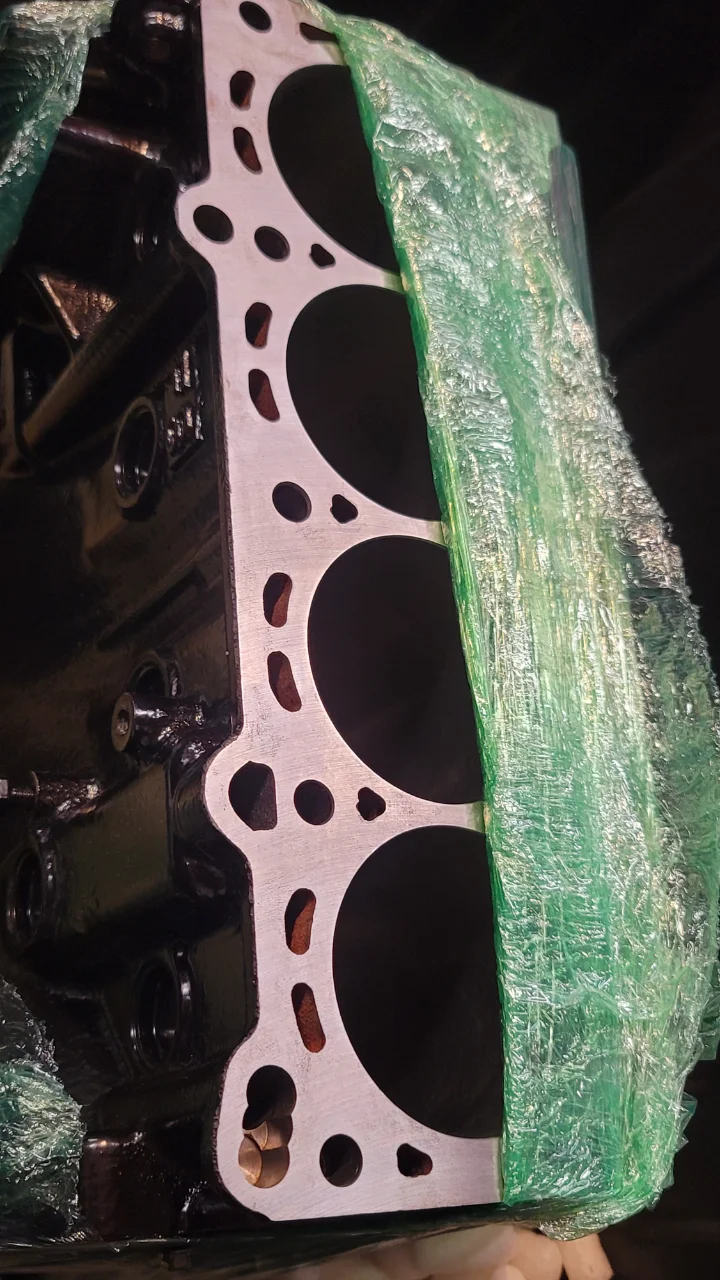

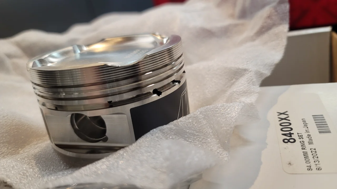

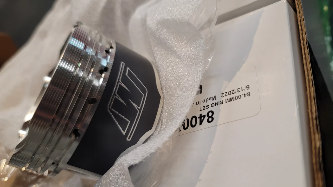

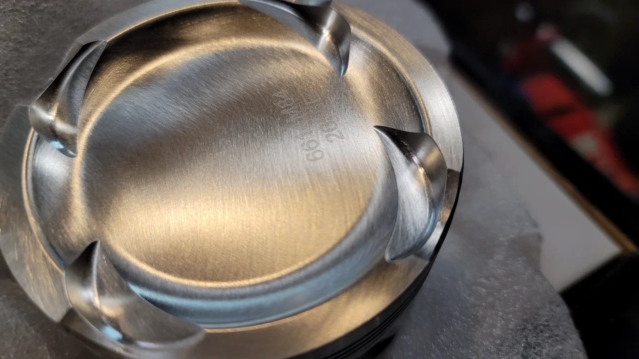

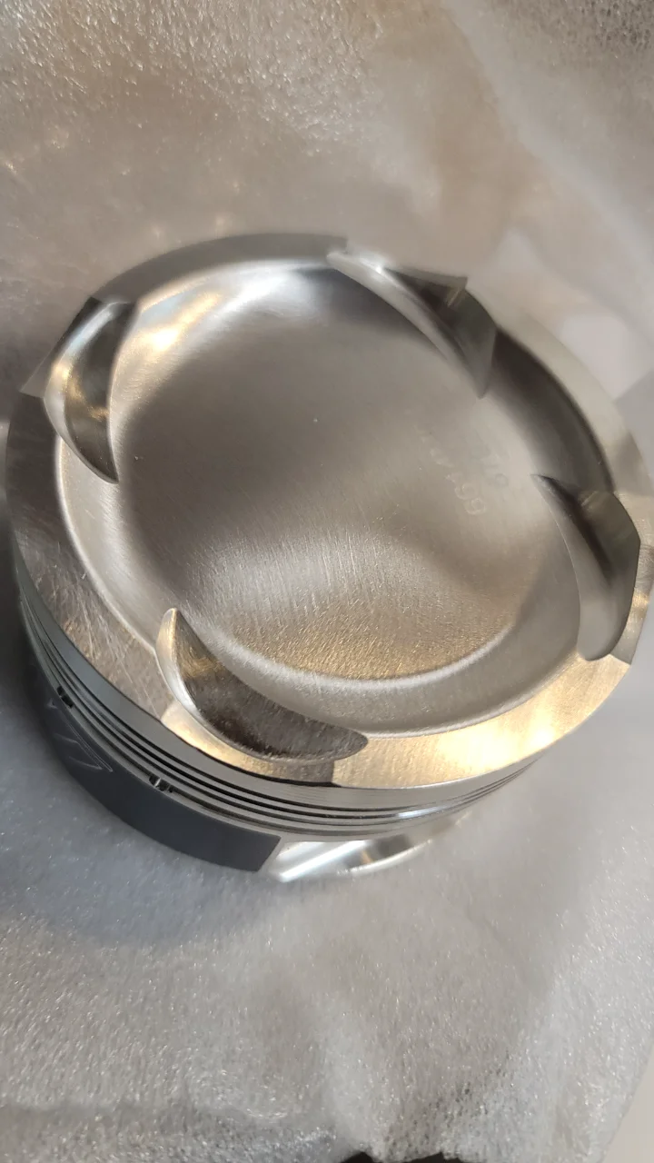

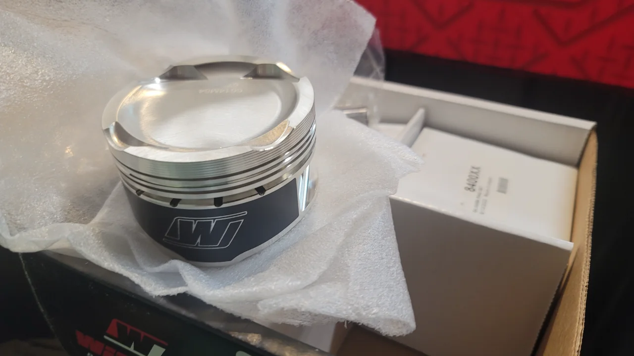

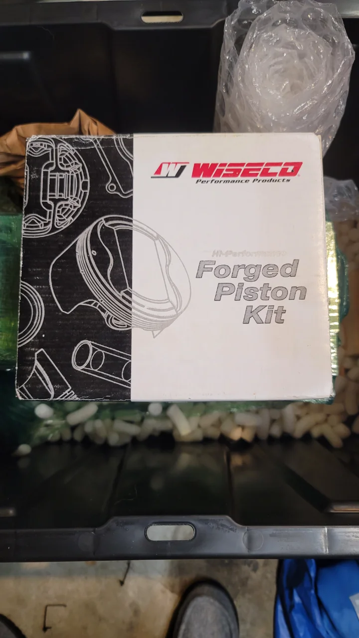

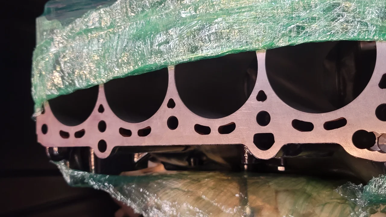

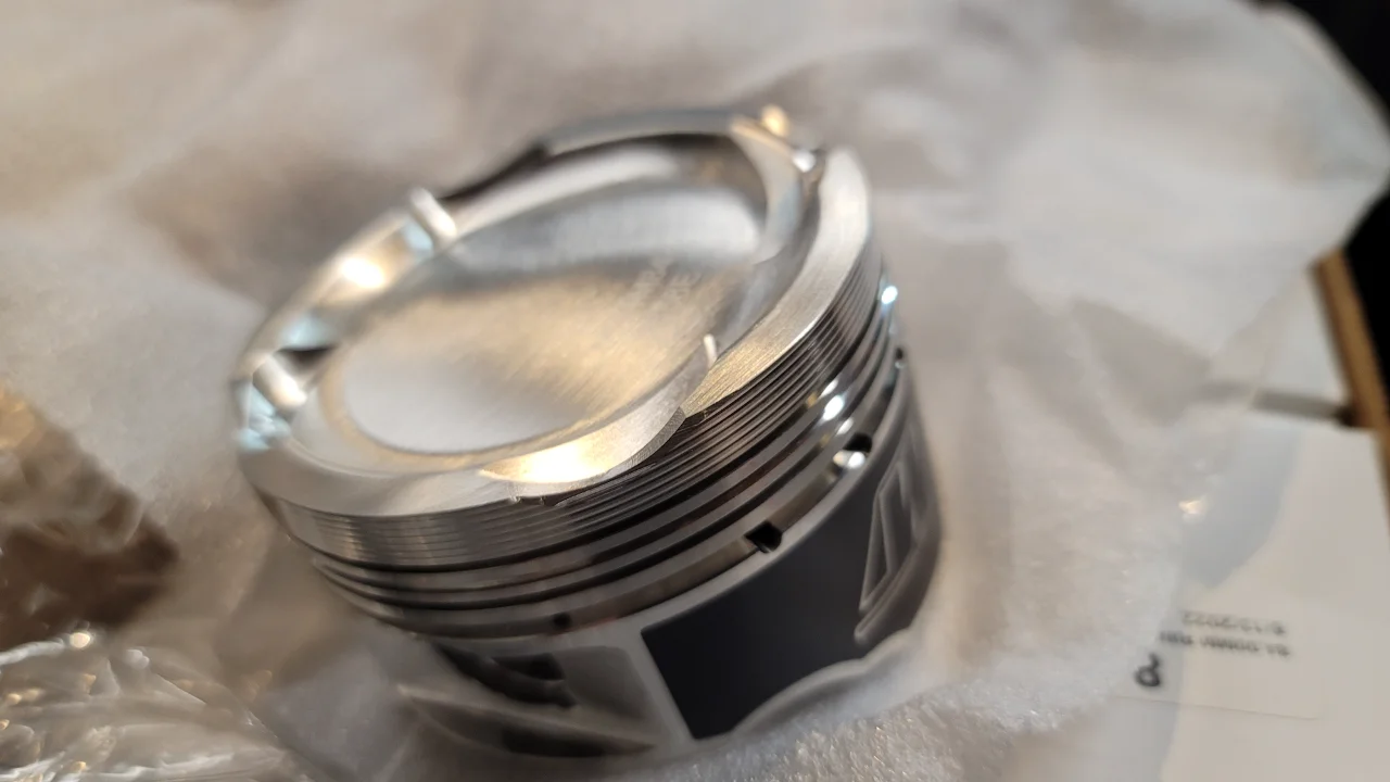

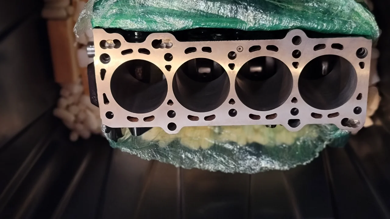

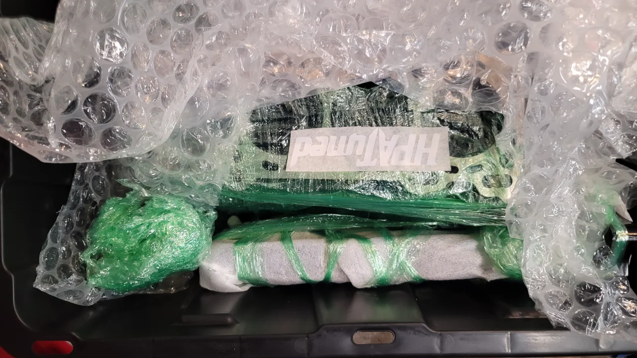

Now for the good news, because this build seriously needed one — I finally pulled the trigger on a ready-to-go short block. Big decision, big purchase, but it feels like the right move instead of rolling the dice on the original block.
Block fully cleaned, checked, and machined Cylinders honed and prepped, New bearings installed (clearances checked and set) Rotating assembly clearanced and verified. Bottom end assembled and ready to build on
It’s not a long block, just a solid, prepped bottom end — which gives me full control over the rest of the setup. No more guessing on the condition of the old block or building around unknown wear. Knowing I’ve got a proper foundation takes a huge mental load off and makes the slow progress feel worth it again.
Still moving slow, still fixing other people’s messes, but the direction finally feels solid again. More updates soon, hopefully with a welded bung, finished SSAFC wiring, and a fresh short block sitting in the garage.
To be continued....

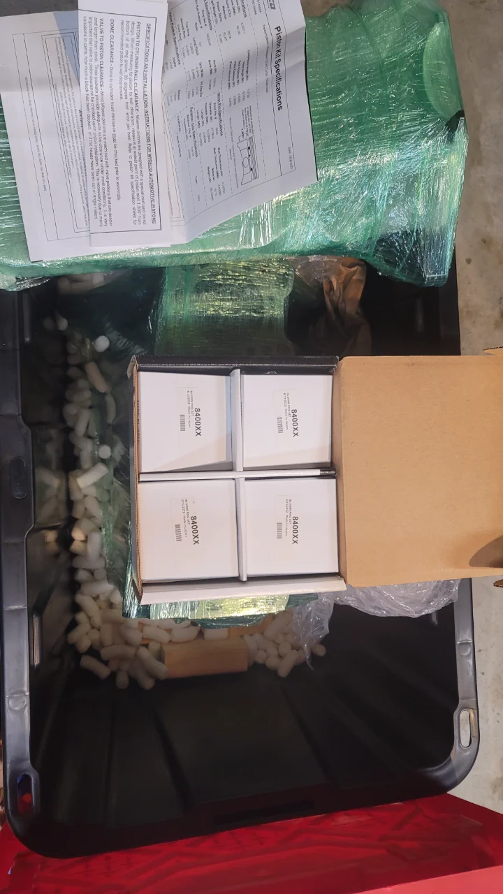

Man… today was a good day. Got myself a birthday present and it showed up, lol.
Fedex just dropped it 30mins early and said peace 😆...I was watching that package like a hawk at work.
Honestly… I couldn’t have found a better person to buy this from.
No games.
No weird energy.
No “trust me bro” machine work.
Everything was documented. Clear. Straight answers to every question.
After all the back and forth, second guessing, researching at 1AM, debating pistons/bearings/bore like my life depended on it… it’s actually sitting in my garage now. 5-Axis CNC work on the block, decking, boring, honing, ect.
• Fresh machine work
• Deck checked and cleaned up
• Line honed mains
• Balanced rotating assembly
• New bearings installed
20260212_193228.webp20260212_193236.webp20260212_194136.webp20260212_194211.webp20260212_194303.webp20260212_194310.webp20260212_194321.webp20260212_194352.webp20260212_194526.webp20260212_194809.webp20260212_194841.webp20260212_195009.webp20260212_195213.webp20260212_195220.webp
Beautiful 😍
Still got wiring to finish. Still need to finish cleaning up the exhaust situation (don’t even get me started). Still mocking up a few things before final assembly.
I can’t wait to get this bad mamer jammer up on the engine stand and really go through it.

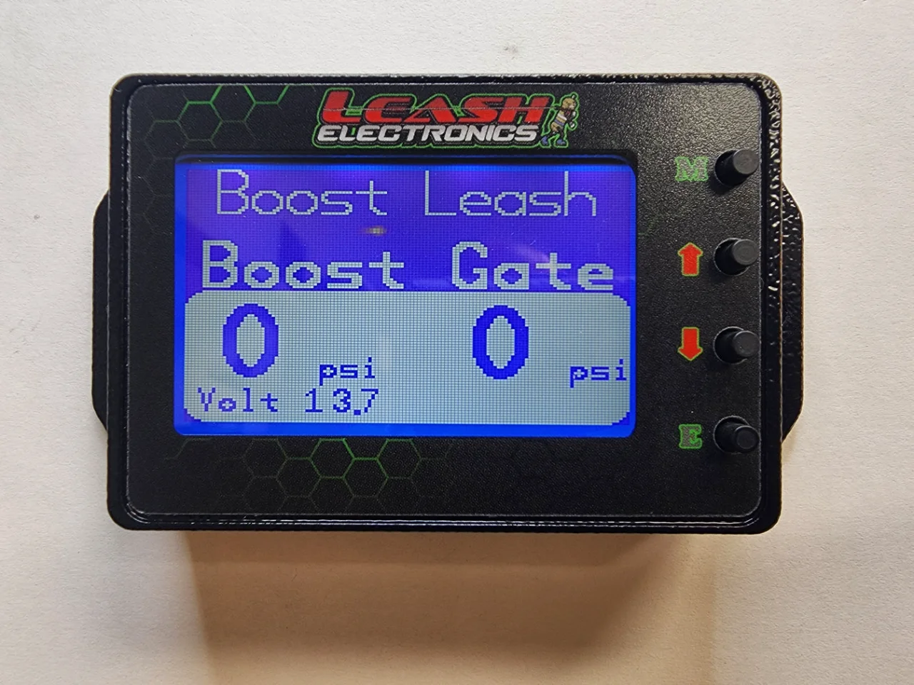

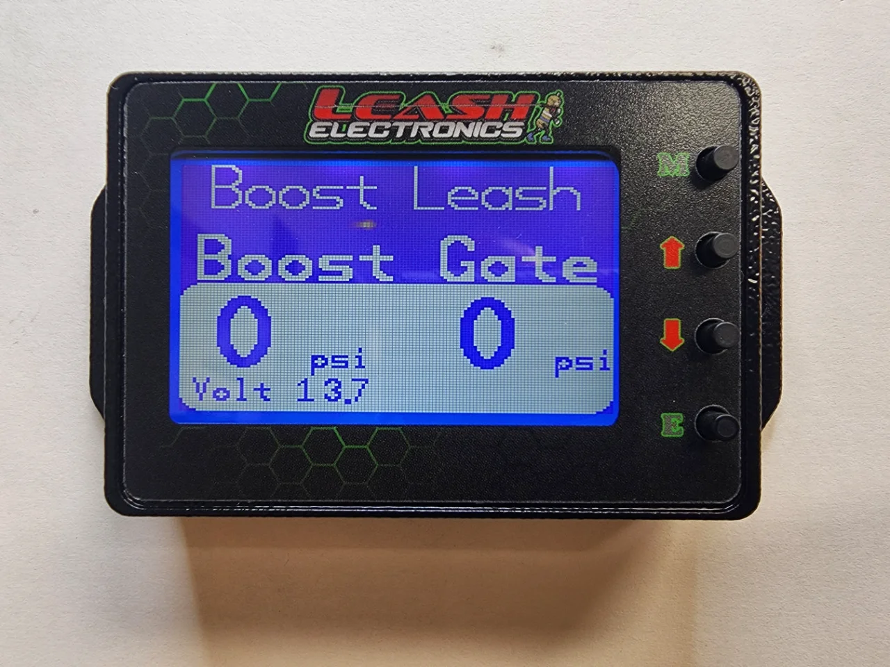

Boost Controller Decision – Greddy vs Boost Leash​
Alright, this is going to be a long one. I’ve been really thinking through boost control on this build, and I figured I’d write it out instead of just bouncing ideas around in my own head. Maybe it helps someone else going down the same path.
The setup for reference:
  • Built 84mm bottom end
  • GT2860RS, .86 A/R, T25, 5-bolt
  • Goal is around 300–325whp
  • Street car, spirited driving
  • G-series trans (double synchros + LSD planned)
It’s not a drag build. I’m not chasing peak numbers. I just want smooth, reliable power that doesn’t shock the drivetrain — something that feels strong but controlled and makes the car genuinely fun to drive.
That’s where the boost controller decision really came into focus.
What I’m Really Trying to Control​
It’s torque hit.
At 300hp, it’s not just about power, it’s about how it’s delivered.
That’s part of why I decided to go with the .86 A/R housing. It’ll help smooth out spool compared to a .64. But even with that, housing alone doesn’t control torque shock, how boost ramps in still makes a big difference.
I came across the Greddy Controller​
Pros:
  • Simple.
  • Clean interface.
  • Set target, adjust gain, done.
  • Proven forever.
It’s straightforward. You dial in your boost level and tune around it. honestly, part of me likes that simplicity.
Boost Leash​
It’s more technical. More adjustable. Less “set it and forget it.”
But what it offers is actual ramp control — meaning I can control how quickly boost builds, not just where it lands.
That’s huge ( Donald Trump Voice ) 🤣
Instead of boost hitting like a hammer at 3k, it can build in progressively. That’s less shock to the G-series. Less sudden torque spike. More linear pull. For what I’m building, that’s attractive.
Where I’m Leaning​
I’m intentionally trying to soften torque hit and build something that feels refined instead of aggressive, the Boost Leash makes more sense on paper.
It gives me:
  • Controlled ramp
  • Gear-sensitive options
  • More precision over how boost comes in
That aligns with my build.
The Goal​
GT2860RS .86 A/R
0.5 bar actuator
Conservative base boost
Controlled electronic ramp
I want the car to feel:
  • Strong
  • Predictable
  • Linear
  • Smooth through the gears
Not really explosive.
If I can keep it around 300–325 with a clean boost curve, I think the transmission will live a much happier life.
I'd think that with the lsd you're planning and a good clutch the transmission shouldn't be that wet noodle you're thinking may break.
What lsd are you going with?
I chose the Quaife lsd modified by Bisimoto to work with the Veloster R-Spec Turbo 6 speed for my now pulled the plug build.
Your turbo and build looks similar to what I was looking for with 300whp and has my interest.
Are you planning on going with a stand alone setup for your ecu?
I thought about that too but found a Turbo ecu that actually works in the car with much diligence to finding it.
Simple harness changes for the fuel rails and engine harness would've been all that's needed which I did get ahold of.
But seeing that all that has to ripped out and a new harness installed I kept thinking standalone and build my own harness as needed.
Expense comes to mind and my wallet was crying enough to halt everything.
You have a better grasp on what your wanting and longevity seems to be the goal as well.
Going this route takes much planning ahead.
Good thread going here.
Man I appreciate that.
I agree, with a good LSD and clutch the trans shouldn’t be the wet noodle people make it out to be. I just know these G-series boxes don’t love shock load, so I’m trying to build around smooth torque instead of just sending it. Maybe I’m overthinking it a little, but I want to know that if something ever does let go, I did everything reasonable to prevent it.

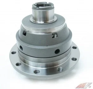

I’m leaning toward the MFactory helical right now. I went back and forth with Quaife for a while, but for my goals I think the MFactory will be more than enough and keeps the build balanced. Unless I find out there’s a real-world reason the Quaife is significantly better, I don’t see a need to overspend there.
I was looking hard at the double cone synchro conversions for 1–2 and 3–4. On paper they’re great — smoother high RPM shifts and better durability if you’re really beating on it. But the more I thought about it, that upgrade seems to benefit guys who are power shifting, drag launching, or abusing the car more than I plan to. I’m still on the fence, but I may just freshen everything up with new OEM parts and call it good.
As far as ECU, I’m sticking with the stock ECU + SSAFC for now. Standalone is still a maybe-later situation. I’ve definitely thought about it, especially once you start talking cams and head work, but I’m trying not to escalate the build past what it needs to be.
Appreciate the input, definitely trying to plan this one the right way.

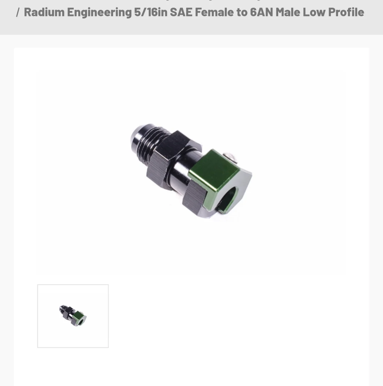

Fuel System Plan – Return Style Conversion w/ Jay Racing Rail
Since I did the whole post about my thought process on Boost Controllers  and how I decided. I thought I would put this here also. Keeps the thread alive and keeps me planning and buying parts.
Since I’m running the Jay Racing rail (threaded ports) and already have 440cc injectors, I decided to convert the system to a true adjustable return-style setup instead of trying to adapt the OEM regulator.
Clean AN plumbing in the bay
Adjustable base pressure
Easy injector upgrades later (550cc / 650cc if I go bigger turbo and standalone)
Proper boost-referenced 1:1 fuel pressure rise
This keeps me in the 300–320whp range safely, but doesn’t box me in later.
Layout Plan (Simple & Clean)
Feed Line Flow:
Hardline from tank (5/16")
→ 5/16" SAE female quick-connect to -6AN adapter
→ -6AN line
→ Fuel Rail inlet
→ Rail outlet
→ -6AN line
→ External adjustable FPR (boost referenced)
→ FPR return port
→ 5/16" quick-connect adapter
→ Factory return hardline
No need to run AN all the way to the tank. Everything stays clean in the engine bay.
Parts List (Planned)
Jay Racing fuel rail (threaded ports)
WRX 440cc injectors (already owned)
External adjustable FPR (Radium / Aeromotive style)
(2) 5/16" SAE female quick-connect → -6AN adapters (I will measure the Female side again keep seeing 3/8 for the Female side)
-6AN PTFE hose (feed + return)
-6AN hose ends (straight / 90° TBD once mocked up)
-6 ORB to -6AN fittings for rail
Electronic in-cabin fuel pressure gauge
Upgraded fuel pump
Pump relay wiring upgrade
Why External FPR Instead of OEM Rail Regulator?
The OEM regulator mounts directly on the stock rail.
The Jay Racing rail is threaded on both ends and does not accept the stock regulator.
Rather than hack something together, I’m doing it properly.
