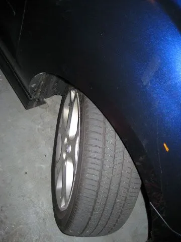

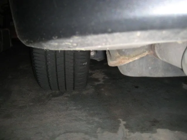

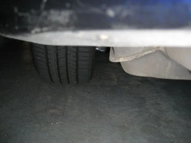

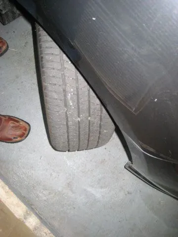

And yeah, as everybody has said, performance is the main cause of the negative camber on the rear tires it seems, but regular rotation should do as mentioned earlier. I took some pictures of mine the other day to compare. Tires are rotated every service (5000mi or around 8000kms). The first 2 thumbnails are from the 06 (~20k miles) and the 3rd and 4th ones are from the 08 (~6K miles).
I want the change the 06 ones, but still look like they have some extra miles to go...

You can see it (rear wheel neg. camber) pretty well here on my old 3. The 3 I took a beating on in trading it in to get a 5 for the wife. If my wife hadnt just got a lease on her 3i I woulda been alot happier but oh well, ill overcompensate with a 67 fastback when the kids are grown.
