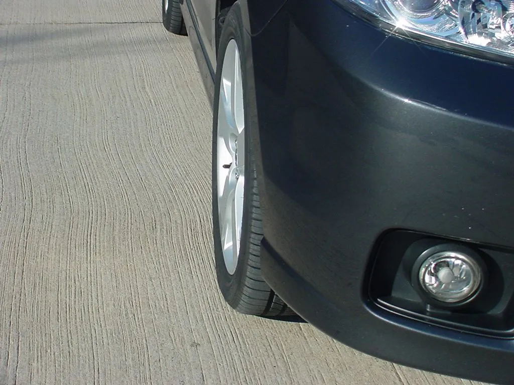

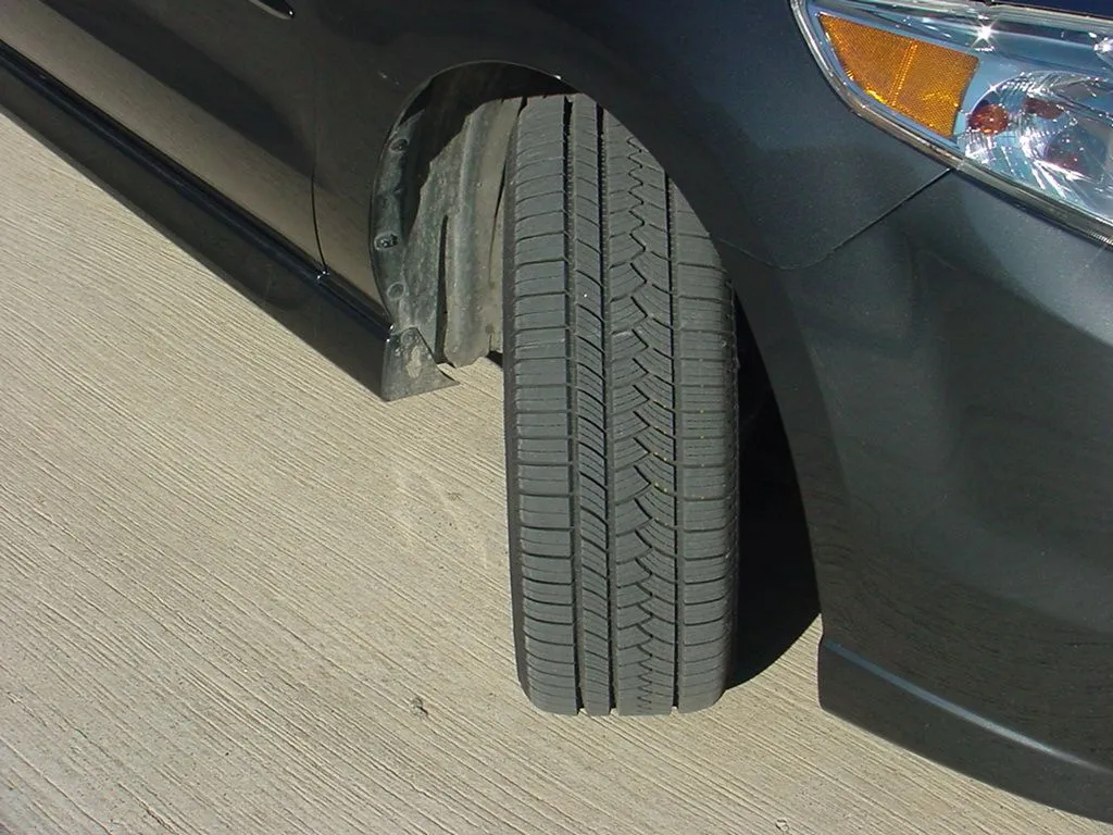

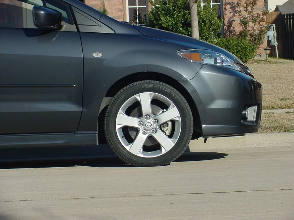

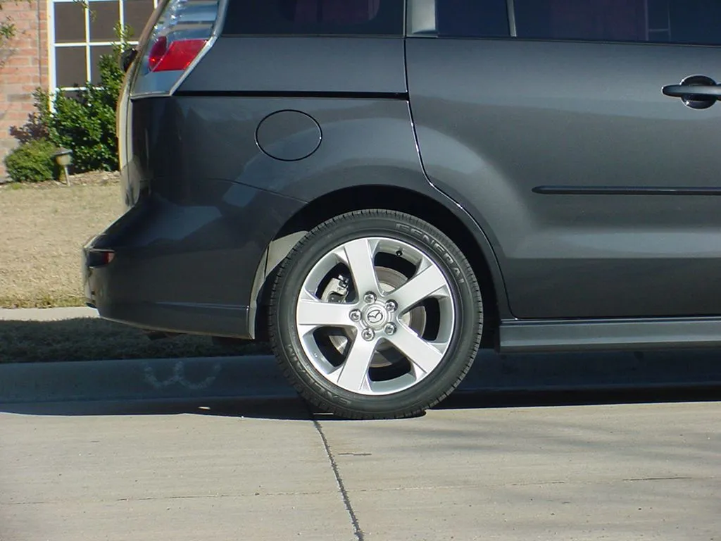

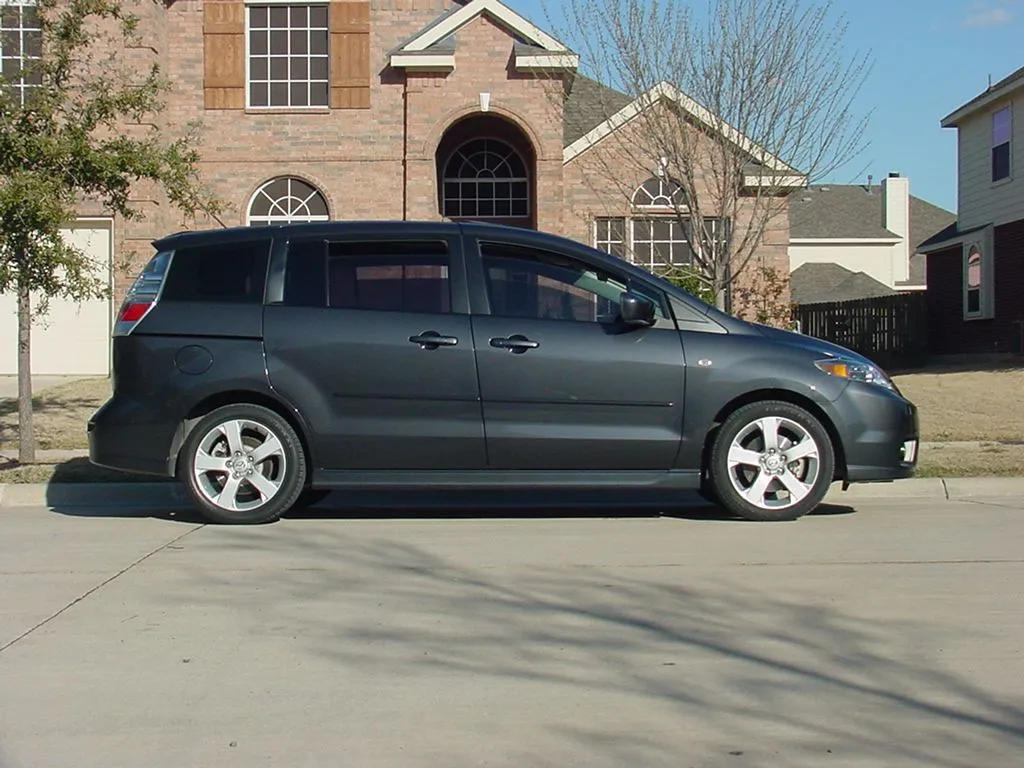

I bought some General Exclaim 215/50/17s from www.tires-easy.com and had them installed today.
I figured I'd post some pics to show fitment just in case someone else was wanting to go with this size.
IMHO, this is the size that should have come on the car. I forgot to look at the tach to compare before/after rpms at 70mph, but I think they should be pretty close. The tire is about 1cm taller diameter than the stock one.
Back to the online tire purchase. I ordered these and recieved them in 6 days. Discount Tire wanted $598 installed, but by buying them online, I saved $146. The tires shipped to my door was $383, and it cost me $69 at Discount Tire to have them mounted and balanced (this was after a screw up on their part, it was originally $92 to have them mounted/balanced, but he gave me $23 back).
Anyway, here are some pics of the install:
Matt

Two more pics:

I like it! Looks good!
This is what I was planning to do once my stock tires wear out.
What tire pressure are you trying? I know stock is 34psi.
Do you notice any difference in the ride/handling?
Keep Zooming!
I haven't checked pressure yet. I'll probably do it tomorrow. I think max is 40, I'll probably run 35 and check it to see if I need to adjust it.
I don't know if the handling is not as precise, or it's a figment of my imagination, but it seems not as tight. The ride is smoother though.
I'll have to give it a few days to make an educated opinion.
Matt
nice. i always thought that the 205/50's looked a bit small. it looks like i'll be upsizing ours when the time comes.

The MZ5 looks nice. Being silly here, but there is no scrapping when the MZ5 is fully loaded, right?
Thanks for sharing the photos!
Matt,
Lotsa siping. Are they louder than stock tires?
Is that your house in the background? Who put those wooden shutters up??
The most "loaded" I've had it is me, the wife, 2 kids (about 95 lbs each) and a bag of hockey gear. I don't think I'm anywhere close to scraping.
Not any louder that the stock Toyos. Actually that's the house across the street. My house faces west, and it's easier to take pics with the sun behind me.
The shutters were put up when the house was built. My neighborhood has First Texas, Legacy, and some other builder that I can't remember. My house is a Legacy, and I would reccommend staying away from them.
