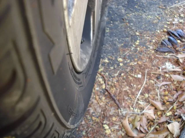

Problems with 215s
Tire Rack told me I could go with 205/50, 215/50, or 225/45. I only wanted a little more width to keep the rims from scuffing as they really stick out (see first picture):

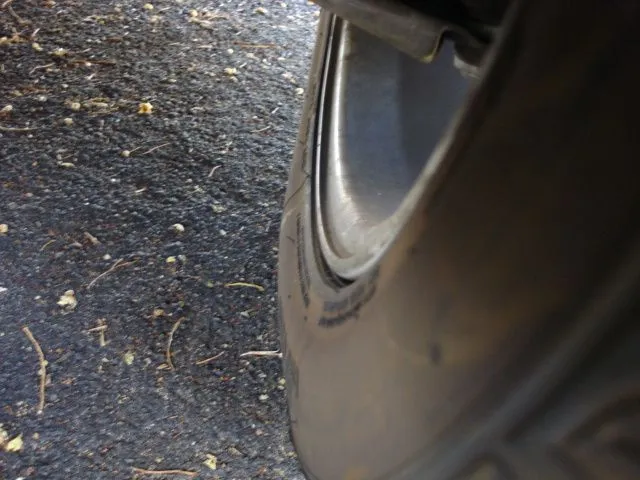

I got the Kumho ECSTA ASX 215/50s from Sears for $86 a piece. Once on I took them for Napa hill ride and they felt great. Some turns were 10mph faster than previously. The fit was perfect with just a little lip protecting the rims. Then, after about 200 miles, the tires settled in and the exterior lip forced the tire back in line (the first picture is current, looks like stock).
The new width shifted to the interior of the rim (see second picture). Still great traction and handling but the steering offset has shifted, placing the center of the tire .4 inches (10 mm) inward. It changes the handling and I am hesitant to go back to the track (I run NASA HPDE at Infineon Raceway in Sonoma) with the extra overhang.
I would stick with the 205/50s. Sears now sells the entire Kumho line including the ECSTA SPT which I wanted but they did not carry 3 months ago.
