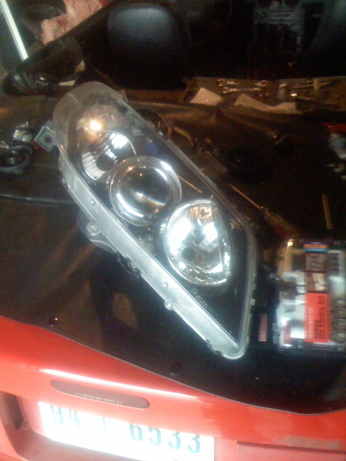

Ill post projector pics soon I have been trying to do this for a while I have 4 mazda 3 head lights I have 2 projectors out of the headlight but im still debating on doing it on my stock headlights or black jdm head lights....
Never say never. you can do anything you want with enough patience. Mine are not done yet but Im getting close.
Sorry to tell u this but it wont work i have 2 m3 projetors out of their headlight i guess i dont see a way to put the projector in the actual msp headlight
