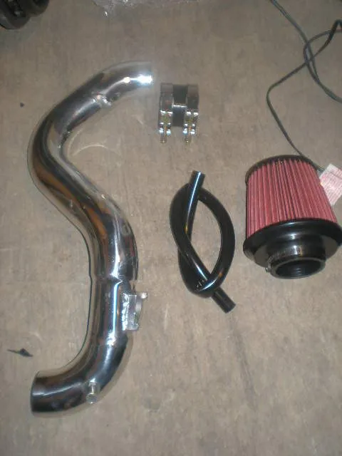

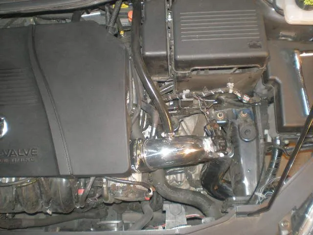

it should work here is pics of my fujita CAI looks the same
mazda5 intake but the part #'s are the same and the mountings and attachments points the same it should work
looks to me like the actual product that you posted njaremka but that one has just alittle more of a curve on top but shouldn't make any difference the biggest thing would be where the bolt down by the filter goes but it looks the same as mine and if ya want more pics just let me know and i will take some more of what area you want.
