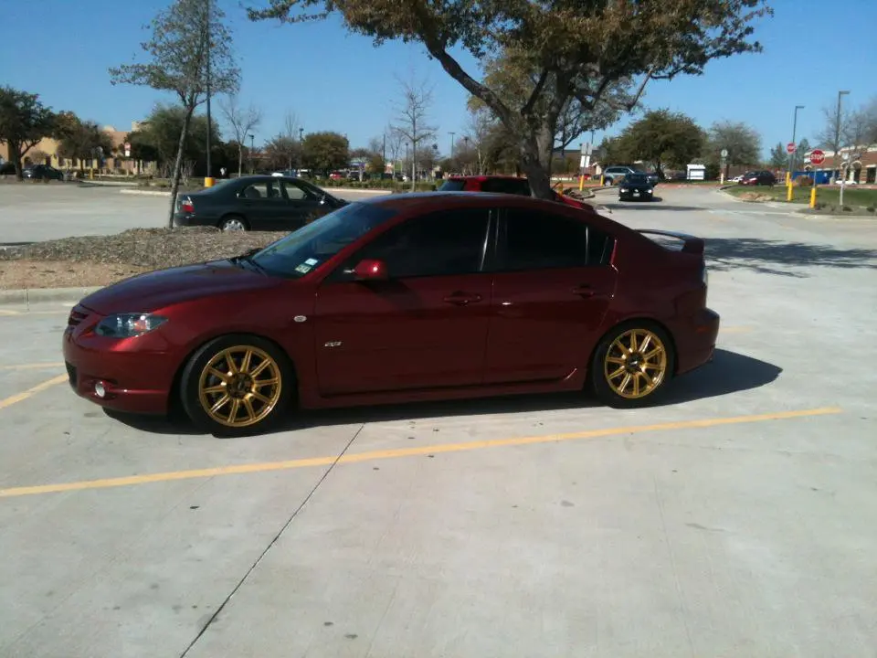

Finished product (for now) needs alot of cleaning up (rash etc.) and then to be PC'd dark bronze.

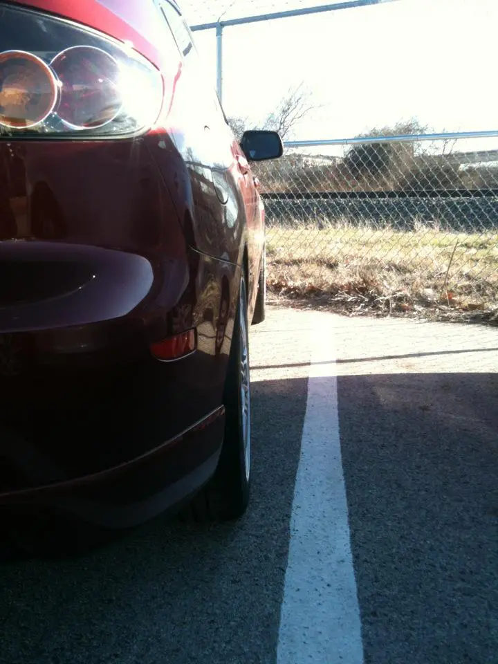

wheels flush.webpI have one or two side profile pics of the stock wheels (for flush reference) on my phone. I got another side profile pic up on my facebook that i'll share to here with the new wheels.

If any of you were still wondering how this came out, no I did not die. I'm getting ready for fire school so i've ceased all modding and been packing up to leave dfw. This is the cleanest picture of my car at the moment.
