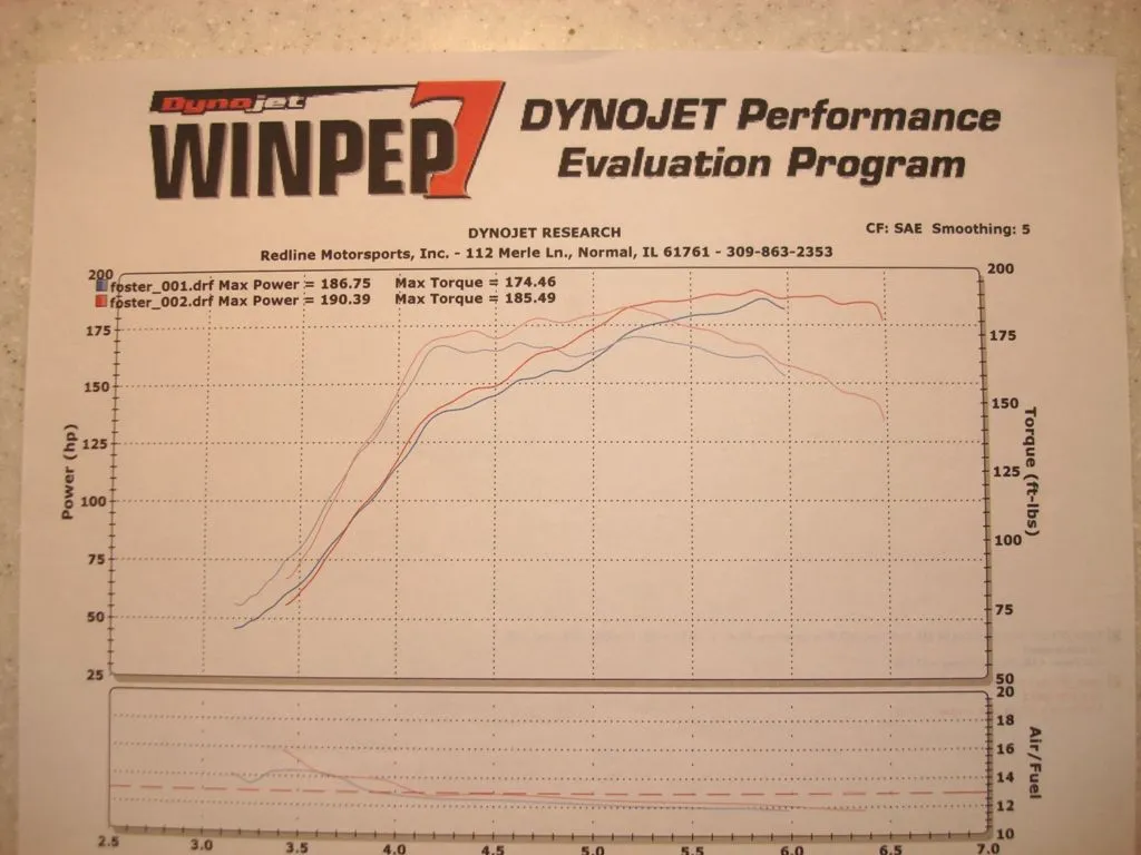

my dyno @ mid oh

looking to get up to 200...i think i'll turn the mbc up a click or two..... ;) looks like i have some fuel to spare!
You can do 10-12 psi just fine. I know people that have run up to 19 psi on stock internals and stock ECU, but after 12 psi, the turbo doesn't really do much because it's out of its efficiency range.
kansei's MSM was over 200 wheel with similar mods.
ya, to be honest i was chicken befor the dyno to turn it up...now that i know i have good afr #'s i'm going to turn it up...just a bit. i should have done it for the second run!!!!!
Here's the depressing part. The parts installed on his car came to like... $1500 maybe. The kit installed on mine is close to $5000, and COULD give me 212 at the wheels.
