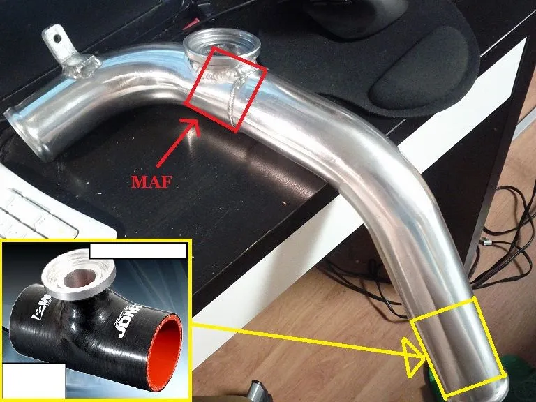

MAF sensor and BOV location?
03 MSP OJ
after i ordered mine FMIC
i just realized that i might have made a wrong choice
i asked the BOV flange to be welded right before the intake manifold
and then i see bunch ppl relocating their MAF there and put BOV flange before the MAF.
then? should i relocate my MAF? reweld BOV flange / get another piece arm pipe?(scratch)
or the setup is ok, without relocating the MAF?
u need to relocate the maf bro the maf needs to read w.e air is going into the motor or u will die at idle etc... u really should have done some research the only way this setup will work is if u vent the bov back into the intake and no vta
so what can i do to relocate the MAF then?
attachment.php
i got a pic of the pipe from corksport

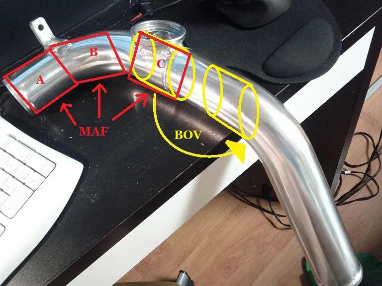

moving MAF to A section is not gonna work right?
B section got a angel 45degree coupler *2 gonna work? (is it too close to BOV?)
or should i cut BOV section and relocate BOV toward bottom and put MAF on C section?

ok so i think this one might works better?
attachment.php
i found a silicone T pipe with BOV flange
just cut a small end from the bottom and connect with this silicone t pipe
then cut the original bov flange away and swap in the MAF?
this setup might look more cleaner?
i just feel lil stupid to pay for the flange and welding for extra $101 from corksport,
thought i can just plug and play to save some time and energy.
well, at least i can learn from mistake =,=|||
