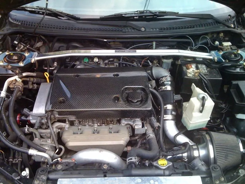

i plan on relocating my maf soon after i buy some things....
can u guys who have done this post a pic of ur set up??
i wanna get a silicone elbow to go from the tb to the maf then a pipe from the maf to the ic and have my ssqv mounted in line on the cold pipe.
as u can tell i want to get rid of the turkey and vta so pics would be nice thanks in advance!!!
theres a pic, ill find the other ones I ahve, you have to make sure your MAF and BOV is far enough away from the Intake Mani .
It should go like this (from turbo, and the setup I have)
Turbo-Hotpipe-intercooler-coldpipe-BOV-coldpipe-MAF-coldpipe-IntakeMani
The MAF should be 1/4 the way into the coldpipe from the MAF and the BOV should be 1/4 away from the Intercolor on the coldpipe.
Heres another one, the BOV is under the SRI
alright thanks im gonna run with the upgraded side mount tho so room is a lil harder... turkey bugs the hell outta me or else i would just run the dual setup
ha u have my name sean lol but i have a ssqv and i wanna vta cuz i love that noise....so i wanna relocate lol
mine never turkeyed with the dual set up bro why waste time and cut pipes with no reason? with my fmic i still run dual
u still vta with the dual?? wat did u have to do just put a t in the vaccum line??
its a hell of alot eazyer then relocating if you need help you know where i live haha
