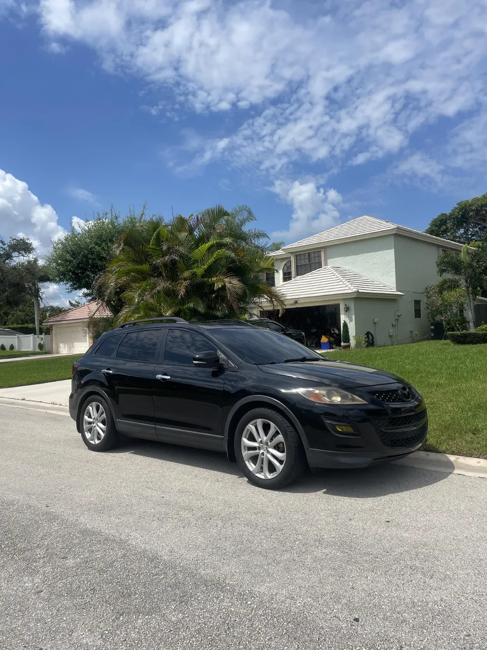

Curious, how it has held up till now? Thinking about lowering my 2011 cx9 pretty soon but i just replaced the shocks so not sure if i should. Just looking for that sporty look.
I installed them on my 11 cx9 AWD GT, and I love the look! However, it dropped the rear more than the front in my case. It's very noticeable sometimes, but it's better than stock. Also, the shocks are stiffer but have a longer stroke, so it's cushy over things like speed bumps. For example, if you tried to jack the front of the car up, you'd be jacking forever. It also added some camber to the rear wheels so that might affect my tire wear. Additionally, It accelerated the wear of my wheel bearings.
