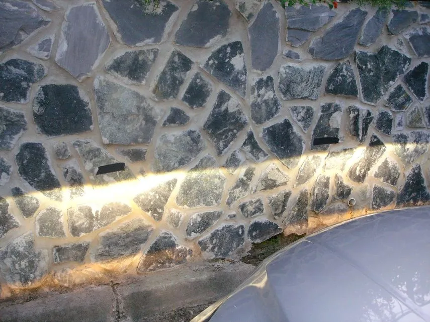

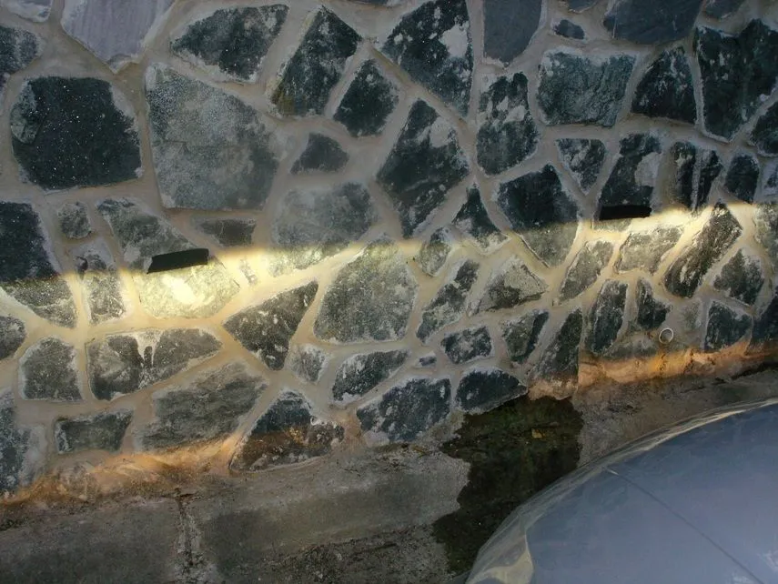

Pull your car up to a wall. Turn on your headlights on level 0 and then mark the beam pattern on the wall with tape. Readjust the aiming dial to 1. Now manually reaim the lowbeams (via a screwdriver on the adjustment screws) to match back up with the tape marks from the original level 0.
Once you're finished your headlights will be aimed in the same place as they were to begin with, but on level 1 instead of 0. This gives you the option to dial down to the new level 0 and have them shine higher. As this increases the chances of you blinding or pissing off oncoming traffic I recommend you not use the 0 setting unless you're not around a lot of traffic.

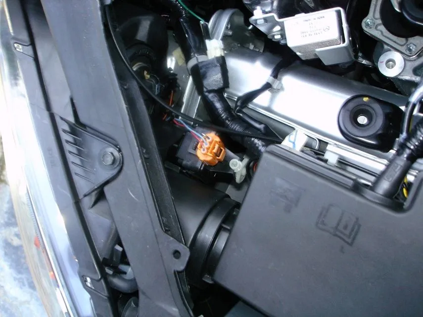

if you need pics of what to do i can find some. i have some on my other camera. i posted up a how to of sorts in some thread i cant find it now.
