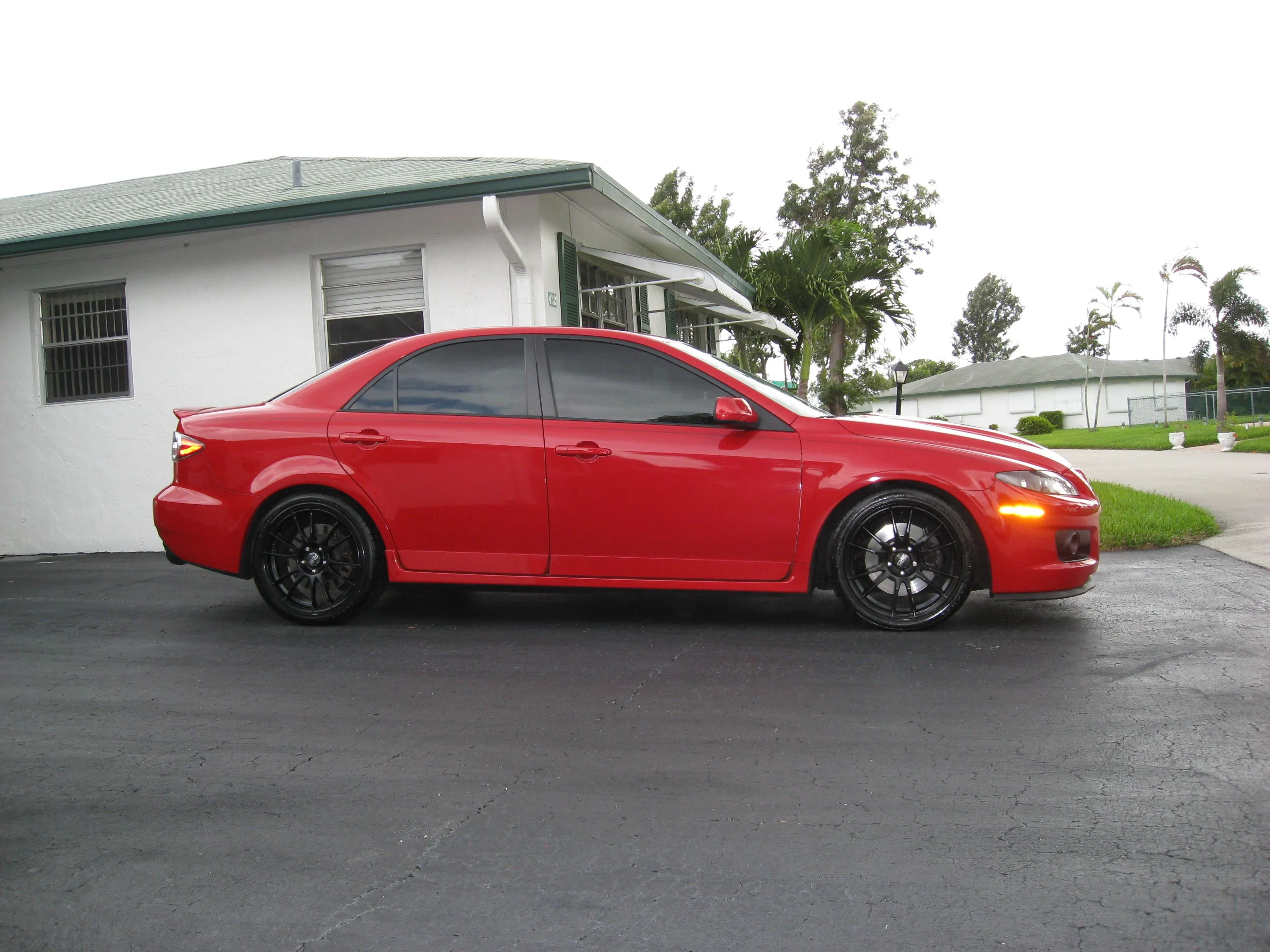

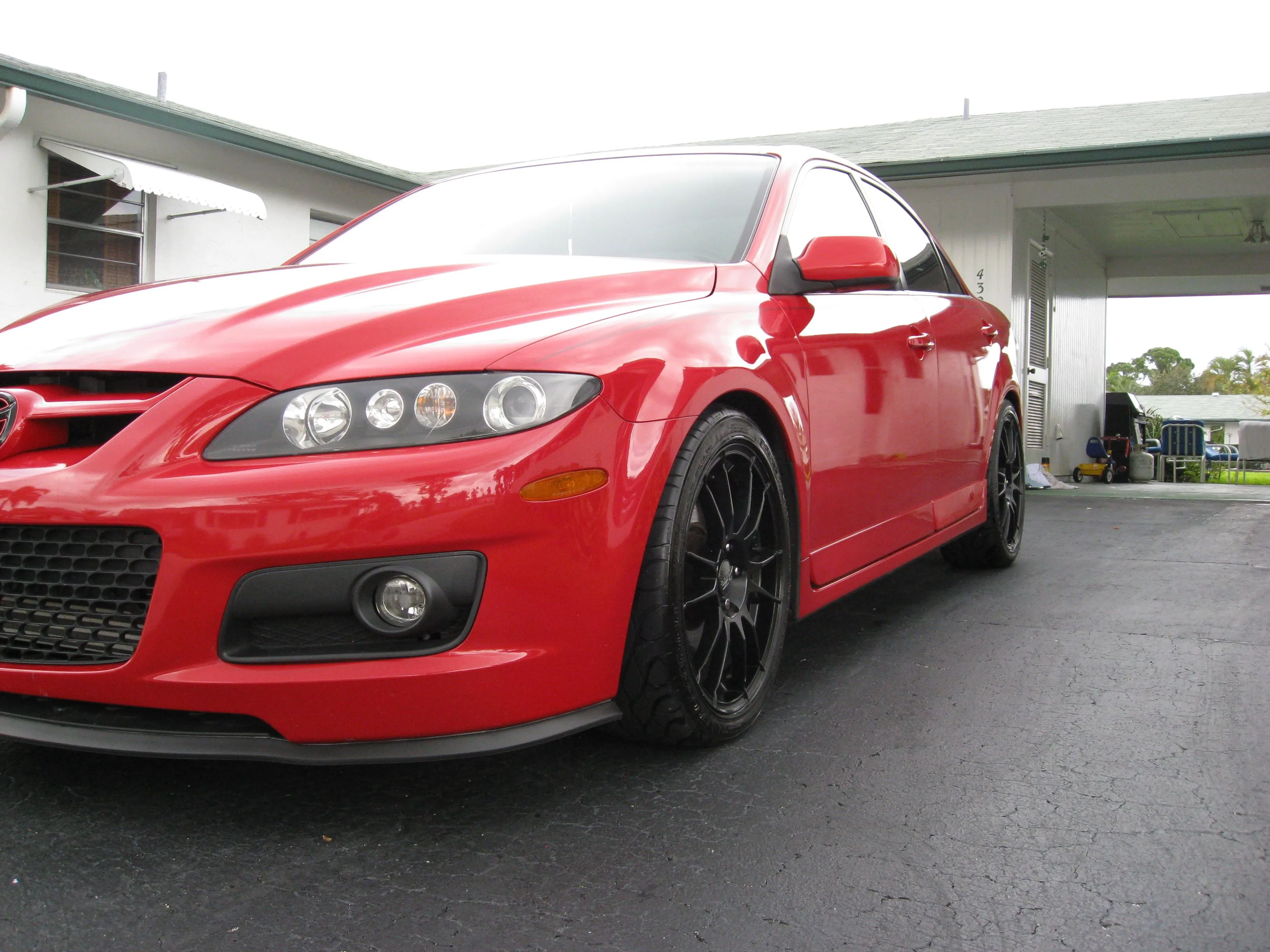

I have the Mazdaspeed springs and their ok. If you got weight in the back seat or trunk they tend to sag. As far as ride or comfort they are ok. They get the job done as far as giving your car a lower stance but I dont think they preform as well as they should. I'll be needing to get new shocks/struts soon, so I'll also be upgrading the springs or just go all out and get coil overs.. not for atleast another 6-8 months though.
On 20"s with no weight (silver wheels) on 18"s with wieight (black wheels)
