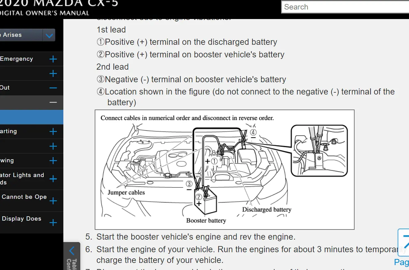

That link that sm1ke posted about jumping battery-
why does the negative connector have to be connected to
that #4 position (not on the battery?)
just wondering ..
@joemazdacx5 , I don't see the link you're referring to but two reasons I can think of off the top of my head ...
When charging (which is what is happening when you "jump" start also) a battery, flammable hydrogen gas can be produced and escape from the battery's venting system. If you have both jumper cable (or charger) connections at the battery posts there is a possibility of the sparks from connecting/disconnecting the cable igniting those flammable hydrogen gas vapors and causing an explosion. That's bad since your battery contains sulfuric acid and could shower you.
Another reason is many modern vehicle systems have current sensors to determine battery condition so you need to attach the ground cable of your jump or charger to a frame source instead of the battery.
just wondering ..
Probably to avoid sparks igniting something. When the Mazda roadside guy came he hooked but neg/pos cables directly to the battery and the car started fine.
Oops...He posted a link for the hatch, but further in the manual
it has stuff about the battery...Pic.
Attach negative to point 4 but guess it's to prevent fire...As stated by wlong and hyflyer. Thanks.
