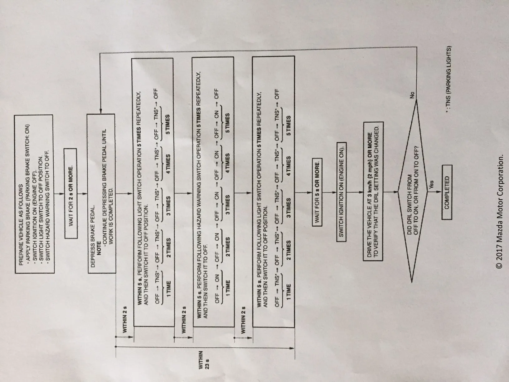

Is there a way to turn the lights completely off on a 2017 CX-5? I work on a military base and they prefer us to turn our lights off as we pass through the guard station.
joe - you need to refer to your manual - for 16s there is a long procedure to turn DRLs off. If you followed that and during the day - there should be no lights on. I dont have a 17 manual but you can search it. If you are near your dealer he can do it for you too.

There is a designated fuse for the DRL's. Just pull it and everything else works as it should. Did it the first day I got mine and won't ever use it. Hate DRL's. Look in your manual, can't remember which one it is!
attachment.php

I tried doing that and could never get it to work. Pulling the fuse was much easier
