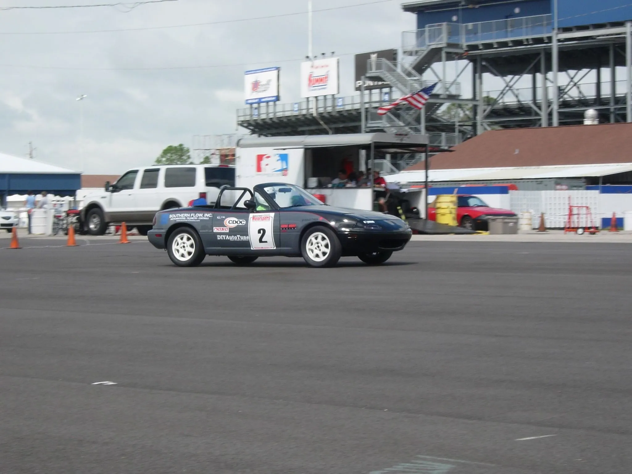

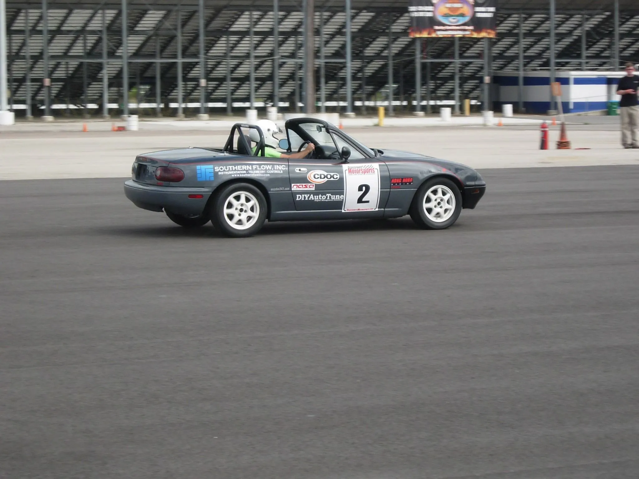

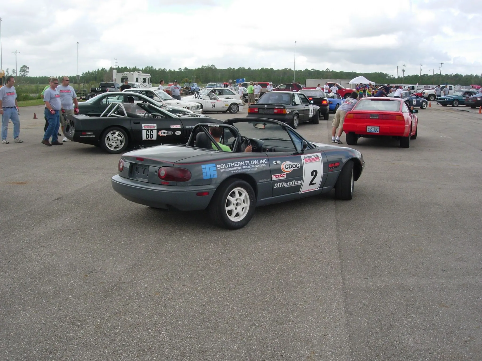

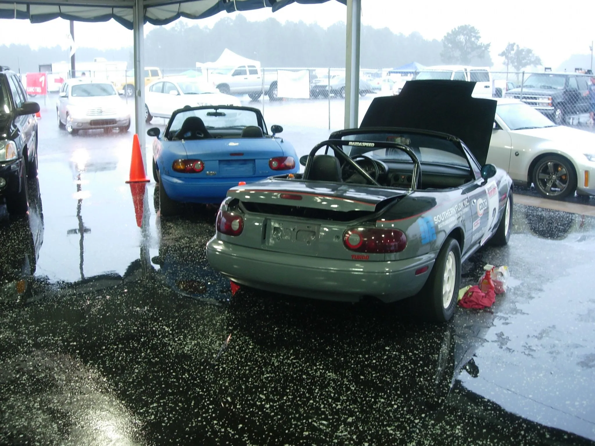

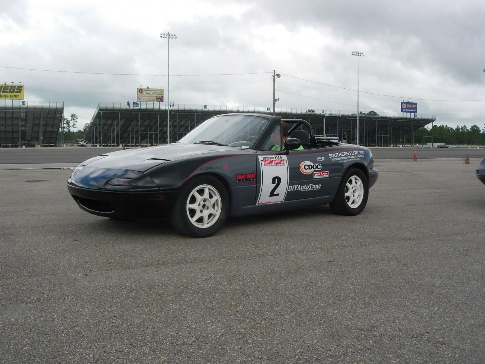

Attached are a few pics from the event. The number plate supplied this year was HUGE! A handful of the lower numbered cars were supplied larger panels as they had run out of the smaller counterparts. With the approaching fowl weather, and in my hurried state, it didn't even occur to me to attempt to trim it down. Oh well....
