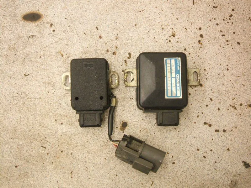

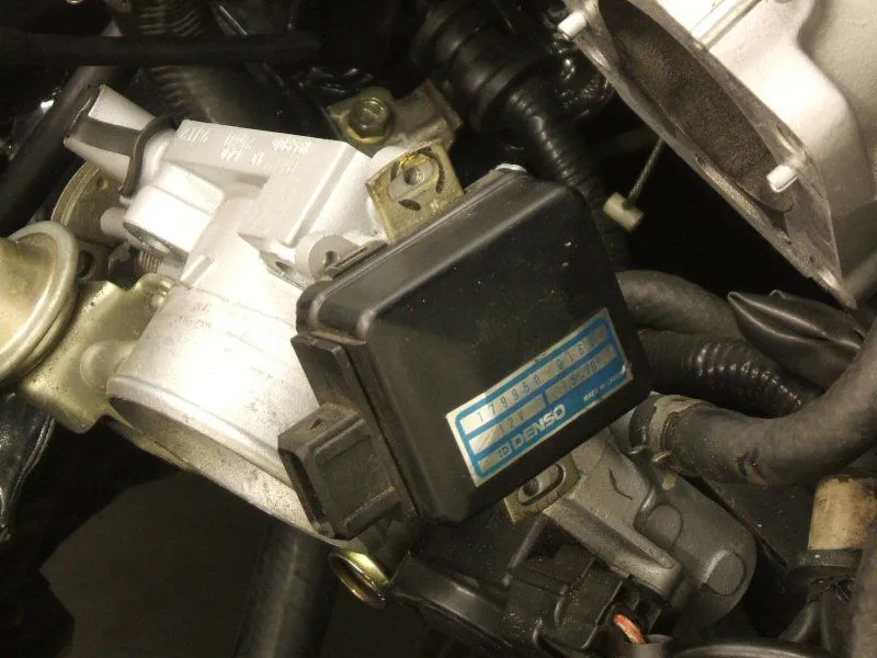

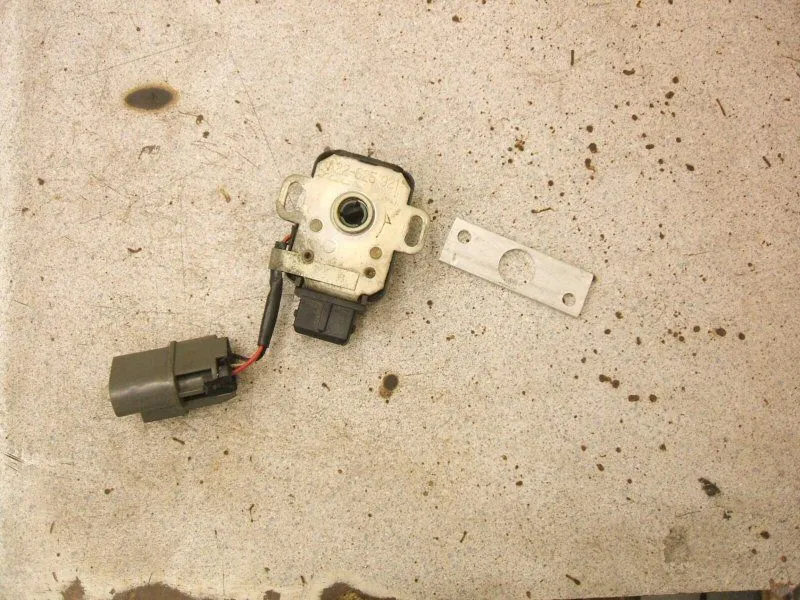

TPS Swap

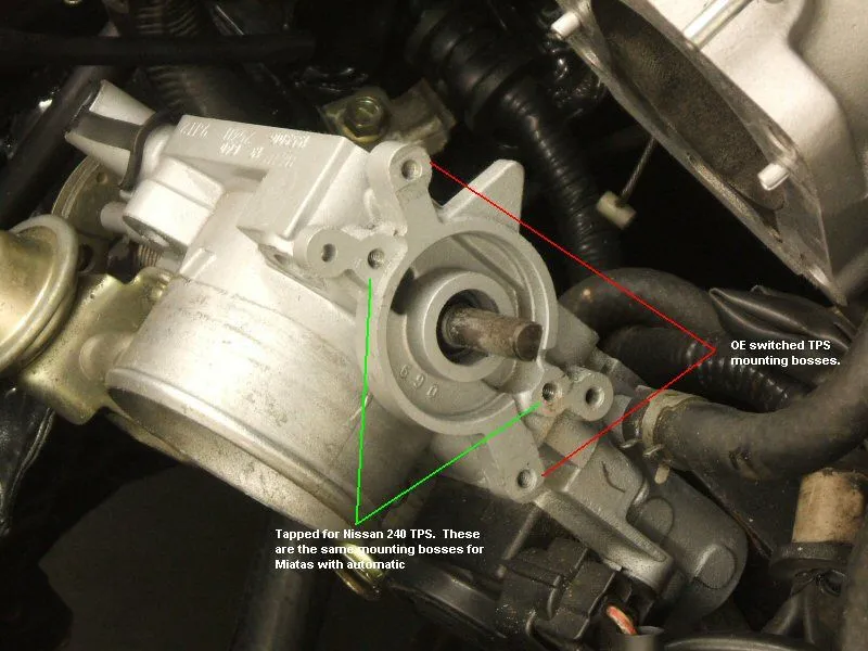

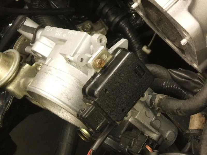

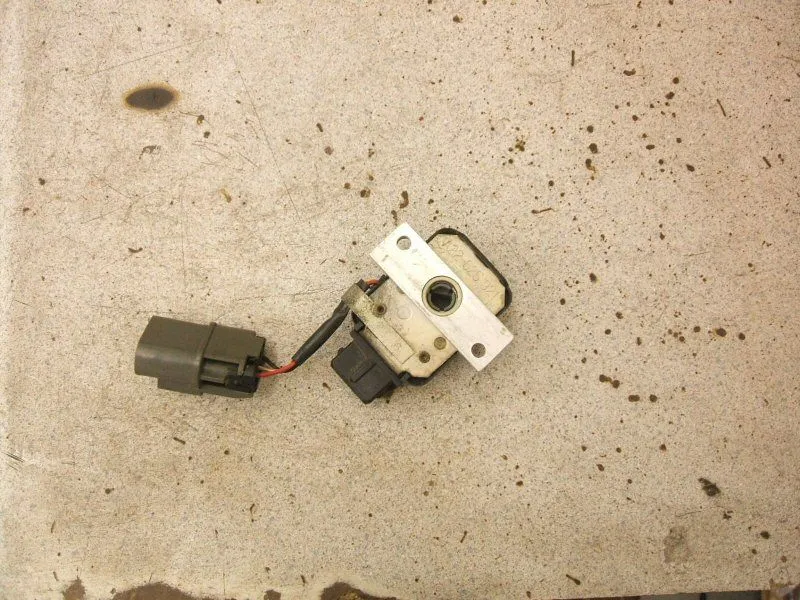

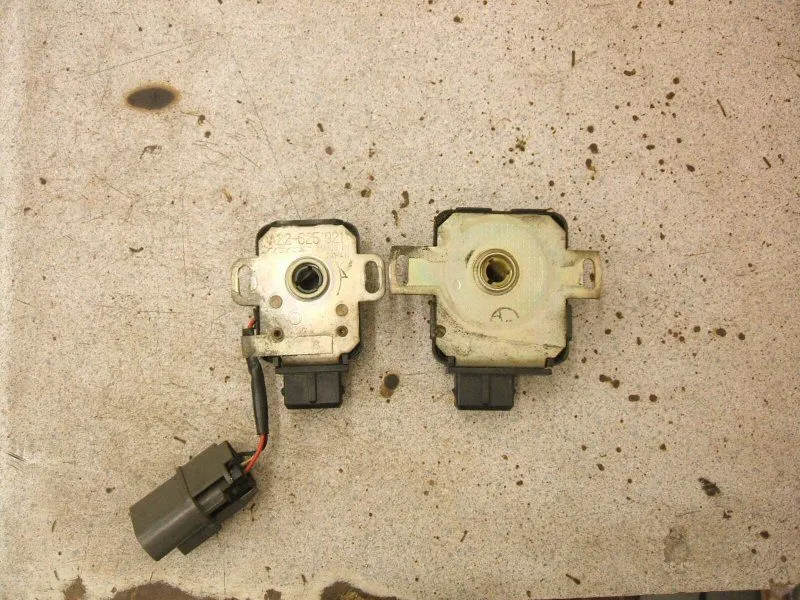

In order to ready the car for the MS and boost control, I undertook the task of swapping the throttle position sensor tonight. The 1st gen 1.6L Miatas with manual transmissions use a TPS that indicates to the ECU either a full closed or full open throttle position (switched). In order to properly implement boost control, I needed to employ a true analog throttle position sensor. Normally, one would swap the throttle body with one from an automatic Miata or first gen Protege. Holding true to my nature, I took the alternate route.
I discovered that a TPS from some generation of Nissan 240 with an automatic tranny have a similar footprint to the manual Miata's TPS (hooray junkyard browsing). The 240 sensor has both switched and analog circuits on two separate connectors. Furthermore, the switched portion uses the same pinout and connector as the manual 1.6 Miata...but the switched circuit won't be used in my application. Confused yet?
All 1.6 Miata throttle bodies share the same casting. Therefore, they have mounting bosses for either a switched or analog TPS. It's the actuation rod that differs. That said, the mounting tabs of the TPS from the 240 have nearly identical spacing to the mounting bosses of the automatic Miata's TPS. In order to make the 240 TPS work with my throttle body, I tapped the appropriate mounting bosses on the TB and slightly enlarged the holes on the mounting tabs of the 240's TPS. The Miata's TPS receiver is about 1/8" deeper than that of the 240's. To prevent the new TPS from binding and/or mounting funky, I fabbed a spacer plate from a peice of scrap aluminum.
All in all, this required way too much typing for a simple sensor swap ;). It took less time to swap the sensor. The primary advantage of using this set up allows one to swap to the stock ECU for whatever reason without having to exchange the throttle body. As previously stated, the 240 TPS uses an identical switched circuit. Simply move the Miata's harness from the analog circuit to the switched circuit. Note, also, that the throttle body will need to be removed to facilitate removal of the OE TPS.
On to pictures for clarification (two posts)....

...more TPS install pics.
First image: OE TPS
Second image: TB mounting bosses and actuation rod
Third image: 240 TPS

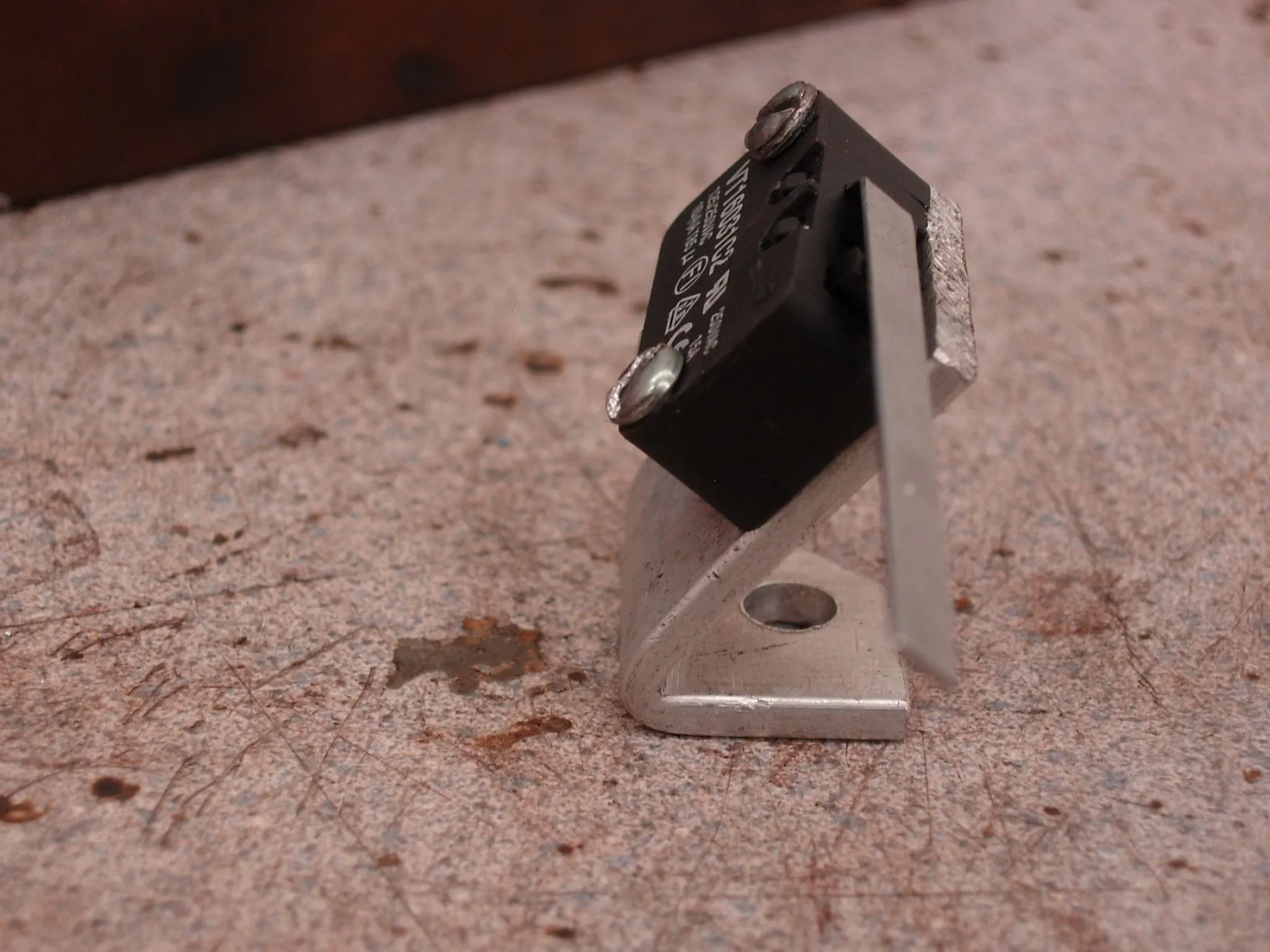

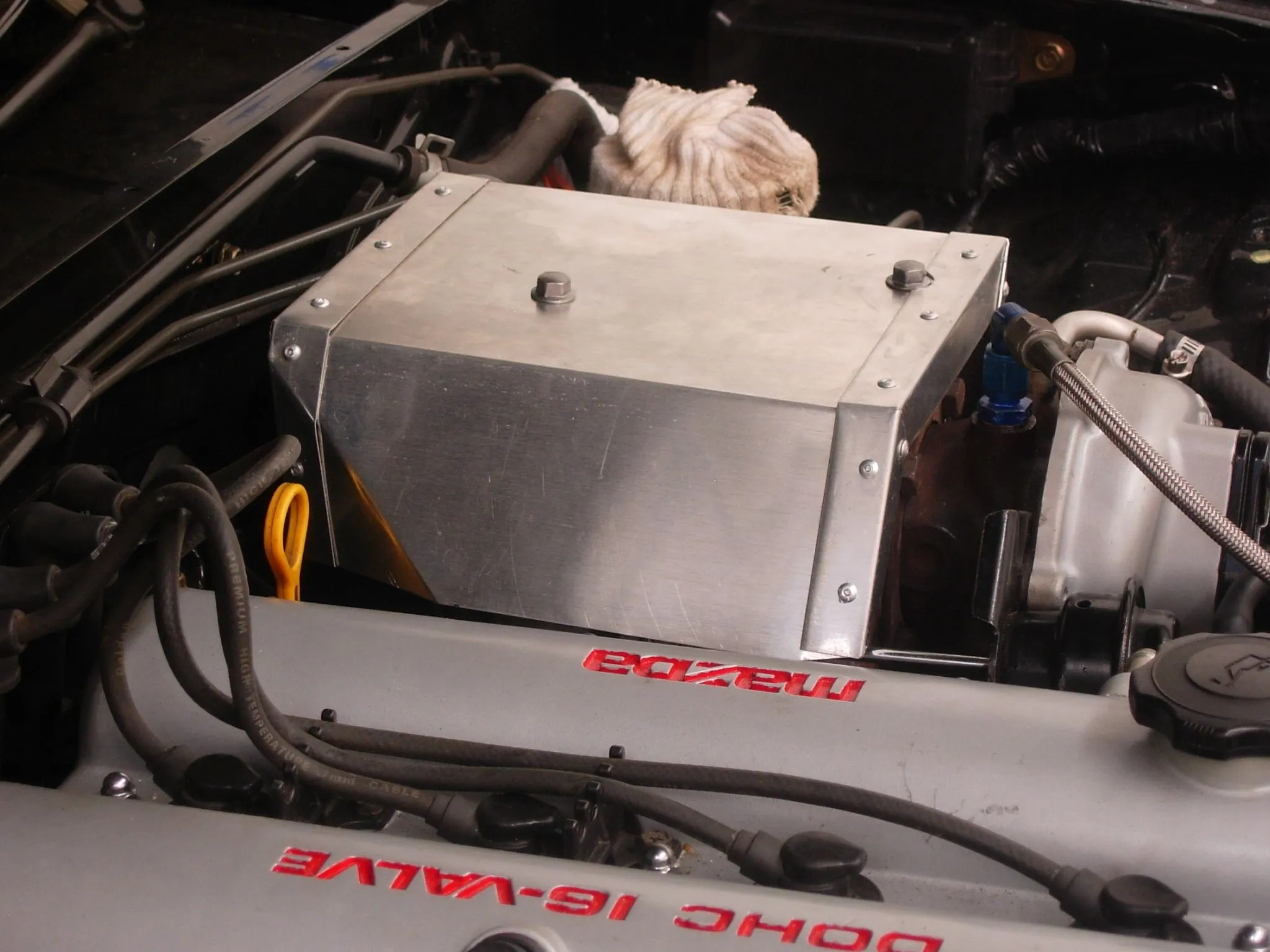

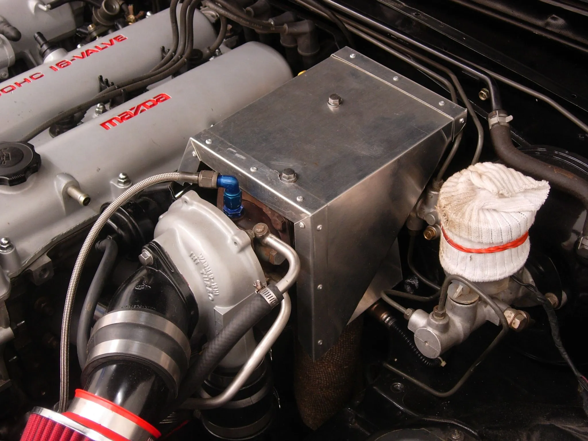

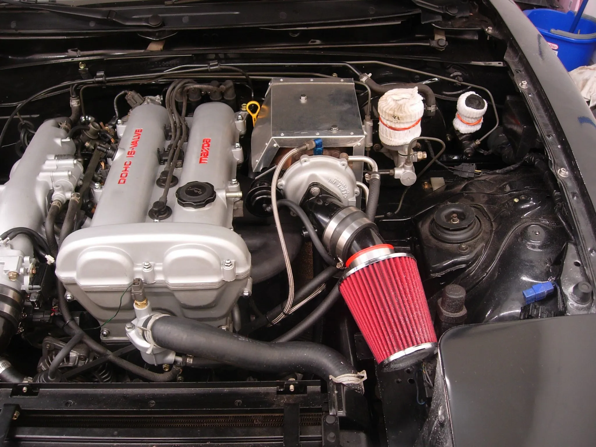

In the mean time, a few pics are in order. The first image depicts the launch control switch bracket. Anyone who has spent any amount of time under the driver's side dash knows how painful it is to do any work there. I've found myself in contorted positions that I was previously unware I could perform. Anyway, the switch is activated when the clutch pedal is fully pressed.
The next three images detail the new turbo heatsheild that was completed tonight. I wanted more shielding around the brakes' master cylinder and proportioning valve. It's basically an elaborate box with adequate clearance for the brake components and dip stick. I added a bit of edge bracing as well to keep vibration and noise down. This was built from a single peice of sheet metal.

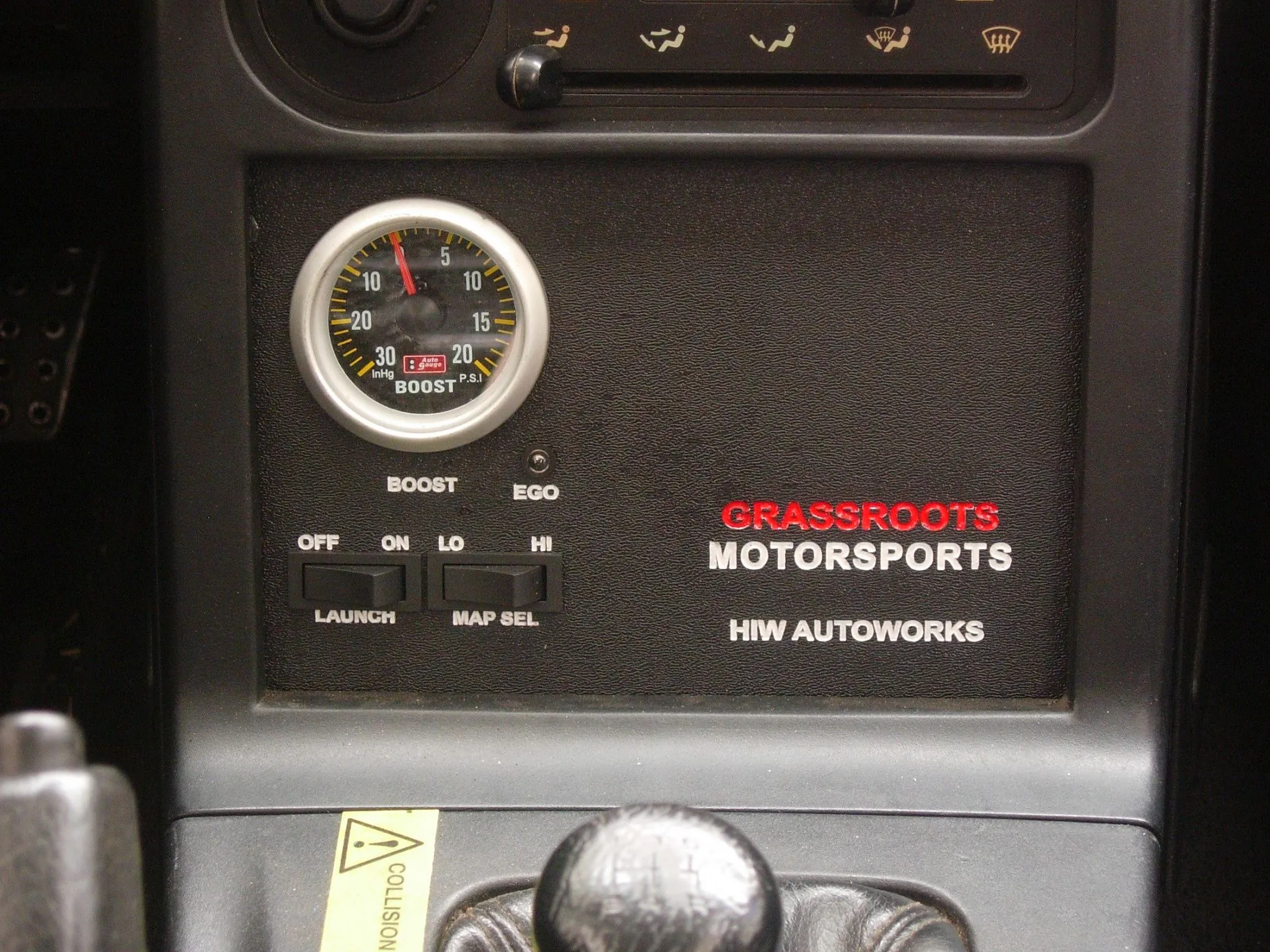

Last is the new radio delete panel. The past two years' panels were quickly constructed and rather gaudy and vague. For the latest panel, I used the CNC engraver at work to cut the text and painstakingly painted the wording....something I'll never do again, heh. I blew four hours completing it. It took less time to swap the turbo. Nonetheless, I think it was worth it.
