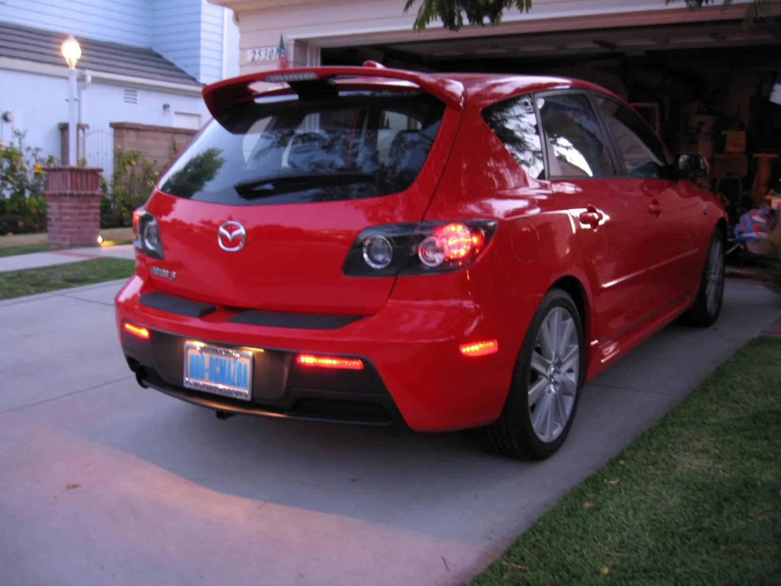

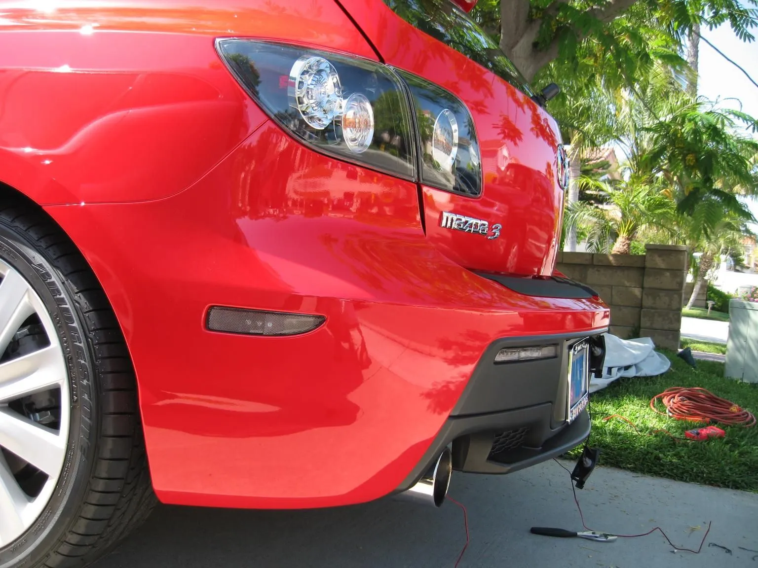

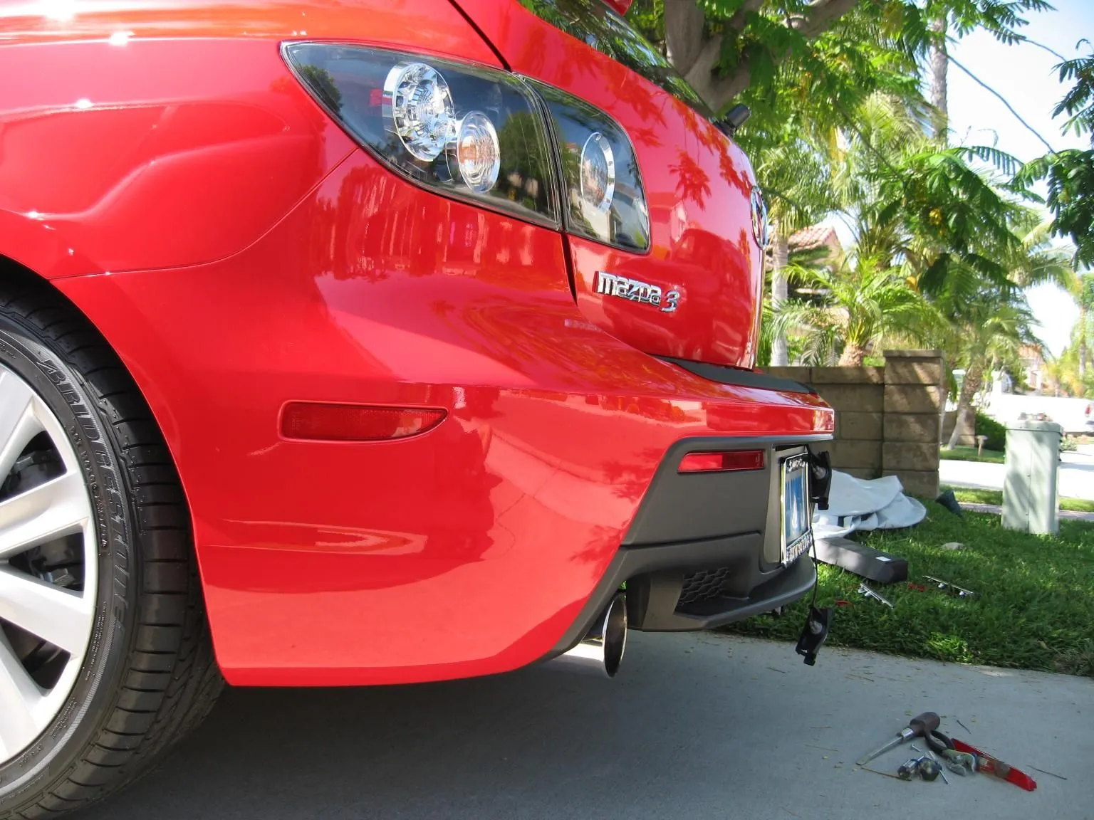

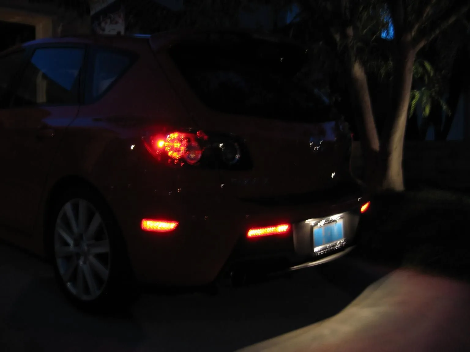

I saw these lights on another thread in this Forum and thought I should post here with my review. The quality is very nice and it is a direct replacement for the stock reflectors in the rear. The led lights are also very cool - the pictures did not come out to well - need to use a tripod to hold the camera steady but you get the point (no flash). The side reflectors are very easy - the rear are another story (there is a philips screw holding in the reflector). I had to remove the screw from under the car - PITA - my hand got chewed up from the sharp edges of the frame. I got them from www.thexenonstore.com and they are not on the website - email Devin for the curent price. I wired them into the rear license plate lights - no problems.
Cheers!
Peter

I think if you take them apart, and grind the top of the LED so it is flat, and not round, it will make a 100% better difference. It will make the light distribution more even, and not so "spotty".
Also, I would spraypaint the sidemarkers red, so they look more stock.
I prefer more simple and subtle though, not everyone does.
it looks ok. i think leaving them as turn signals and brake lights arent a bad idea, but leaving them on at all times is seriously like christmas tree. (to quote: the MAN)
The more red lights I show in the rear at night so the moron behind me can see me the better I like it.
I really like the rear ones. You can hook them up to a switch and use them as fog lamps like the Euro cars.:)
i have the smoked ones as well, the rears are connected to the brake light so they onyl come on when i brake, abnd the sides are connected to the regular running lights so they stay on when driving and act as a rear side marker
