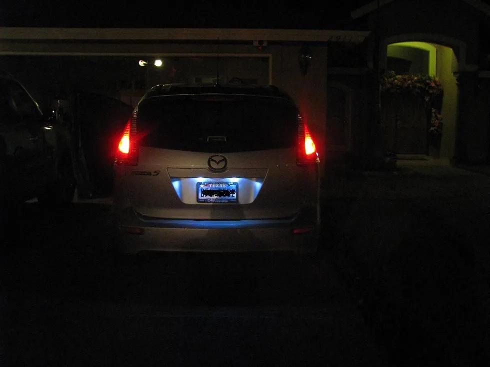

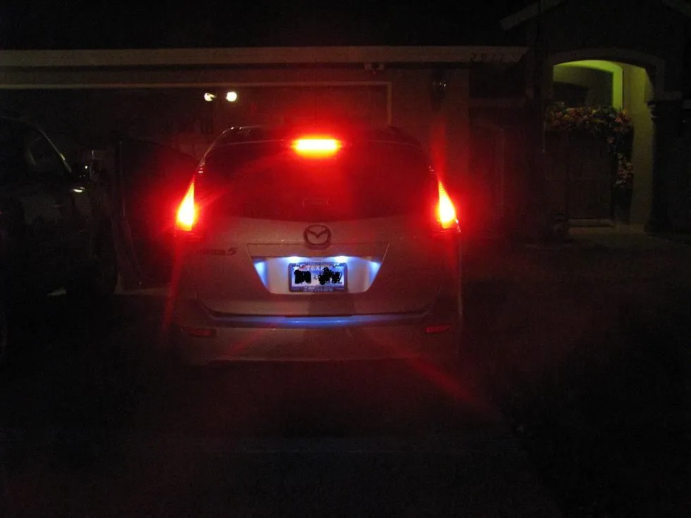

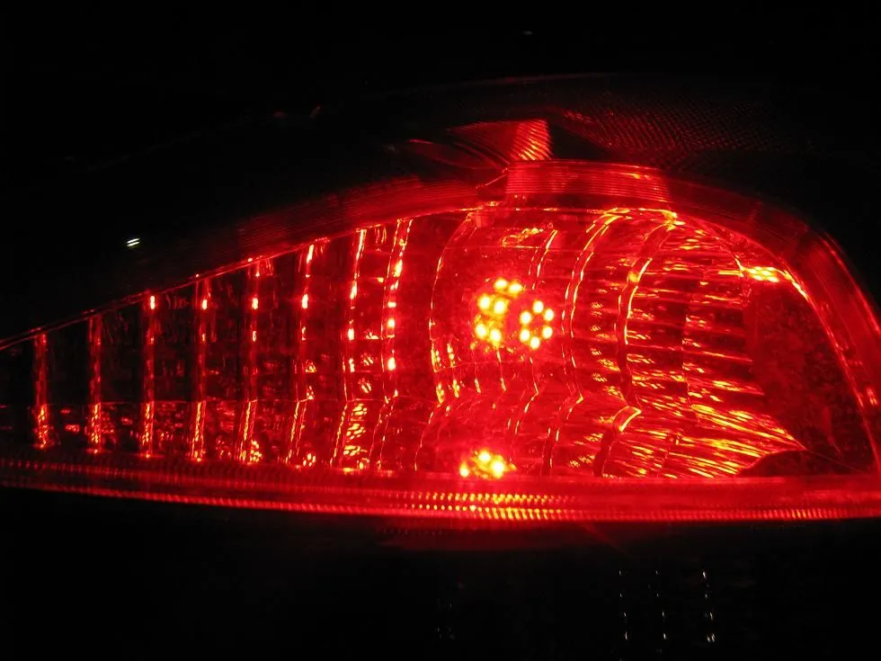

I installed the new tail/brake-light LEDs yesterday on my 2006 Mazda5, as well as license plate LEDs, and the cruise control is still working fine. I wonder if this is either because my LEDs are of the "error-free" type or if the cruise control's functionality is not dependent upon the amount of current drawn by the taillights at all. I'm glad I don't need to worry about adding resistors for the taillights.
