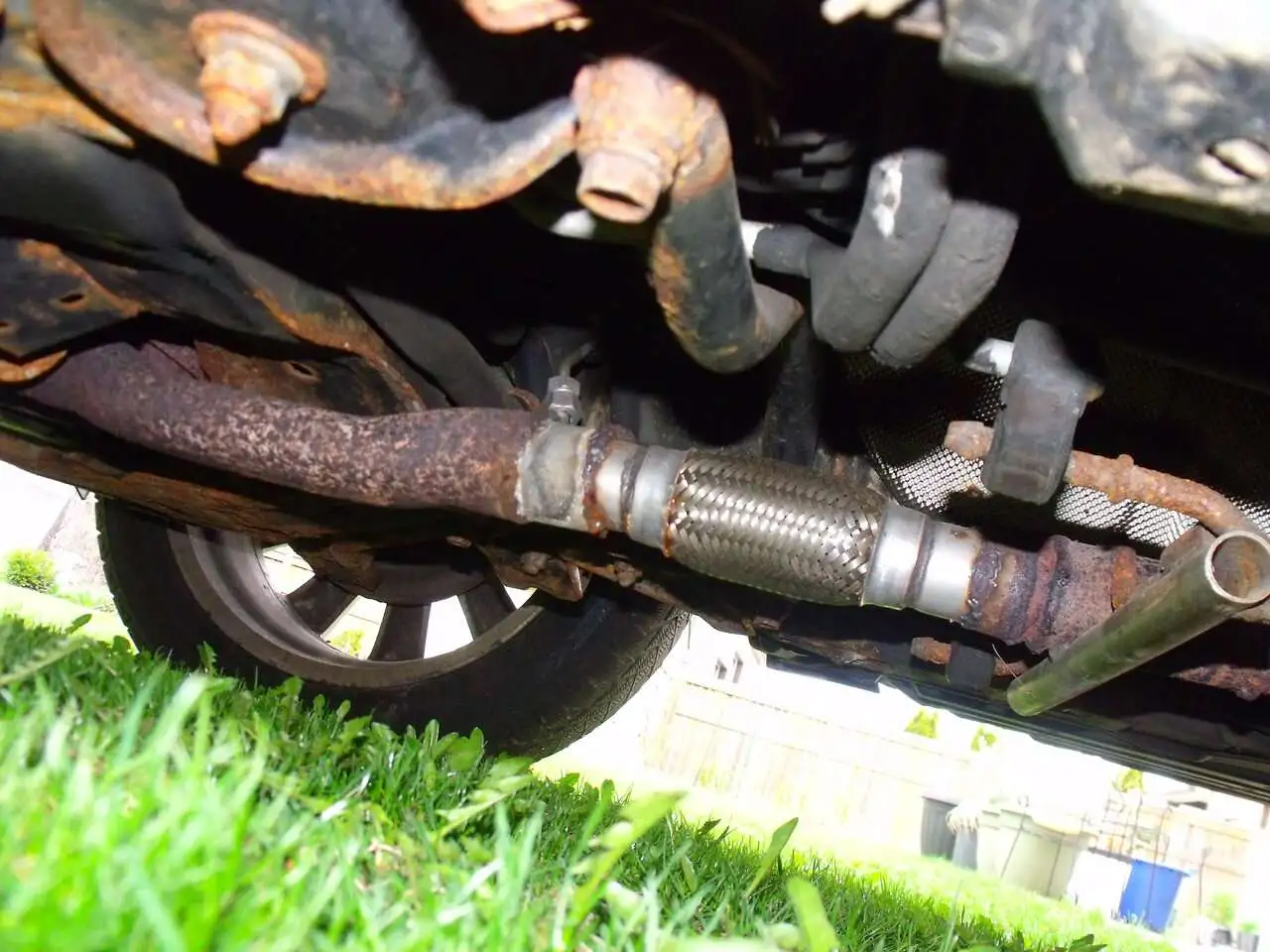

sorry for late reply ,the car is a 2008 CX9, bought it used noticed no catyltic in center , they have an aftermarket work around cat there ,Ill get pic .The vehicle has 300,000 kms 🔧

My other concern is if it has a proper catalytic converter , the pic is in my previous post

I think that what is pictured there is not a catalytic converter, that looks more like a flex pipe. Maybe the previous owner replaced the cat with a flex pipe, and the O2 sensor is triggering an emissions code. Do you have any check engine lights on the dash? Can you pull codes?
If you can't pull codes yourself, you can try driving to a store like Autozone or Napa to ask if they can read the codes for you. You can then search the code on Google to get an idea of what may be causing the code.

I agree with sm1ke, that's not a catalytic converter, it's flex connection.
It looks like it was replaced based on the welds, but the factory exhaust has one in that location.

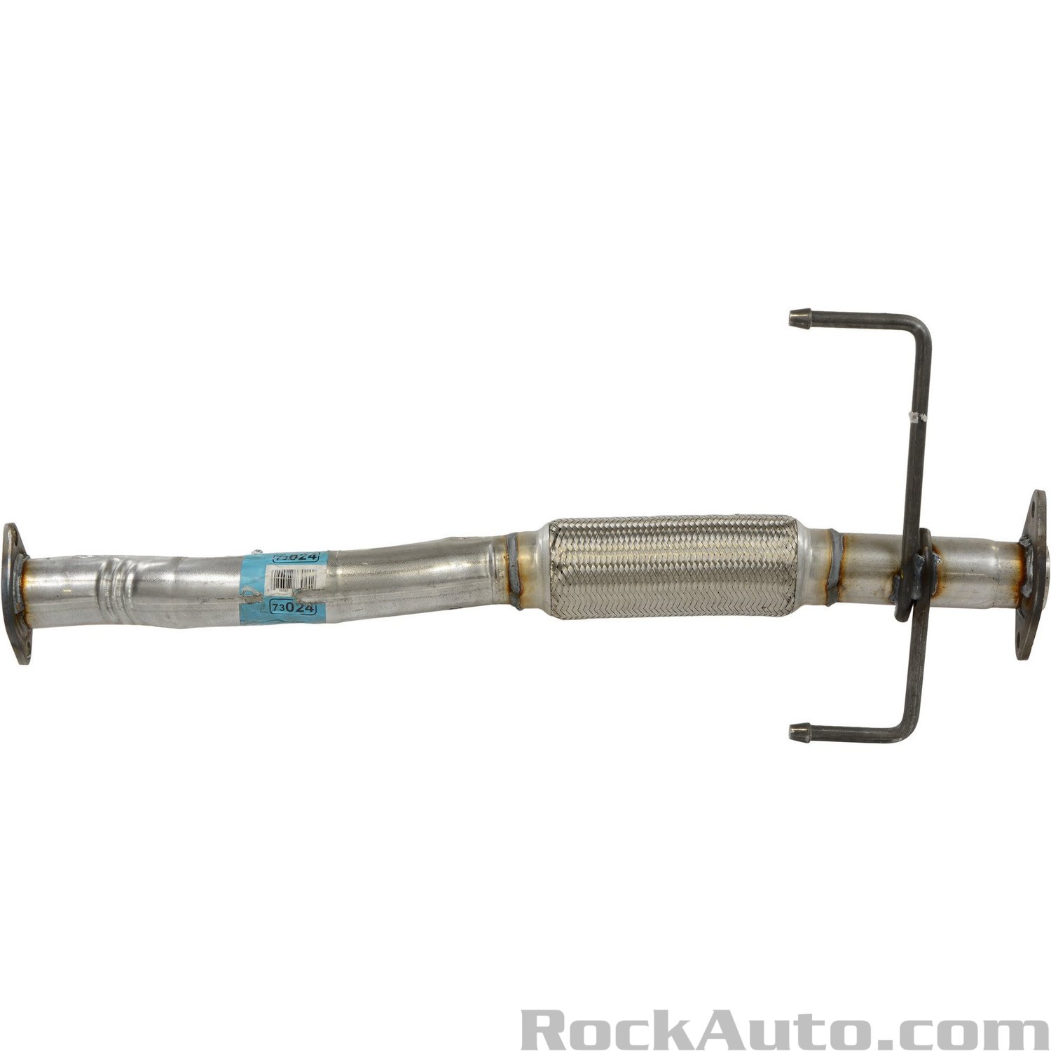

Picture below from Rockauto seems to match (but with better welds :) )
EDIT: I think the downstream cat is in that pipe, but to the left of the flex pipe.
Thank you for responses,I have code reader but don’t see any codes ,that exhaust flex looks very close to mine (minus rust),so maybe all it ok there ,time will tell when I get more into this scenario.My only other concern at moment is when engine idles it seems to be a little rough and tranny seems to be a little clunky ,funny how when you test drive these things don’t show up ,well I just have to keep paddling against the rapids.Ill take anyone along for ride that’s willing to come .Have good day .
