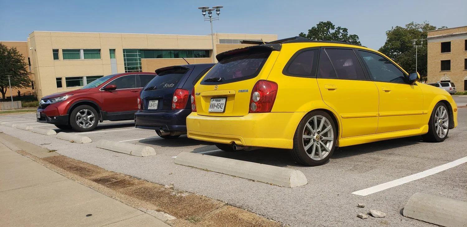

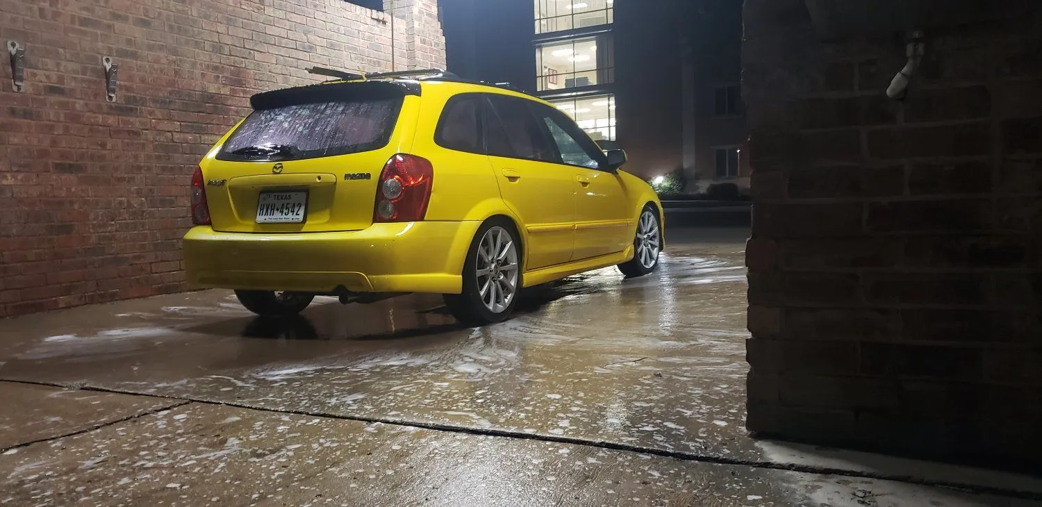

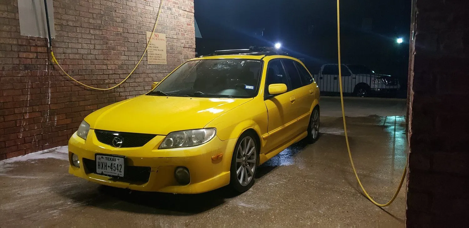

The spacers I bought ended up having just too small of a center hole to fit so I haven't done those and need to reorder more but I added some pictures of what I have currently (and this is at about the top of the coilovers height range). And another brief update I've still not had a single problem (my bearings died because of a roadtrip but that's unrelated) and I still enjoy them, I stiffened them a small bit from where I had them before and they have held to the road great in all my borderline reckless driving, highway, some corners where they can be found, and surface streets.
