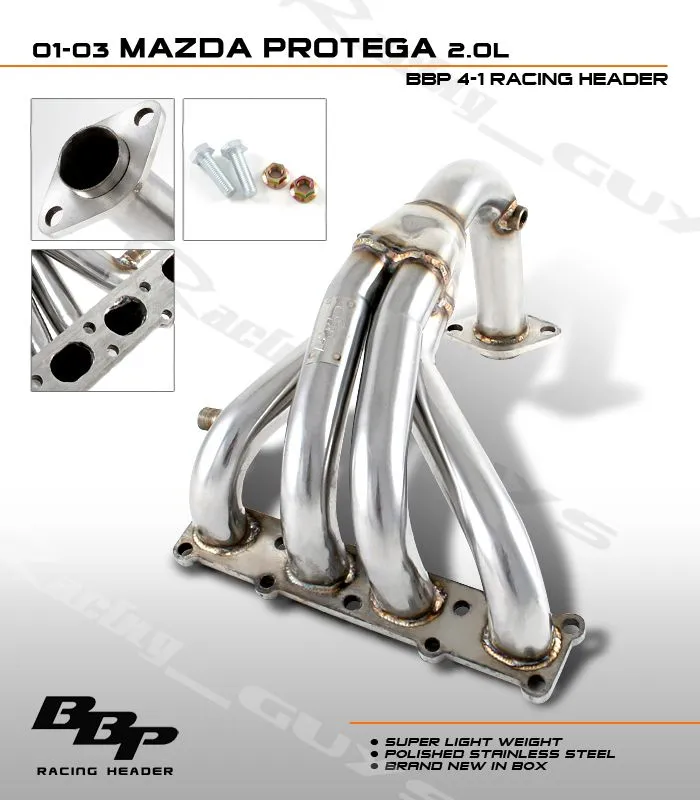

Just bought a set of 2.0L racing headers for my pro. Should ship out tomorrow, but prolly wont be installed till the first week of April. Ill post pics after the install.

i do believe i have that header or one just like it badged differently. thank you ebay. i am real happy with it. i havent had a single issue with mine at all. google a how to for a spark plug defouler trick for the O2 sensor thats going to be off. its pretty much universal. enjoy!

One thing I am worries about is that it is a bargain header and Im worried about it not sitting flat against the head, I think you can just grind it down until it sits flat, any ideas?
it'll sit flat, i bought a cheapo header and the only problem was the EGR was WAAAY off
but i eventually got it to fit, if your egr is a bit off, just cut the EGR pipe and have it welded shut so no exhaust comes out
