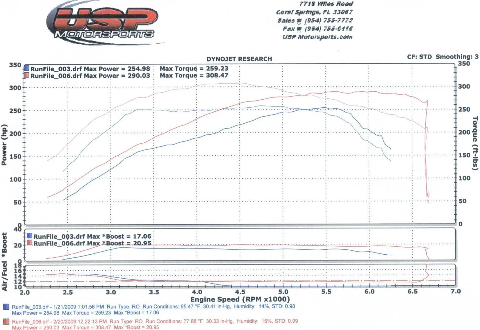

Just had my Speed 3 Dynoed today, how much is everyone else throw'n down?
'09 Speed 3
My '09 Speed 3 rang up 290 hp, 308 tq!
Mods; ms cai, cobb turbo inlet, cobb down pipe, racing beat cat back, cobb ap-stage 2:91 oct map, forge bvp:blue spring.

Alright here it is
Thats awesome man 45hp and 40tq increase with the mods is really good. Having the baseline on there is really good to show the increase, because some will always saw ehhhh the dyno is too high/too low, whatever. but the increase shows it.
Are you using a dashhawk? If you are you could take a run to see how the a/f and kr are.
on the bottom of the dyno sheet there is data on the afr on the baseline , which was way rich and today's run, remained very stable between 11-12/1
It doesn't look like you really ran out of steam towards the end at all, maybe just a little!
Actually, it's 36 HP and 48 ft/lbs. But definitely having the baseline run puts things into perspective even though the runs were done on different days which throws some variability into the equation.
did you ever hear of a correction factor? these are corrected readings, so no variables involved. also peak numbers are not the total gains, the midrange increased alittle over fifty hp and top-end past 6200 almost 100 hp.

Yeah sorry about my math and not seeing the A/F on the bottom. The a/f ratios are awesome, staying right on 12 seems to be the best for the car
cobb doesn't have a 93 oct map for ms cai and down pipe and cat back, only 91. when I upgrade my ic, then there is a 93 oct map, they sugg the map I am now running until I upgrade.
