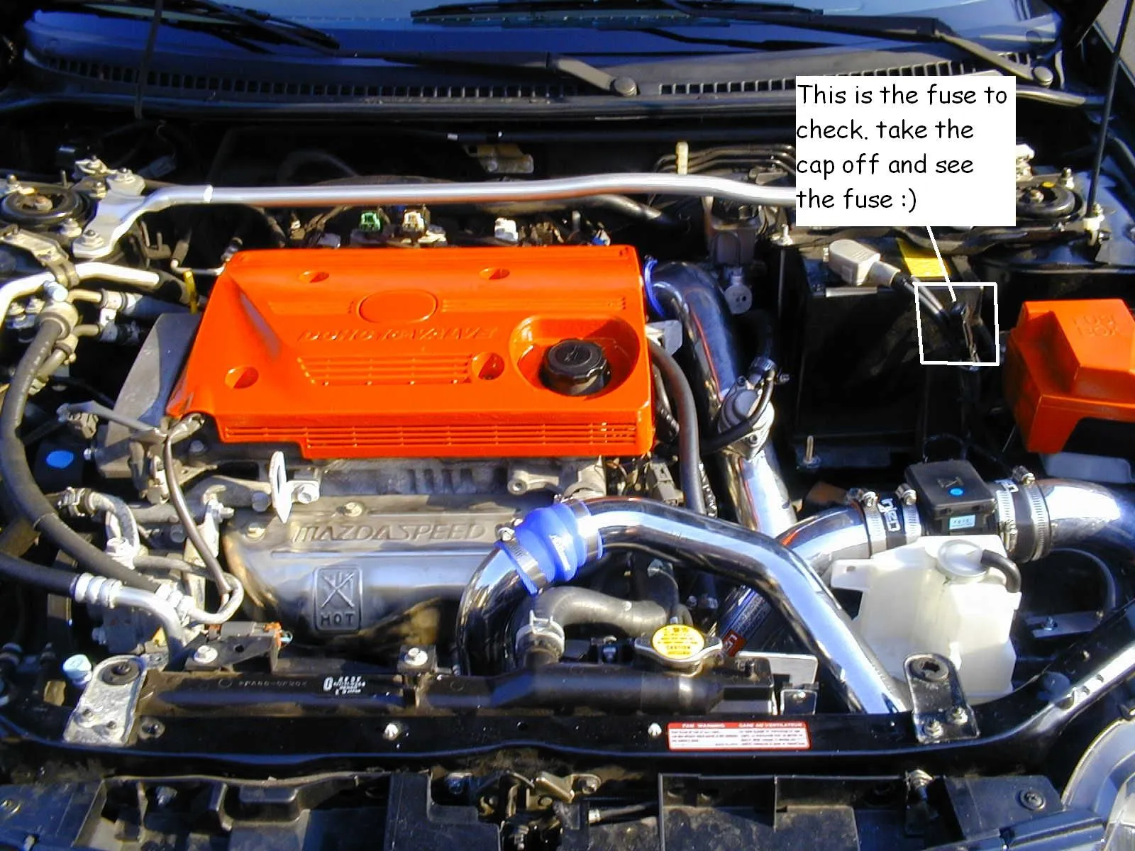

yeahhh but i dont udnerstand why its nto working i have everything hooked up i have a pioneer headunit and it is powered on for a sub and the amp light is on and the fuse is fine (dont kno what fuse to look at if under the hood) and all cables are conencted im just getting nothing out of the sub at all
The fuse is under the hood, follow the wires off the positive terminal on your battery and you'll quickly run in to the subwoofer power wire fuse.
mspaint ftw
i just went outside and look and the positive cable or + is running from the battery right to the fuse box connected to a fuse that is 100A and i dunno that is and the negative runs to god knows where
yeahhh its fine nothing wrong with it anything else i should check i just dont get it if it was blown then it would have something coming out of it
