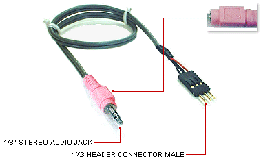

I have made adapters to retain both of these with my aftermarket head unit. See more at: http://www.mazdas247.com/forum/show...-(AX-MAZUSB)&p=6296531&viewfull=1#post6296531 (Sorry, not much there on the Aux retention adapter, but that bit IS quite easy - just strip one end of an audio jack wire and solder to a 3-way female PC header strip.)

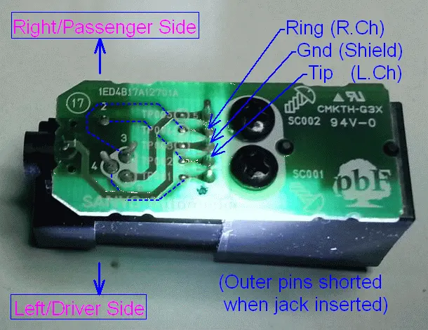

Still trying to find an easy adapter for the Aux line to convert it to an 1/8 headphone jack.
Updates:
You need something like this, but with a female header (not male as pictured). I just soldered up my own.
Can't remember if I posted this before or not, but this is the console adapter pinout:
attachment.php
