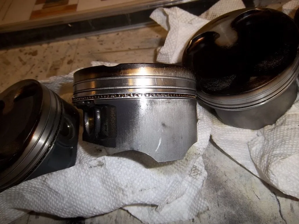

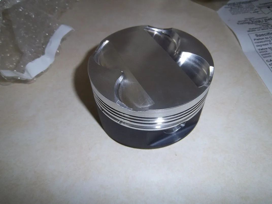

So this time I brought it to a local shop and so far this guy asks me more questions then I ask of him. But after finding the specs for piston to wall clearance for the guy he told me it was at .015. The stock specs stated that it should be .016-.02. I also have the pistons coated so the old shop should have added room for that, and the fact that I only race this motor so more room should have been added for that as well. They did not. Piston rings and the pistons got hot and squeezed and tore up the walls. Also the cold start to no start were due to the rings being smashed inside the ring lands and not springing back out and keeping compression. That also killed the combustion when it was running (racing) and unburned fuel started to stack up and "washed" down the cylinder walls and pistons.
Good news is I found the problem, bad news is its expensive. I am glad its not the wiring, or anything I did like the piston rings or motor build up (unless you count checking wall clearance after you just paid a shop to do it for you). But the new shop says he will not press in pins into new oem pistons. He is making me get aftermarket pistons that are "floaters", and he will make the oem rods work with them. Fine. However no one makes a high compression 83.5 piston. Its all 8.5-1 for turbo applications. So I will have to get custom made pistons, not that big of a deal except that lead time is 3-4 weeks. This season is looking worse than last years.

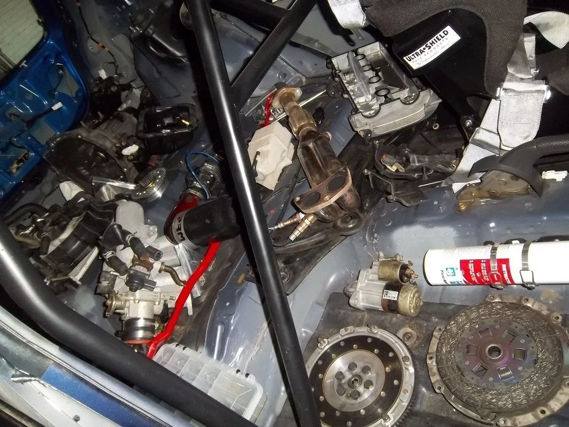

and the truck gets some lovin while I am waiting on the car too.
attachment.php

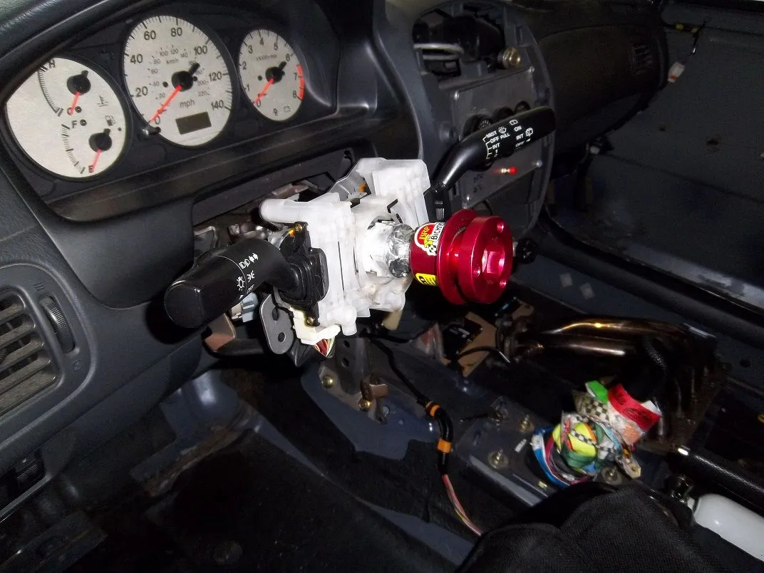

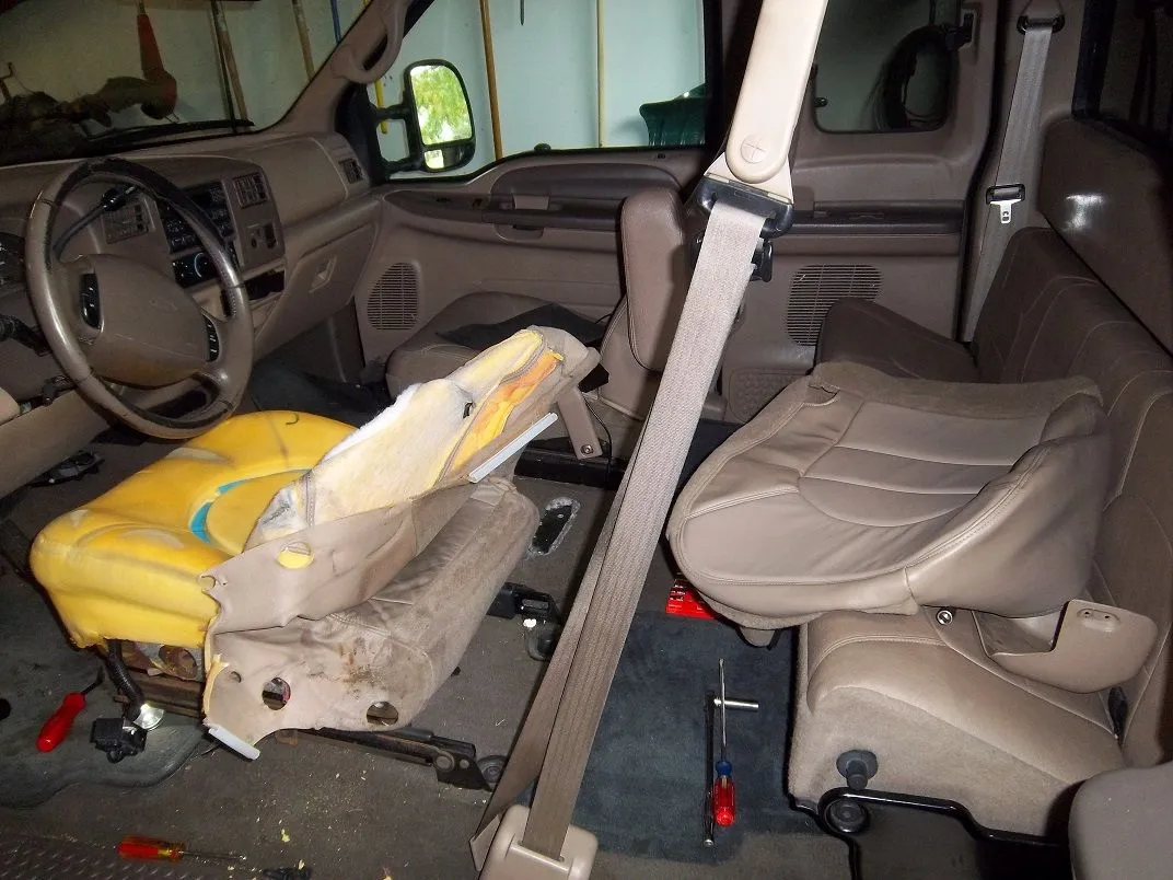

Got too fat over the winter to get into the seat. Soo I welded on one of these things on.
attachment.php

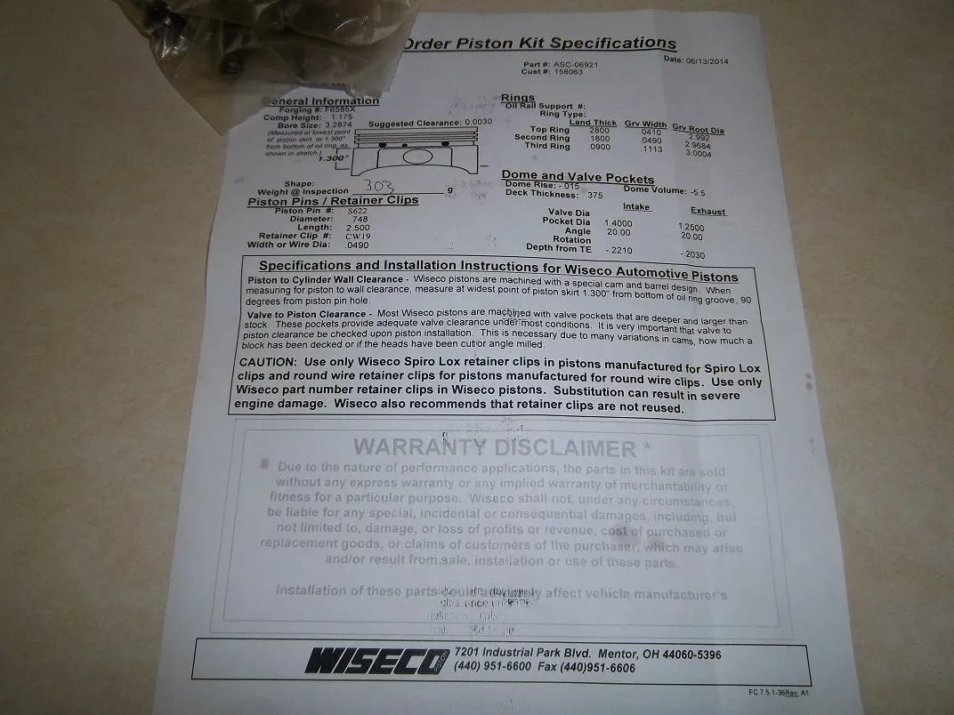

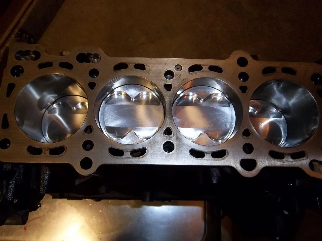

Also like I stated before the aes shop bored the motor to .0015. The stock daily driver should be .0016-.002. Weiseco states .003 piston to wall clearance. Man just one little simple thing I should have researched more, and I would be running around like a champ the first time. I think the new engine shop guy might even throw one more thousandths on it too. Mazda states that the maximum wall clearance is .006.

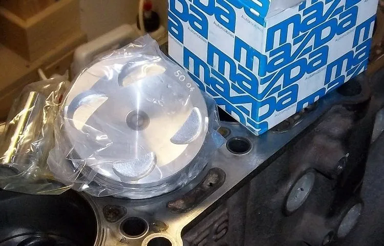

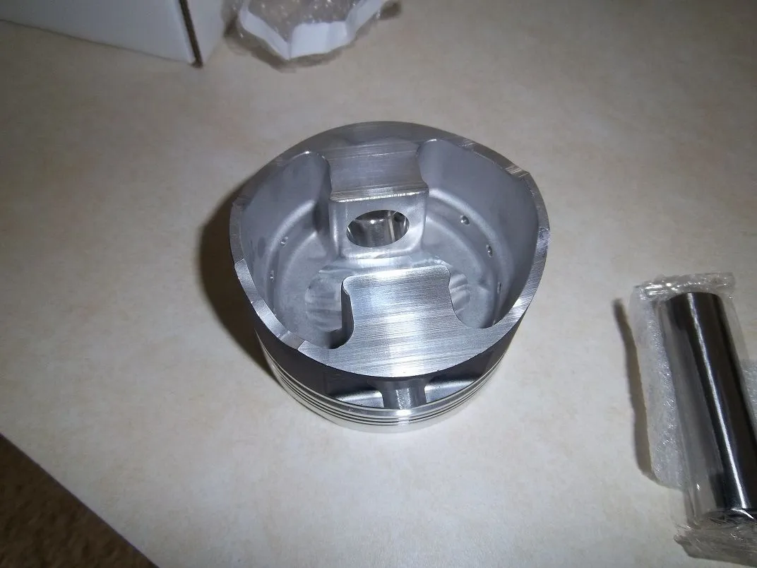

Not sure. I asked for stock FS 83.5mm pistons, but for 10.5 to 11 C/R. She said which side to be closer to, and I said closer to 11.
If you know how to get that # please let me know. Looking at how high the middle is it looks like its going to be like 13 or something, but the valve pockets are too huge for that! I am hoping that the motor is no longer "self destruction". But in one day the block is ready. A far far cry from 5 months. So this weekend I shall be re rebuilding the motor, and will see the clearances myself.
