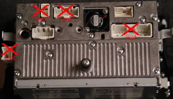

Little help please...I've attached a picture of the back of the navigation head unit. For those who have successfully hooked up the Neo ipod adapter, which unused connection on the back did you plug their cable into...the one on the left next to the antenna port or the one on the right?
Thanks.

Which Port
Although I had me installed by a pro, I would think since they are different sizes it will only fit into one of the two, I am going with the one on the right since its behind the Sat switch on the face......
good luck
good luck
Actually the radio is pulled straight out and turned upside down so the SAT button is actually on the left side by the antena port and the MEDIA button is on the right side. Thanks for your input. Hopefully someone who self-installed successfully can give me a definitve answer.
